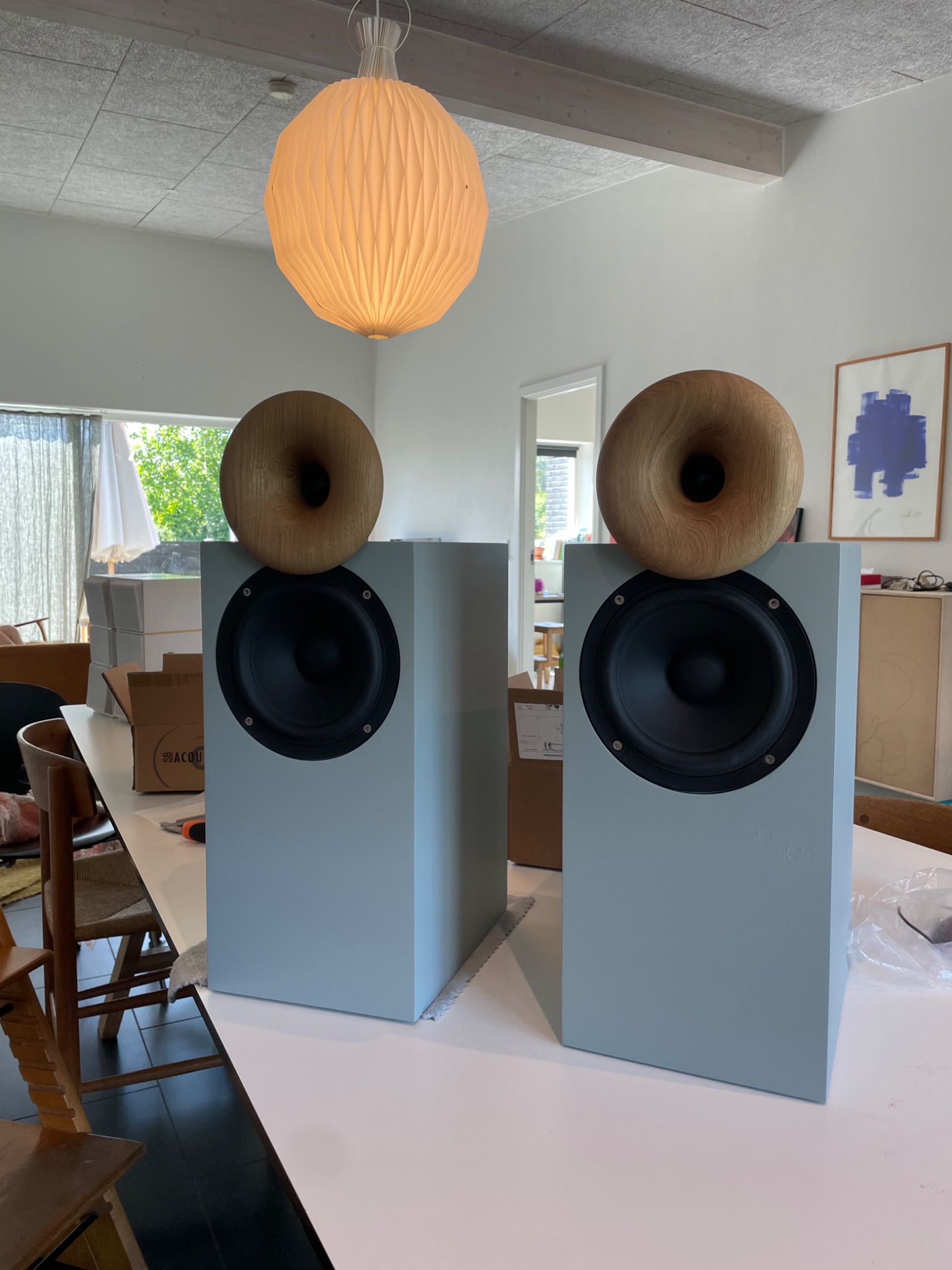

Hi everyone
This is my first post.
I have done a couple of speakers designed by others.
Now i decided to build my own 2way from scratch.
Drivers:
https://www.sbaudience.com/index.php/products/woofers/bianco-12mw200/
https://www.sbaudience.com/index.php/products/compression-drivers/rosso-65cdn-t/
The CD is to be mounted on a Yuichi 480 (ø35)
Crossover point is not decided yet, but around 600-1000hz
And here is my question:
Will it make sense to build a backloaded horn cabinet for the woofer, and is it even suitable for backloading?
I hope the woofer Will hit 35hz at F8 in vented cab, so thats fine for me.
Maybe the BLH could bring the woofer closer to the CD in sensitivity.
Thanks in advance!

Thank you everyone for your inputs! I know nothing is simple, but i guess your answer opened my mind to a more theoretical world. Im still a novice in speaker building, and this maybe to advanced for me for now 😄 And my wife isn’t happy with 200litre speakers in the livingroom, yet!

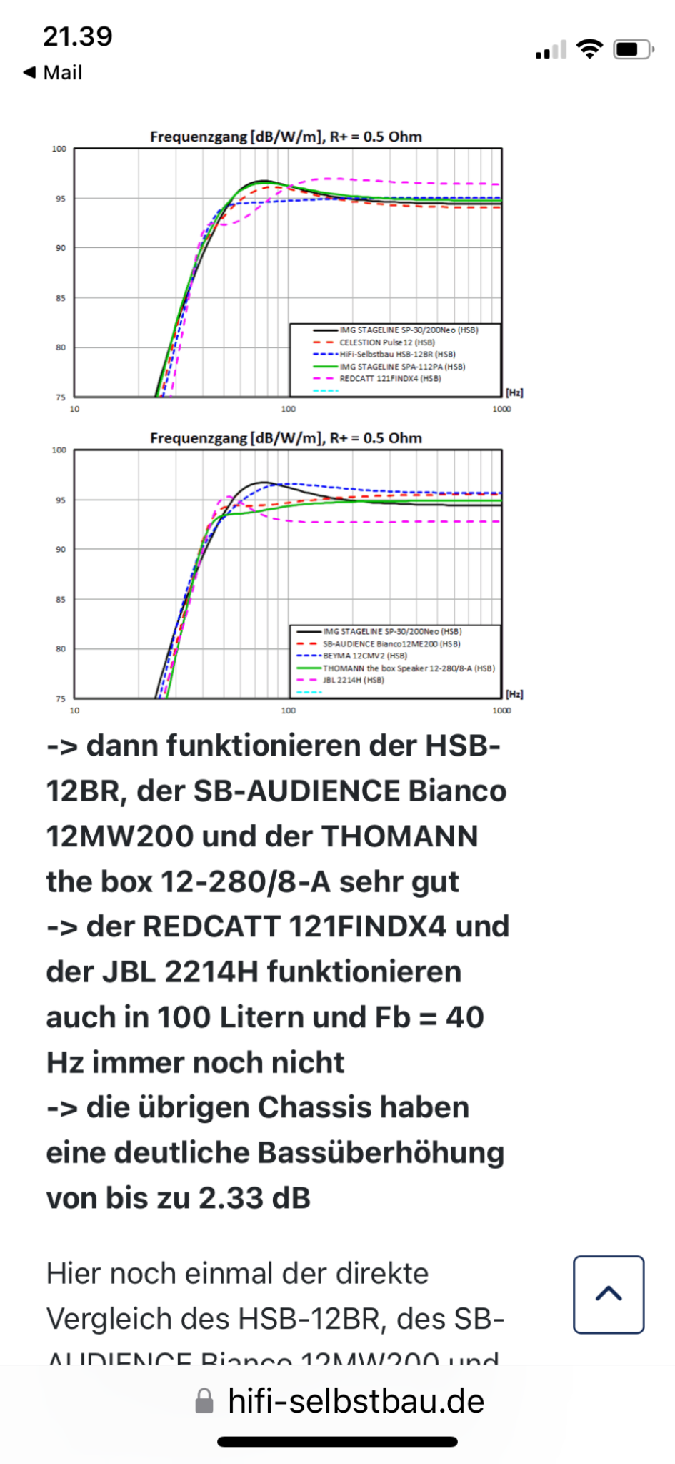

With the BIANCO-12MW200 mid-woofer's Fs of 51 Hz, 35Hz will be more than 8dB down in a vented cabinet.The CD is to be mounted on a Yuichi 480 (ø35)

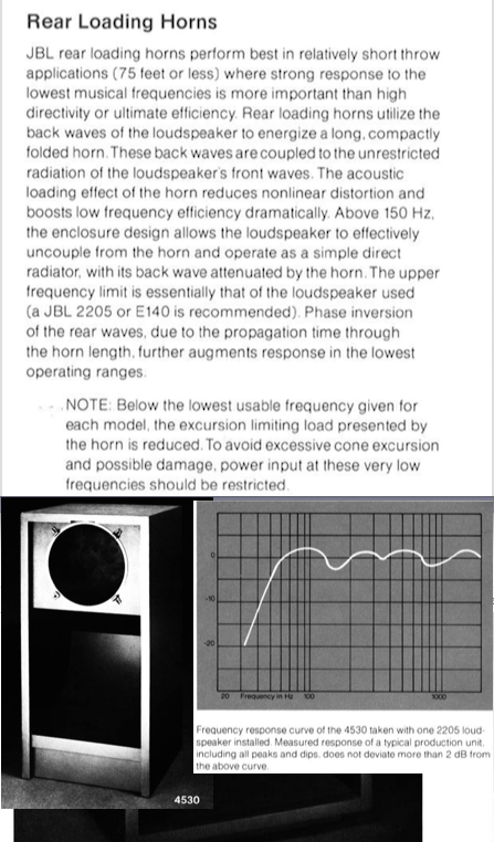

It could work in a back loaded horn, but would need to be huge to reach 35Hz.
A back (rear) loaded horn won't increase the upper sensitivity of the woofer, which averages around 98dB from 100-1000Hz, while the HF is ~110 dB or more.Maybe the BLH could bring the woofer closer to the CD in sensitivity.
Back loaded horns also have a low mid path-length cancellation that reduces sensitivity below that of a direct radiator, as seen in the -5dB response dip from ~150-200Hz in the JBL 4530 "Scoop", which drops off at 24dB per octave below 60Hz.
The 4530 is 1213mm tall x 603mm wide x 603mm deep (47" x 23"x 23"), around 407 liters (14.4 cubic feet).
Forget rear loaded horns...And my wife isn’t happy with 200litre speakers in the livingroom, yet!

Maybe thats right. But Hi-fi-Selbstbau made this comparrison. I looks like the low is closer to 40 than 35hz.With the BIANCO-12MW200 mid-woofer's Fs of 51 Hz, 35Hz will be more than 8dB down in a vented cabinet.

Room effects could increase or decrease level at various frequencies compared to the simulation.I looks like the low is closer to 40 than 35hz.
The simulation of the BIANCO-12MW200 (Vas 62.9L) in an oversize 100liter with a 40Hz Fb (box tuning) appears to show 90dB at 40 Hz, 9 dB down from it's 99dB sensitivity at 500Hz.
The low end would sound less than half as loud as the mid range.
Lower the Fb to 35Hz, and the low end would would drop another 3-5dB.

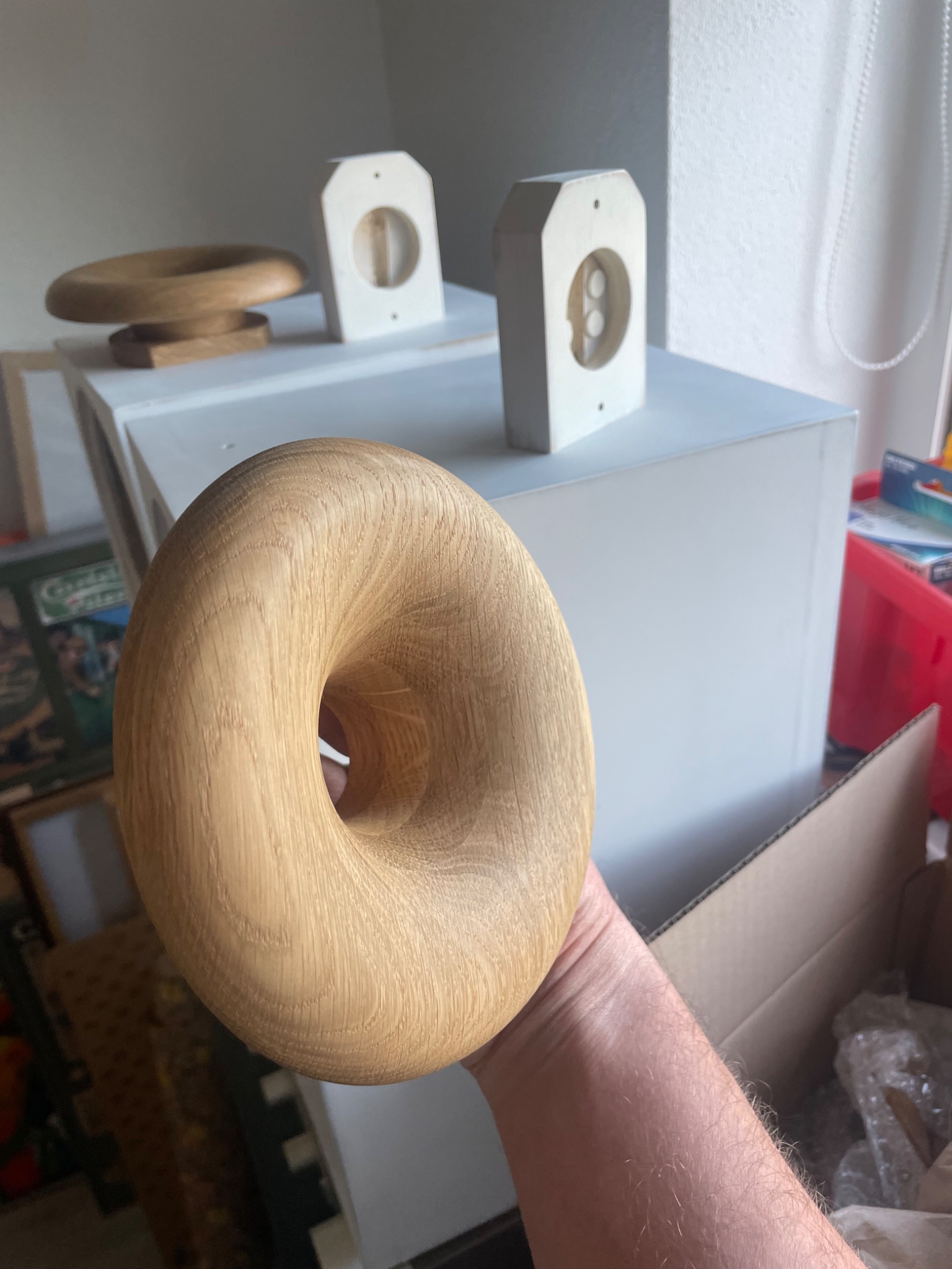

I build these last vinter, a Joseph Crowe No.2037. Really pleasant sounding and so detailed with the oak horn, but 90db (4ohms) So not a good match with my 12w kt88 SE amp.

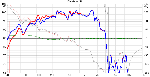

The thing droops so much down low that, unless you can go big-big (closer to 400L than 200L), I think you just either keep a "normal" (~125L) reflex box with a wide baffle by a wall or you commit to a corner placement and just put it in an Aristocrat as the best compromise.
If you just take an IEC baffle off of it, it's about thus-ish:
Is that a trace of the graph at Beorne’s link? Remeber,it ison an IEC baffle which will have a baffle width based roll-off, not necessarily the drivers. But some sort of EQ can be really useful when the room starts to weigh in.

He does a pretty good job, those horns look fantastic. How low do they go? You make them?
