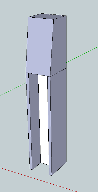

Hi all. I'm thinking about building SB Ara 2-way kit. I'd like the speakers to sit closer to wall (space constraint) so what I plan to do is reposition the reflex tube as down-firing.
SB Acoustics :: Ara - Satori Kit
Then I'll make the cabinet as pseudo floorstanding about 85cm top to bottom, each speaker would have cabinet wall extension on left, right, and rear acting as feet.
I'd like to know what you think about this concept, pro and con, any advice would be appreciated.

I'm not sure I understand correctly what you are thinking of doing.Then I'll make the cabinet as pseudo floorstanding about 85cm top to bottom, each speaker would have cabinet wall extension on left, right, and rear acting as feet.
In general, converting a stand-mounted speaker to a floorstanding version is easily accomplished in extending the baffle down and keeping the drivers in the exact position with respect to the top and lateral part of the baffle. The reason is that in this case you won't change the diffraction and baffle step effect of the speaker that should have been taken into consideration in the crossover design. If you do so then you have all the space you need for placing the reflex tube on the baffle under the woofer.
If you want to retain the original tuning while extending the baffle, you should maintain the internal volume decreasing the depth. BTW, from a quick calculation the ARA internal volume is some 16+L.
What I don't understand is what you intend with cabinet wall extension on left, right and rear. If you plan to make the baffle wider than the original, I strongly suggest not doing so, as it will alter the tonal balance of the speakers.
Ralf
@Ralf. Linesource describe what I have in mind. ARA is a bookshelf format but I don't want to use metal speaker stand. So I plan to extend the cabinet on left, right, and rear panel, functioning as stand, and make the reflex tube downfiring so speakers can be placed very close to wall.
But you bring to my attention whether I want to make the left and right wall extension follow the slanted baffle, or just straight.
OK, I understood what you meant. I suggest you to build it like the image attached, don't make a slanted rear as it has no practical effects, you only have to reverse calculate the depth based on the internal volume.
In this case a bottom firing port works perfectly, pay only attention that it doesn't interfere with the internal brace.

Hi Ralf, much appreciate your illustration. My apology for very late reply, life at work has been hellish.
I like your idea of bottom firing port as the speaker can be placed closer to wall. Space is rather limited here.
