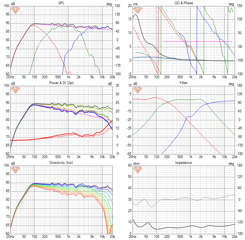

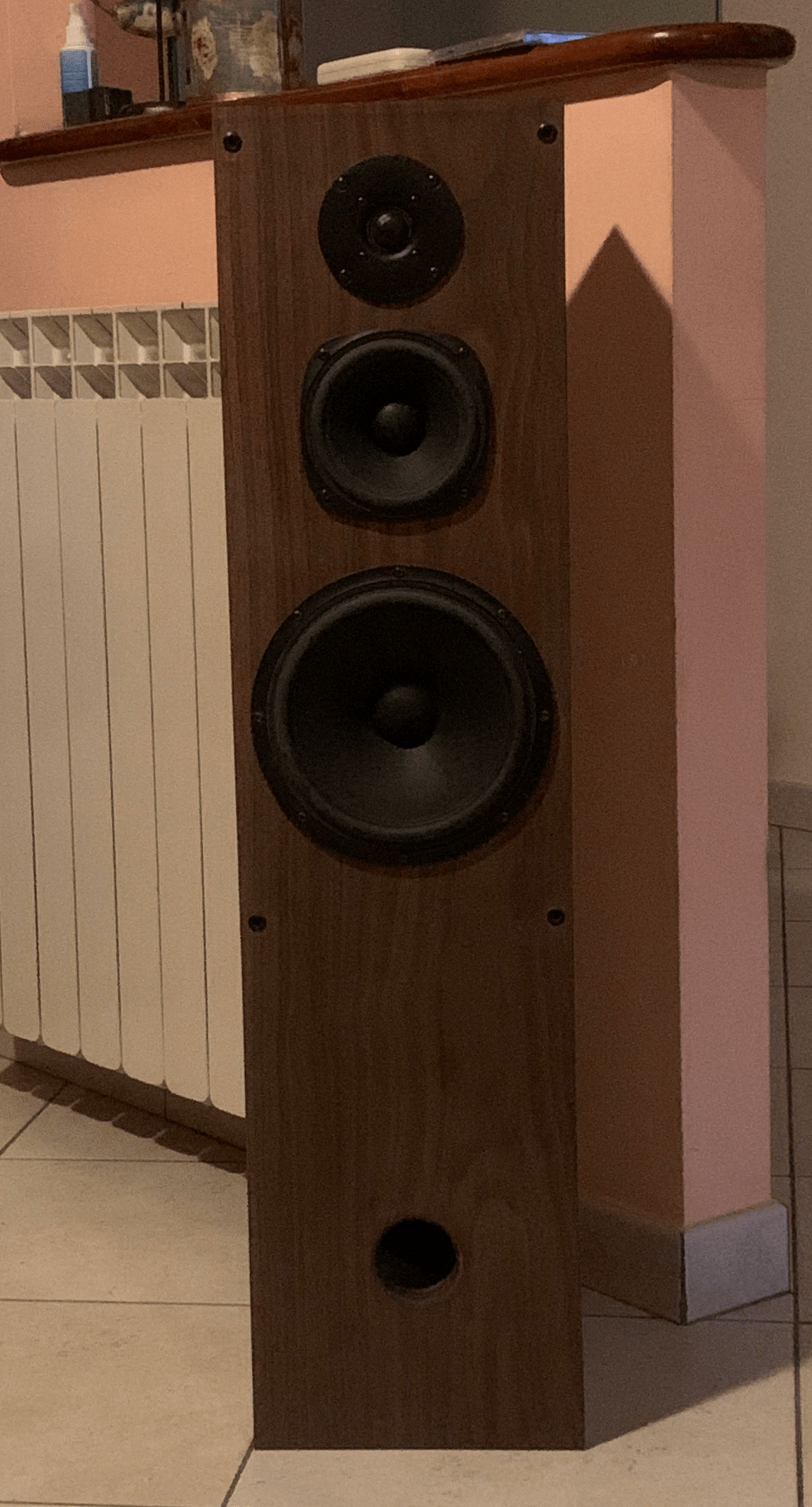

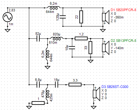

I developed the simulation of a floorstander with SBA speakers for a friend of mine last winter. I have to say that my friends lives 1000 Km far away from my city and so I never had the possibility to carry out any measurements of the speakers and everything is based on the traced curves of the manufacturer.
Anyway, now the system has been completed and my friend is very satisfied.
The system is 3-way (8-5-1), the baffle is 25x97 cm and is a 40L bass reflex tuned at 38Hz. It is based on the PFCR line of SBA because the budget was under 500 € for speakers and filters components.
If you need more info feel free to ask.
