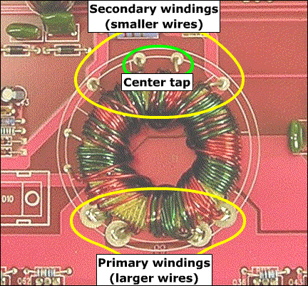

I did. it was bouncing around, from the outside jacket of the female RCA to the two middle pins (not bridged), one at a time.
For virtually all of the Orion amps, the RCA shield is directly connected to the secondary center tap which is directly connected to the non-bridging speaker terminals. You appear to have an open ground.
What's the resistance from the non-bridging terminals to the main B+ terminal on the amp?
So just to clarify , the rca shield is the out side of the barrel. I know this is stupid I just want to make sure I am on the same page with you.
And the secondary center tap, must be a leg running inside the circuit board?
