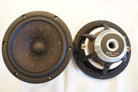

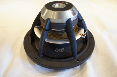

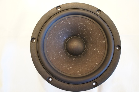

Satori MW16P-4
I bought a pair of these very nice drivers! 😛
attachment.php
Some initial measurements can be found here:
New Satori MW16P-4 driver units!
The question is what to pair them with? 🙂
I have a couple of ScanSpeak drivers I haven't tried yet and I might even do a wave-guide design this time, depending on how my test measurements evolves.
Over & out
/Göran

These should work very well with a waveguide. What with them having a smooth and extended response and low upper range distortion, could easily cross 2nd order around 2.5kHz for a good directivity match to a similar sized waveguide.
It will be interesting to see your distortion measurements and how well they compare with the other drive units you've already measured. Joachim's first measurements at the lower level showed higher overall 3rd harmonic then when they were driven at a higher level. This I would expect to see if the signal to noise level wasn't optimally arranged for the lower level distortion plots, it could be driver based but I'd be surprised. As you measure at different drive levels it should show exactly what's going on.
