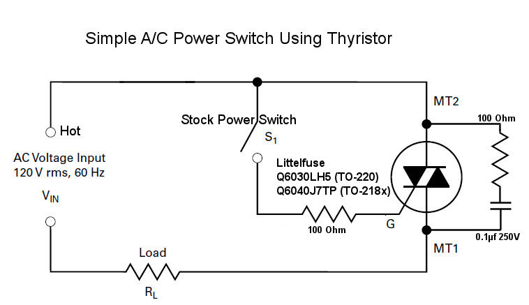

Maybe a triac controlled by the switch, as discussed here: Is your unoptainium power switch worth $5 and an hour or so of your time? - AudioKarma.org Home Audio Stereo Discussion Forums

we change the switch with ones for Sony CRT tv we have plenty new screws knob fit exactly feeling is the same bit heavier and the small pcb inside we remove totally We have been doing so for more than 30 p55 amplifiers with no problems ...
Things you write about the Finns i don't bother to consider, i expect second thoughts when they find their P55 burned beyond repair ( outputs are almost no where to be found in a reasonable cost and original condition ) after a good switch spark ...
