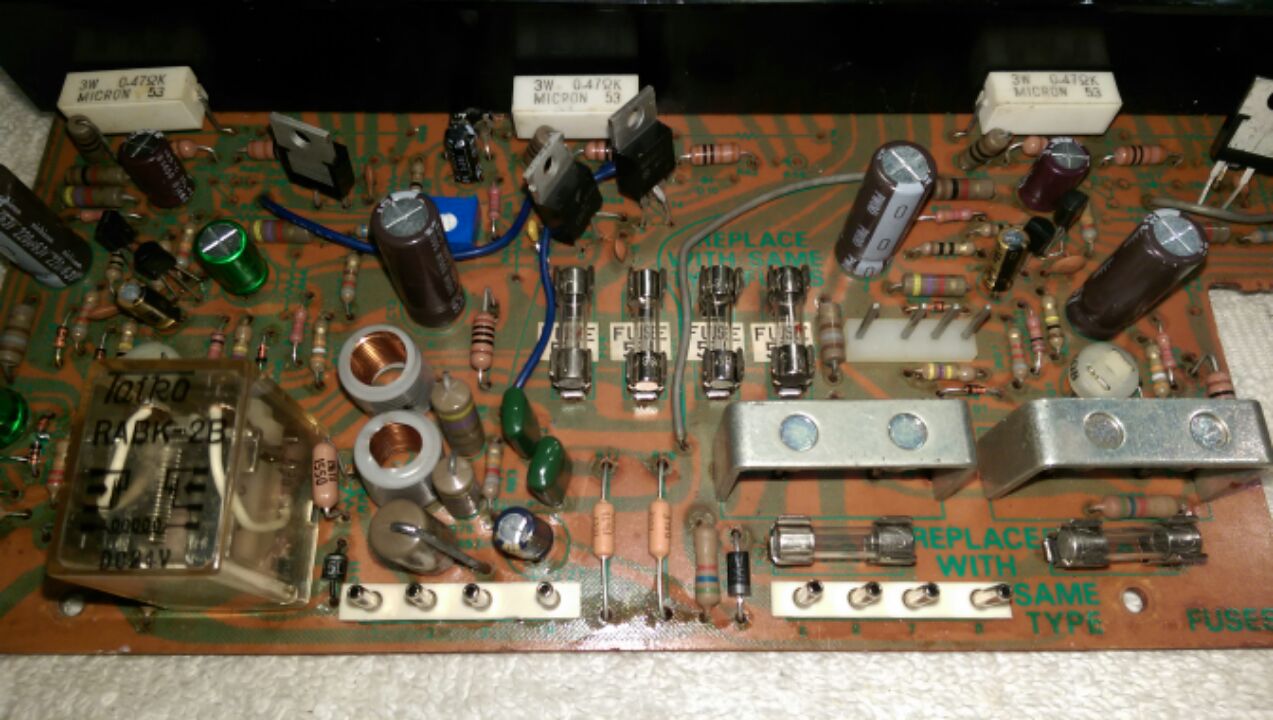

I could use some advice on this one. I have everything up and running, recapped pretty well shotgunned the driver board.. replaced VR03,04 with new bourns 1Kohm trimmers. I can get offset down to .001vdc but if I turn the pots for the bias all the way CW and bring up the current as soon as it hit's about 10ma it jumps up to the 300-400ma range and I can't get it to come back down until I turn the unit off and back on... I have been over and over it and can't seem to discern the problem. I am using KSC1845's for the bias transistors... could that be a problem... I know when I pulled the old ones they were not 2SC733 as per the service manual...

I have made a lot of changes, all using recommended replacements I had found in my research, mainly on here or audiokarma.
It had blown fuses and outputs. Replaced outputs with MJ21193/94's, Drivers with MJE15030/31's. TR05/06 with KSC2073's and TR01-04 with KSA992's. Replaced some resistors that looked iffy with new metal film types.
Did you match the differential pairs? They must be matched closely. Changing the outputs and drivers probably forces you to work out the compensation again.

Did you keep all the original components? if so, put them all in a bag and take the amplifier to a decent technician. It may need to be rebuilt, repaired and then possibly upgraded. Fix the faults before wholesale replacements next time. You say it had blown fuses and outputs. All 4 output transistors- and the drivers? Are the 0.47ohm emitter resistors still good as they often go when you latch-on and kill an output stage?
If the original semis test ok up to the output stage, I'd be rematching the two differential front end trs and re-installing them.
Thanks, it seems I'm the only one in these parts that will touch anything this old. Everyone here only does warranty service on new stuff.
I matched the differential pairs.. and think I have found the problem. Had to make a parts order... I took the drivers out and found two bad MJ15030's that I probably took out when I had the bias transistors in backwards...
The Hfe on them was way low..

Fair enough, it seems it was a mess created by a previous ham-fisted 'tech'.
Use a DBT (dim bulb tester) after the rebuild or use 4 old M205 fuses that are blown and solder 10ohm 1/4 watt resistors over them, then install in the 4x amplifier rail fuse holders. If there is a fault after the rebuild, they will sacrifice themselves and save the drivers/outputs. If it works ok, pull the 10ohm resistors out, replace the fuses and set the bias.
I don't like Sansui's directions to pull a single rail fuse and measure the bias current using an inline DMM or milli amp meter. It's plain stupid, because if your probes slip contact or there is a fault, the amp will latch up and/or trip the DC protector and/or blow itself up and likely take out the low value protection fuse on your DMM for the mA ranges.
Go the tried and true method of measuring the calculated voltage drop you require over the emitter resistor on the outputs.

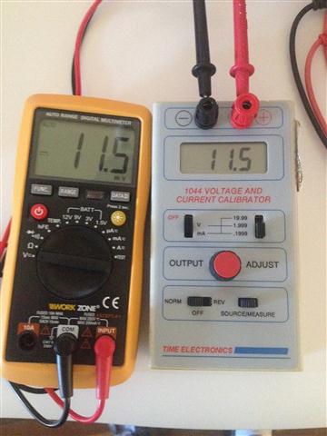

Here's a cheap, $20 at Aldi meter. More than good enough for setting the bias current. This meter was very accurate on the DC ranges.
Even on AC, it was accurate to 3kHz. Amazing for the price.
Dropped over the 0.47ohm emitter resistors in the AU-6600, you'd want 11.7mV. There is a range Sansui quote that corresponds to 7mV to 16.5mV, so it's not at all critical.

The 1044 calibration unit I use and keep here is a 0.05% guaranteed accuracy and does not drift. It wasn't cheap, but wasn't expensive either, and it is an incredibly useful little unit. It is an extremely useful reference to check multiple meters. I can confirm basic DC and DC current accuracy of any multimeter, DVM panel meter in situ or in a remote location ie, it is very portable. That has its advantages.
At 0.05% it is the same basic accuracy as my bench meters and the better Flukes I use. I am a sucker for DMMs and have had perhaps 40 over the years, ranging from nixie-tube vintage units to all type of newer ones. With that single calibrator, I know which ones are accurate. It's always useful to check them after an 'event' (you know what I mean)
My points are these:
1:Cheap DMMs are more than good enough for setting the bias. I use more expensive meters as you no doubt do- because I can, but the OP does not need one to measure an 11.7mV drop over a 0.47ohm resistor- any meter will do that well enough.
2:Measuring current on the mA setting across fuse clips (as per Sansui's AU-6600 S/M) in a possibly unstable amplifier is unwise. I'm sure you'd agree with that too. The low current ranges on DMMs are usually only protected by some oddball value fuse and nobody needs to kill their meter.
