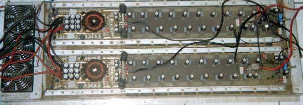

I am now going to build a caramplifier, but the schematics I found consists of the 2SC2922 and 2SA1216 Transistor. I don't now where to get them, so is there any other transistors I can use instead?

This is a very powerfull sub-amplifier. It should be capable of 900w RMS into 2ohm's.

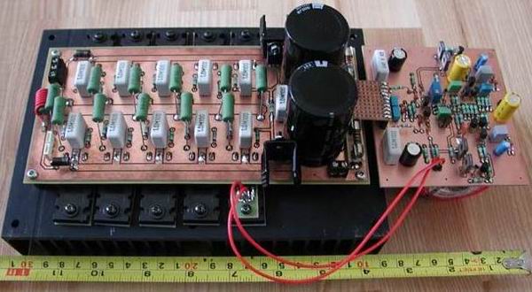

Hi
It's really no problem to make double sided PCB's yourself.
Just get some doublesided photopcb (From farnell) and make two prints on transparent "paper" (Top and Bottom) on a laserprinter.
Make an L shape from something 1.6 mm thick, and alaign the prints on top of eachother. Stick the prints on the L shape on each side of the L, an place the PCB in the corner, (Make sure it's inn the corner) Light one side.
Turn PCB over and light the other side.
Develop the PCB's and each them
Drill and solder

Large boards
Well actually to make prints, the best results that amateurs get are from transparent film from inkjet printers.
Thus if you can get continous special inkjet transparency, you can do it with an inkjet. The only problem is that you will likely get matching issues from start side to end side at such long lengths.
Plotters can also work
You should also be able to merge two films together and touch up the resulting films.
Any pro shop can make prints that size, just be prepared to pay as it will unlikely be cheap unless you become friends with someone in the pcb shop.

www.profusion.com sis have the 2SC5200 but not the 2SA1934. Does andony know where they sell this transistor?
Jens: The picture is the amplifier (2 channels) 94 x 32 cm
