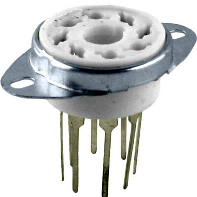

Hi just to ask a question.
If i will take the signal out directly from the cathode pins on the 1st tube will it act as a buffer ?
i intend to insert and use only the 1st tube and take out everything else I will leave it even without volume control. Just a plain buffer as i not need voltage gain at all.
I guess i will have to add just two output 4uF caps soldered on the cathode pins of the 1st tube to block DC on one side and going to the output RCAs on the other side. I do I just need a buffer able to drive 10k Zin power amps.
In this way i would avoid some issues found with the original design.
I also intend to use long pins tube sockets to make things easier
Thanks a lot
Thanks a lot

Hi ! thanks a lot for the very kind and valuable advice. So any tube in a decent design could work as a buffere if i take the signal out of its cathode ? i am not an expert and this i need to be sure of.
Then i would like to find some tube sockets with longer pins ... that could help with in-air wiring ... to solder parts to the pin i mean. I am quite excited by this project.
I like what one tubes can provide in a all solid state chain. I was thinking also to a dac with tubes at the output as an alternative. Different approach. But just one tube on the signal path can do wonder to the sound.
I am sure of this.
Thanks again and kind regards, gino
