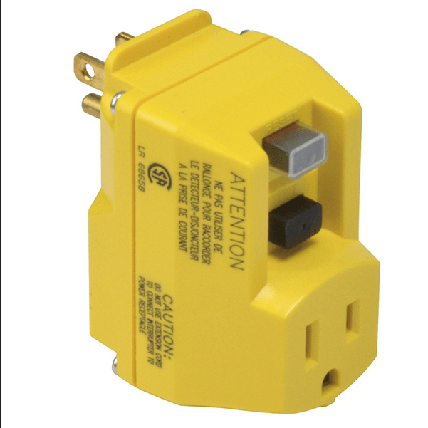

Use a GFI protected AC outlet to power the transformers, etc. during development.

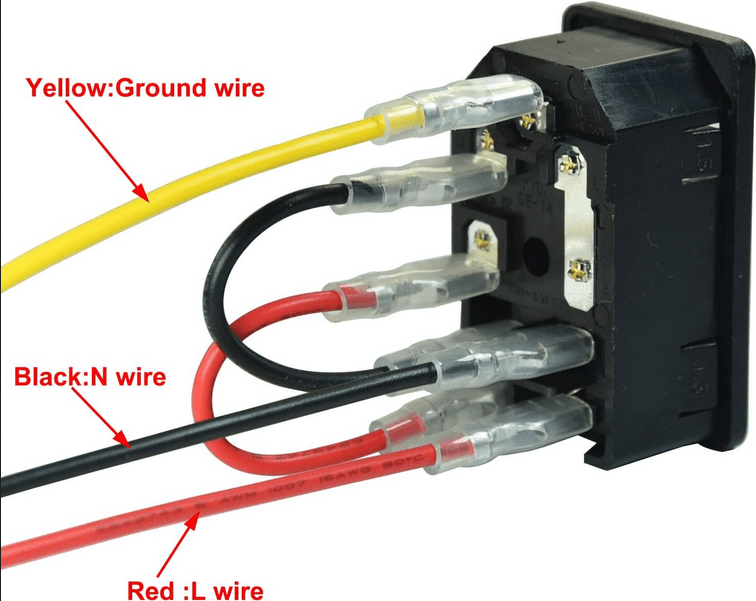

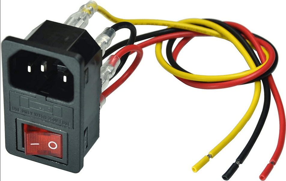

My suggestion is connect the transformers to AC mains via a IEC socket that comes with fuse and power switch.
It minimize the chances of error, just connect the L and N wire to transformer primary winding, ground wire connected to the metal chassis.

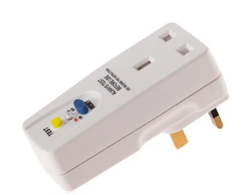

If you do a lot of mains work buy a plug in ELCB "earth leakage circuit breaker" to stop it killing you.
You can buy them for garden equipment.
When powered on dont touch anything.
If you have to scope it then attach scope with power off, stand back and power on.
Make sure fuse is in the live phase.
a GFCI, RCD or ELCB will only protect a human when touching a Hot lead (or a chassis with a short) and a grounded object.
It will NOT protect when touching the Hot and Neutral leads of the same protected circuit.
