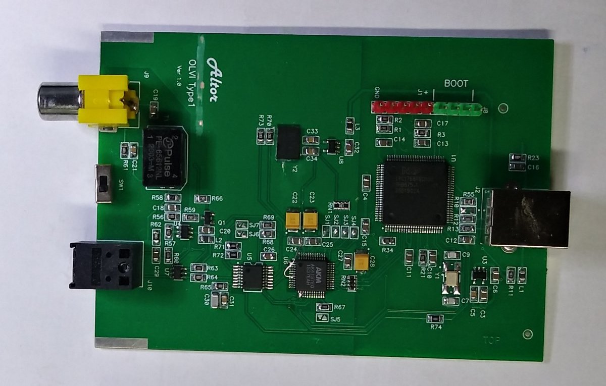

BTW, I found my old board. This was a prototype, so there are some wires on PCB, but works fine.
Board works in USB UAC1 mode (so, no driver required) in 24 bit 96 kHz format.
Mechanical switch between the 2 Inputs:
- Coax (transformer coupled)
- Optical.
Input may be up to 192/24, it is converted to 96/24 by ASRC AK4137.
Alex.
