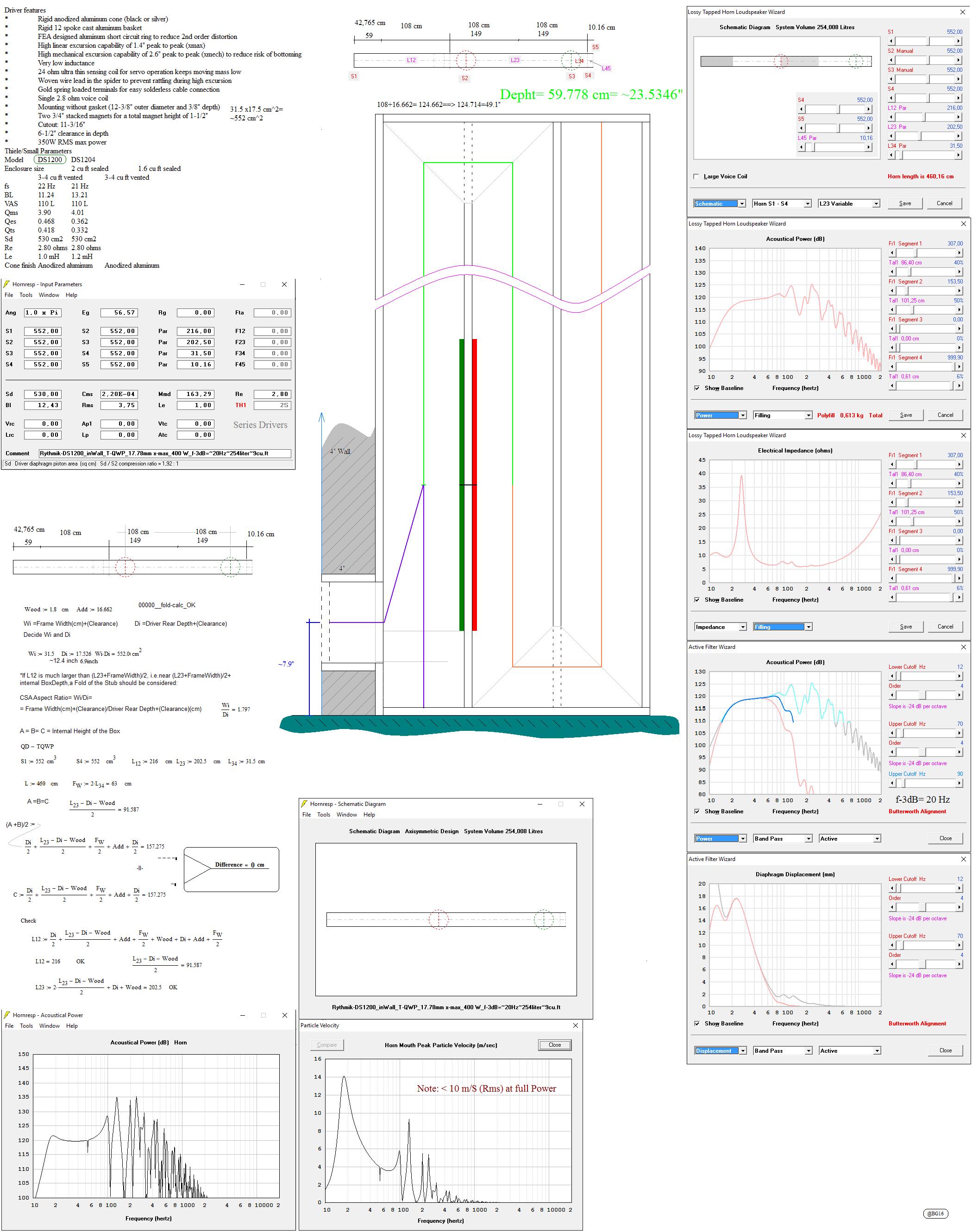

Hey guys looking for some help modeling or just general advice...
What I want to do is this:
From what I've read this slot loading configuration lowers the Fs and raises the Qts but I don't know how to model it? Particularity the extension part through the wall (mouth of a horn?)...
Drivers I'm thinking of using are dual Rythimk Audio DS1200's paired with their HX800XLR3 800 watt amp using DIY Sound Group's 2 cubic ft boxes (one for each sub) so height and width (from drawing) including the 4" extension through wall are fixed... what I can play with is the distance between the boxes (up to about 15" given 16" on center wall studs). While not shown on the drawing the three sides of the slot will of coarse be closed in with 3/4" MDF. That makes the inside dimensions of the slot 20" by 19" by ??.

My question is what the optimum distance between the boxes in order to get a good result? ... or maybe I should ask if it's a good idea in the first place?
(I know my Sketchup skills are lacking but I just started today) 😕
Any of you modelers out there willing to have a look? Will it work well or am I living a pipe dream?

Hmm, I can see it........how about now? https://dl.dropboxusercontent.com/u/17638515/Rythmik Dual Opposed Slot Loaded.jpg

Boxes are built and primed. I'll be cutting the pieces to form the slot next but I still haven't settled on the distance between the drivers? After reading the entire thread "for those interested in PPSL..." and doing other research I've concluded that there will be no real benefit to reverse mounting one of the drivers since these are servo subs and likely cancel enough even order harmonics anyway. Am I thinking about this right? dlk a special thanks for all you shared in that tread (even though I'm mostly just a lurker)! Incredibly helpful to get my head around it even though I'm still unsure of the optimum distance between the driver faces...
If you cover one speaker, you have a band pass. If you remove the cover, you still have a band pass.
Small narrow long slots have a strong (e.g. +10dB) resonance. This is fine if you only want to use the device as a subwoofer. The resonance frequency will more or less be the upper end of where you can use it.
You should get increased Q and lower Fs but you will probably also get decreased SPL (lower sensitivity).
I'm thinking 5 inches for my slot distance as I'm mostly interested in the mechanical vibration cancellation this configuration provides (mounted to wall in garage with slot exiting through wall to family room... master bed/bath above garage/family room). Rythmik proves damping and extension control on their amps so I should be able to tune this sub to my liking. I also use a Emotiva UMC-1 (Dirac) so I can further fine tune if need be.
