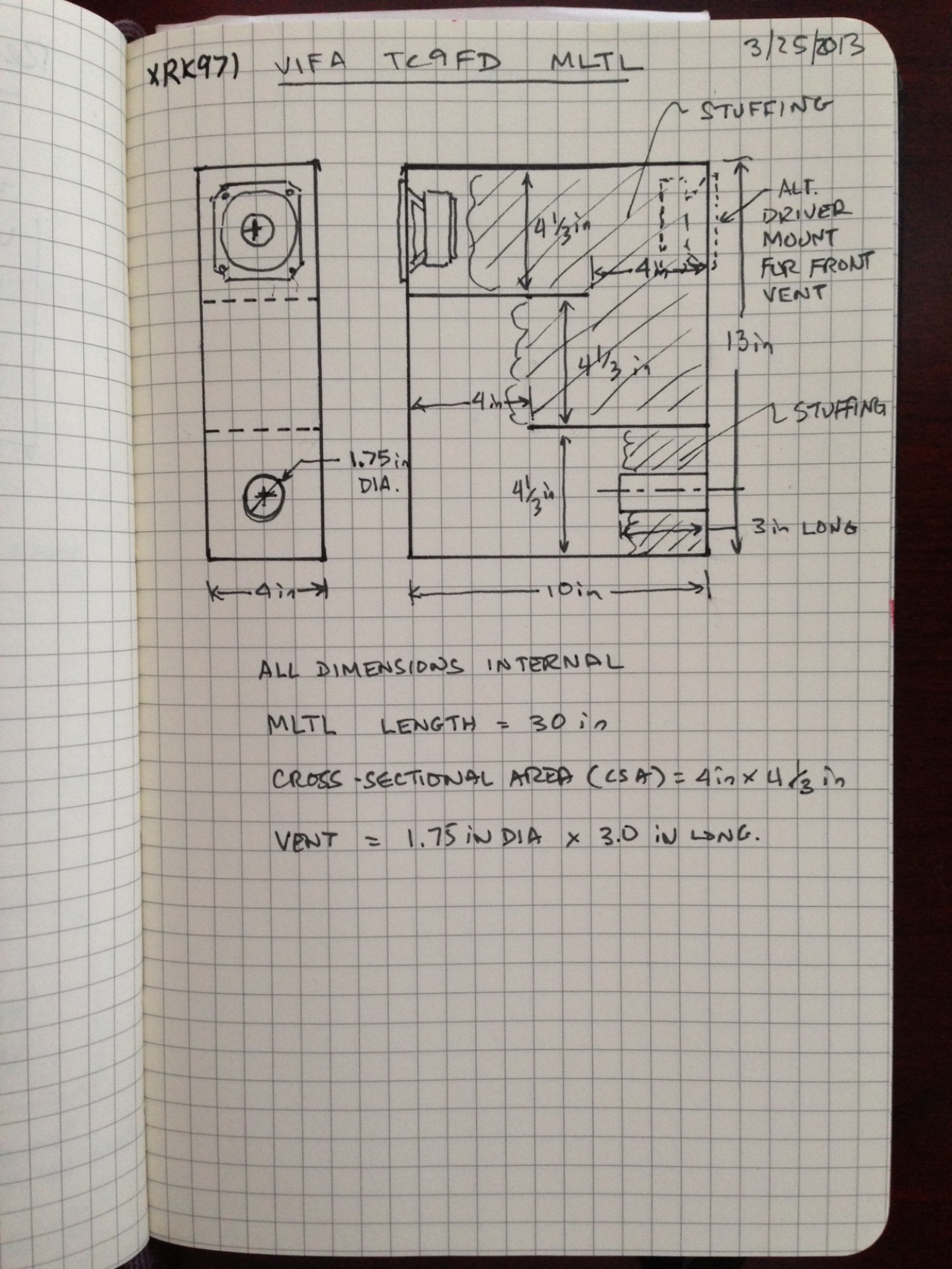

Interesting design, when I first saw the underside with the exposed port I thought to myself that looks an awful lot like a speaker I recently made where I used the paper tube from a roll of paper - and sure enough it looks like that is what they used: 1.75 in dia paper towel tube. The TDA8566 class A-B amp chip could be better, if I were to do it now, it would be a class D amp from Texas Instruments TPA3118D2 30 w/ch IC and no heat sink sticking out the back would even be needed. This RS100 seems to be getting postive reviews wherever I see people using it - looks like it might be worth trying out for various projects in the future. If you add some internal dividers, you can actually turn this into a small desktop MLTL and get some really nice bass. I did this with a Vifa TC9FD but could easily have done it with Dayton RS100.
