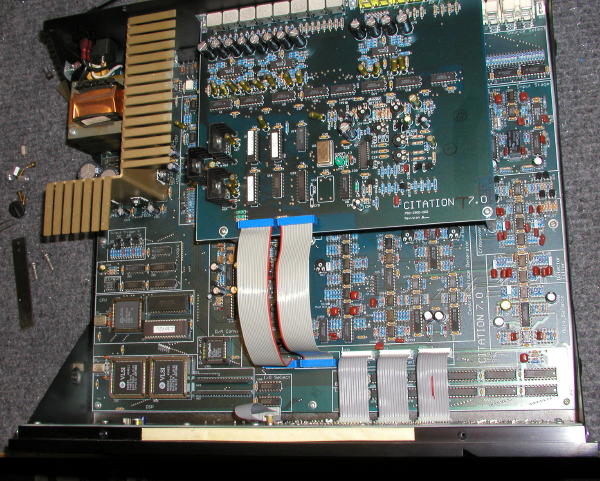

so i got a used Rotel RSP-966, which has been recently replaced by the 1066 (has newer formats like DTS EX and Pro Logic II but otherwise identical). like the denon, it has a direct 5.1 channel analog input which i use for multichannel SACD. i was hoping it would sound at least as good as or better than the analog section (volume control) of the Denon. well, it sounds pretty disappointing to say the least.
before i even listened to it, i popped the hood to see what's inside. i could only really see the power supply and main audio boards, but the main board had all sorts of digital and analog circuits mingled together - Crystal DSP, AKM DACs, cheap JRC opamps, all clumped together into a fairly small area. it appears to be only a 2 layer board and the ground planes aren't all that big. the 5.1 channel inputs have to pass through all kinds of crap before even getting near the output jacks, where there are electrolytic coupling caps, more cheap opamps, and solid state mutes. yuck.
and the sound... worse than my old Denon that i paid $150 for used! the Denon actually has a much nicer layout internally, although it doesn't have anywhere near the switching capability of the Rotel so it's a little easier. also, the control flexibility of the Rotel sucks - you need a TV monitor to adjust anything more than volume, and it does not memorize separate level settings for each input like my Denon did. and it has non-defeatable tone controls! agh!
anyway, i thought i got a good deal on this thing ($699 mint used) but it turned out to be a hunk of $%^@! it doesn't even sound good for movies! Dolby Digital sounds marginally better than the old Denon in some aspects, worse in others (the Denon has a smoother, fuller sound, though with less detail). and DTS was not much better either.

i never said anything about Rotel amps. they are above average. no need to defend your purchase here. however, this preamp sucks. there is no 2 ways about it. i'm not sure if it's reasonable to expect much more at this price but the design of this one is pretty poor, and it is reflected in the bad sound. that is why i was so disappointed, because i had expected a little more from Rotel. i would have thought they would at least match Denon. the comparison is not arbitrary at all as they are similar types of products of similar calibre; if anything, the rotel should have outdone the Denon.

Yes, death to tone controls. Interesting comment about how your preamp has lack luster performance for music but DTS is acceptable. I hate to point out the obvious but it seems the analogue section may be at fault or inferior as the case may be.
Crappy resistors, cheap caps, or the ADC itself? Are you using digital in from a CD source or Analogue? I find the power supplies in these low end units to be the biggets culprits myself. I will try to dig up schematics for my Amps.

when i refer to the Rotel as a preamp, it is when used in purely analog mode with the multichannel inputs. they pass through volume and tone controls and the output stages, but not an ADC or anything. (if the signal were converted to digital i would not bother holding any hope for signal fidelity.) there are problems too numerous to list, but for starters: crappy resistors/caps at the input stage, long wiring harness to the mixed signal board where there's digital and analog stuff strewn all over the place, long signal traces, most likely an IC volume control chip (don't know what type), more long traces, electronic switching, tone controls, lots of cheap opamps, electrolytic coupling caps, muting transistors, etc. etc. and yeah, the power supply is not so hot either. i'm hoping once i get a service manual i can figure out some points of improvement, though this one may be beyond tweaking.
i think the DTS suffers from the same problems as music; it has to because it passes through the same analog stages etc. however the decoding quality itself (purely digital) is better than i originally gave it credit for, and i like the AKM DACs used. movies tend to be a little more forgiving than music; the failings are just that much more obvious when using, say, my SACD source material through the analog inputs.
