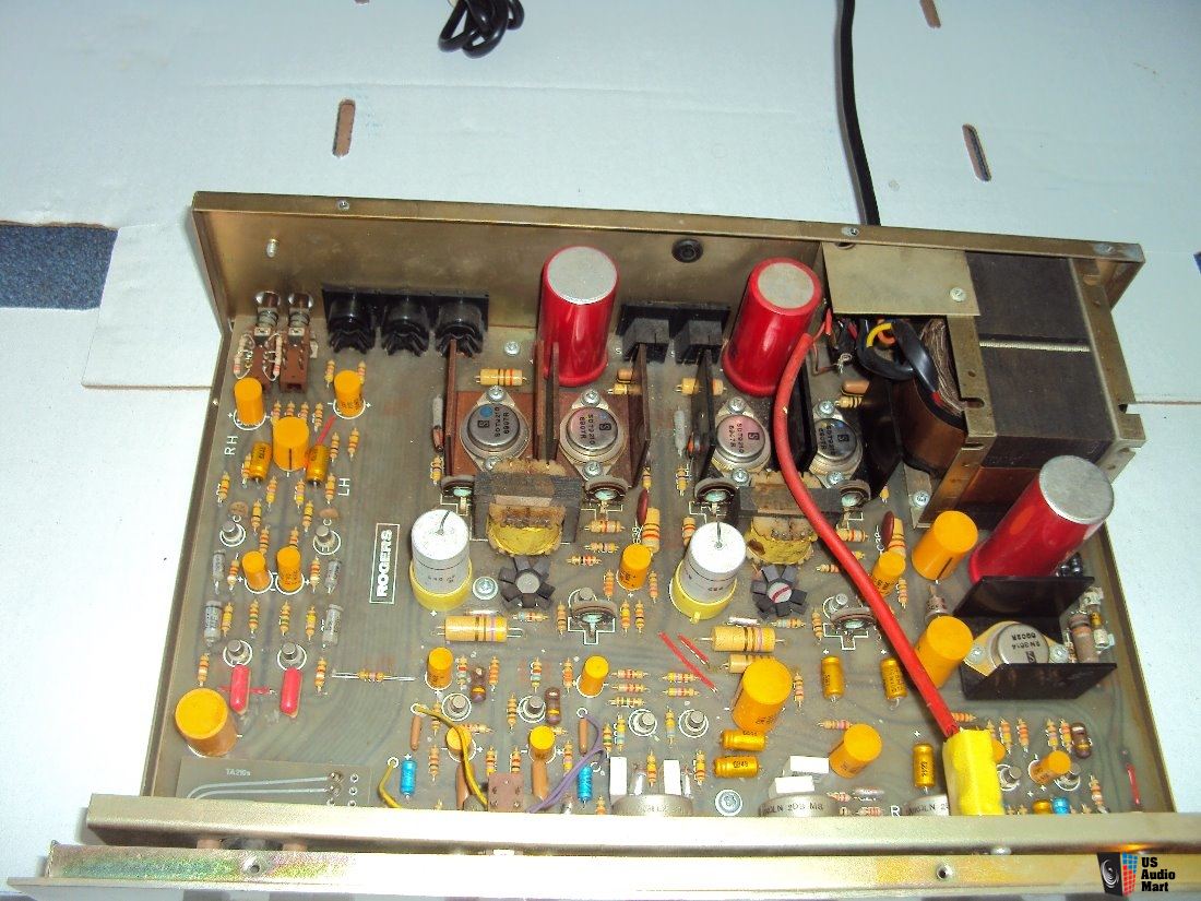

Hi, I have a rogers Ravensbrook stereo amp here with a blown SDT9201, farnel have the following replacements 2n5886G.
The issue is pre driver T7 is blown too, but I can not read the faded letters on it. Anyone have any idea what this transistor is, metal can type? I have some bd140 /139 which will probably do if I swap the legs in the right orientation

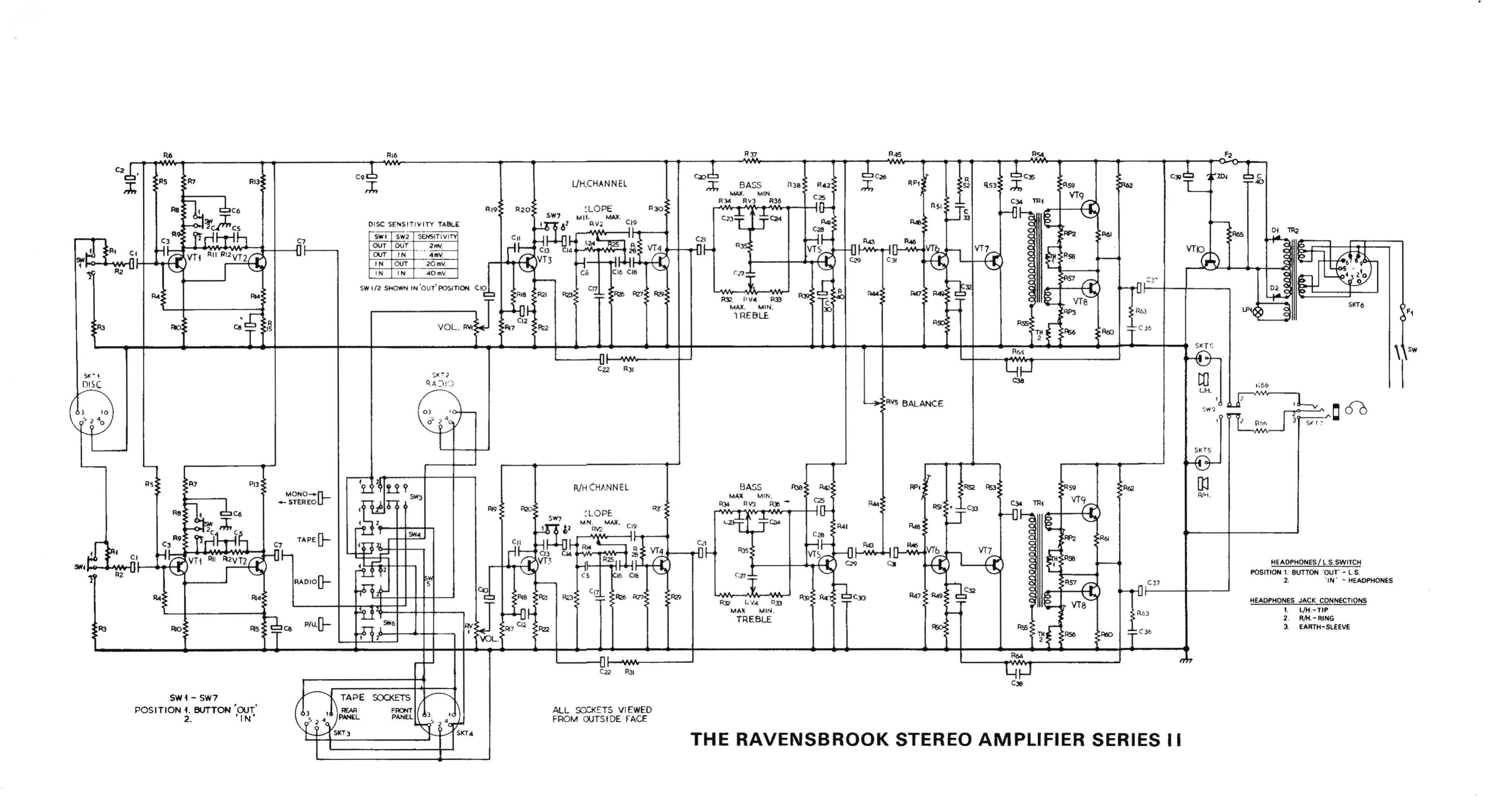

Do you mean transistor VT7 on the circuit diagram? P.S. I am referring to the Ravensbrook Series II.The issue is pre driver T7 is blown
Sorry its the one in the picture, is that the series 2?
If so then yes it must be VT7 even though it just says T7 on the PCB, the metal head sink clamped around it damaged the lettering. I can not seem to find a schematic with the part number on it.

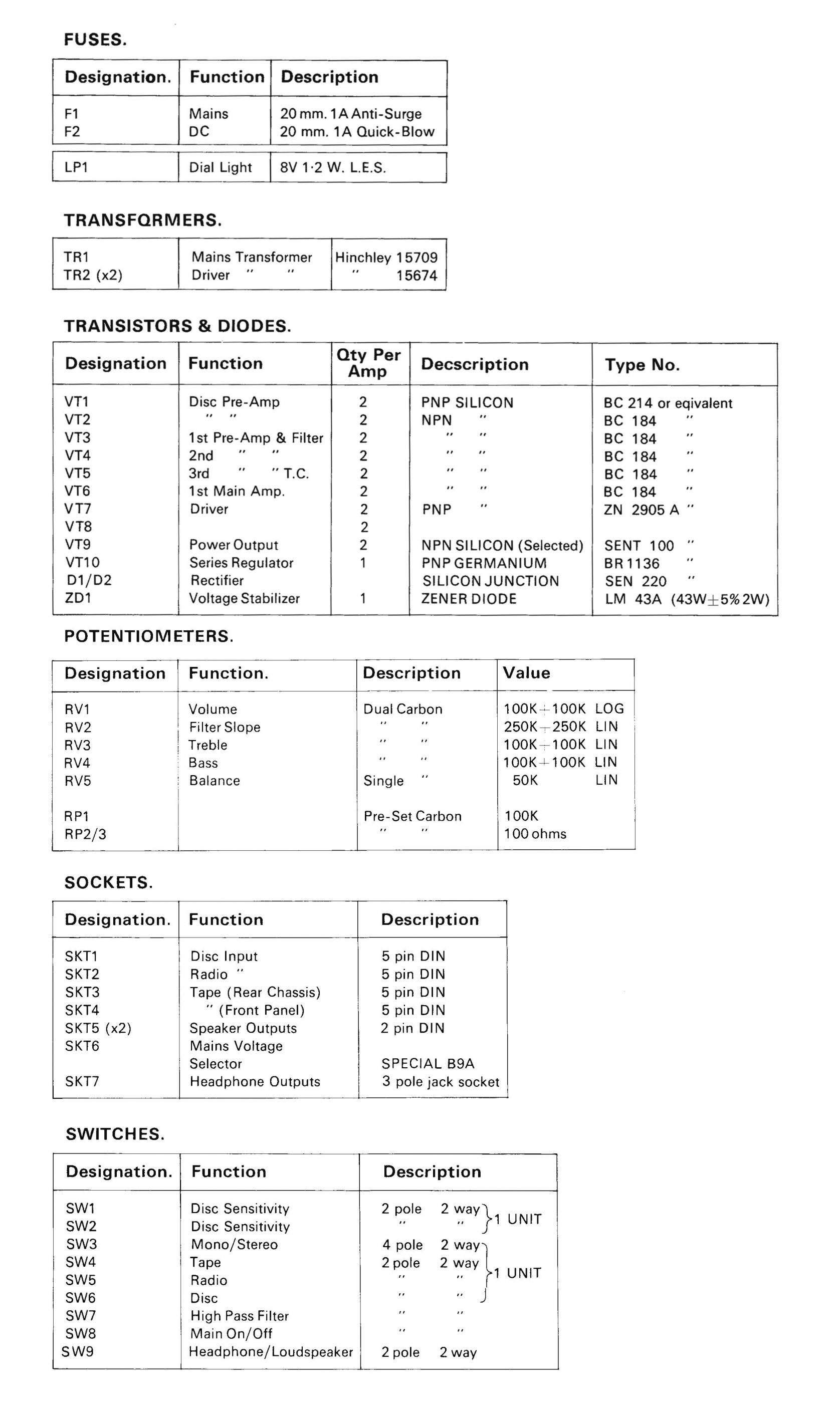

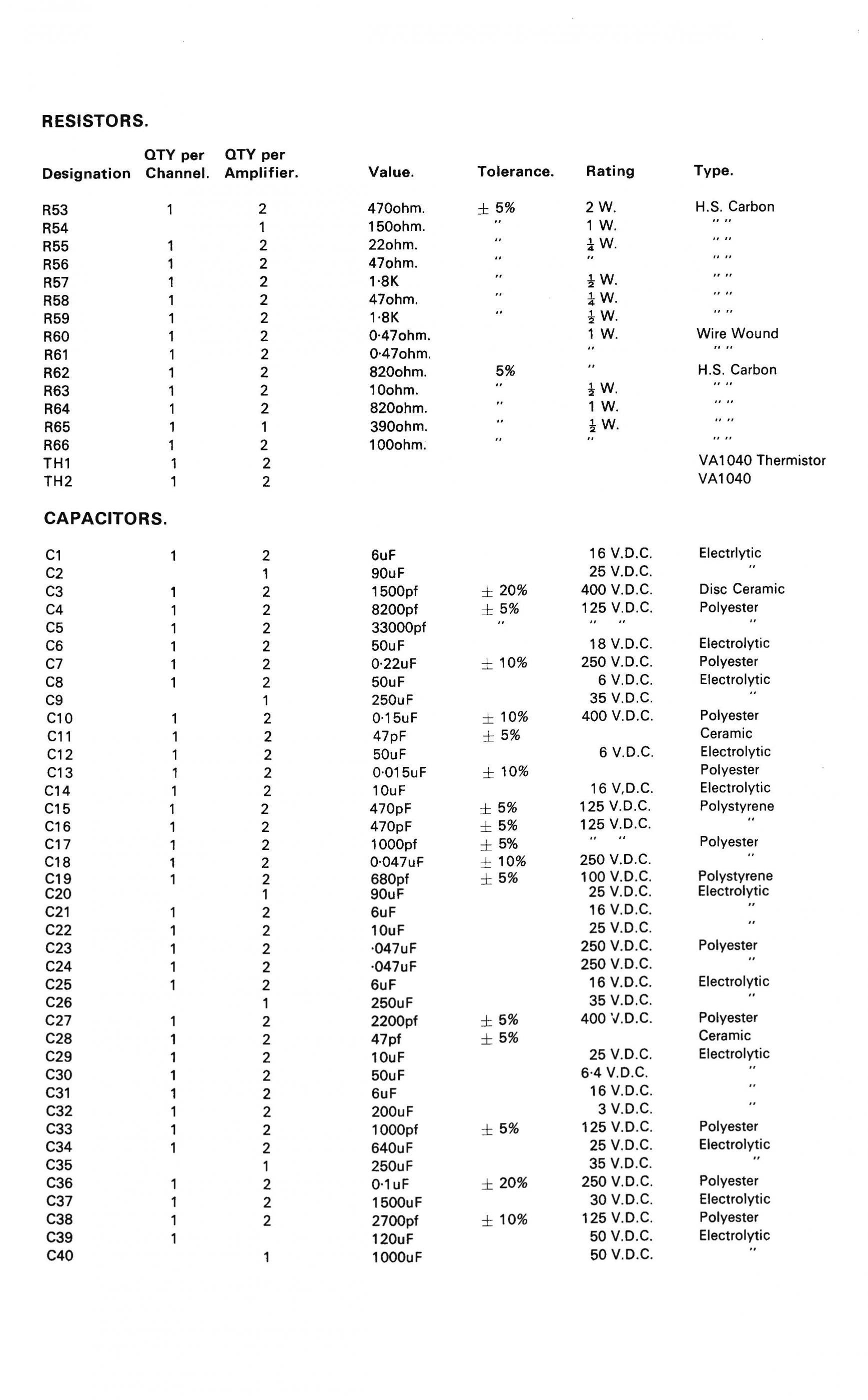

I attach the Series II parts list and circuit for your perusal.
The VT7 driver is listed as a pnp silicon ZN 2905A - I hope this may be of help.
Actually, I think that circuit annotation should say Series III, as that is when the headphone output was added and the output power was increased from 15W to 20W.
Great thanks so much, that picture of the inside looks the same what I have, and yes no headphone output. I will see if I can find a suitable transistor replacement, I have a few bd140's left from repairing a leak stereo 30 plus / or wharfedale linton, I will check if they match.For reference, the heat sinked driver transistors can clearly be seen directly below the bifilar transformers in the attached image.

I've found information in this link Rogers Ravensbrook Series 3 Amplifier - UK Vintage Radio Repair and Restoration Discussion Forum which states that the driver transistors are PNP BD518 and are replaceable by BD140 with a different lead orientation.(see posts #7 and #11).

Just an update on this encase anyone else needs this info, I got it running, the BD140 as pre drivers and the 2n3055H for output transistors both available from Farnell work very well. I have set up the bias across the four output resistors and its remaining very stable, trim pots are in good order. I cleaned all the controls with a small drop of super 10 switch cleaner. The only issue now I have a small bit of hiss on one channel, its not the source or speakers. I thought it might be tr5 near the balance control as placing my homemade audio listening prob on the metal case this transistor was noisy compared to the other channel, but its not the transistor, I replaced the four electrolytic's around it, but no joy. I tested the ESR on all the larger red caps and the smaller golden axial caps and all are good. I will do some more probing around. The hiss is only there or audible when the volume is way down, but the amp sounds really good, Not surprised. I have a similar vintage R.S.C super 3 & leak stereo 30 plus both recapped and they also sounds great, with efficient speakers they work well
