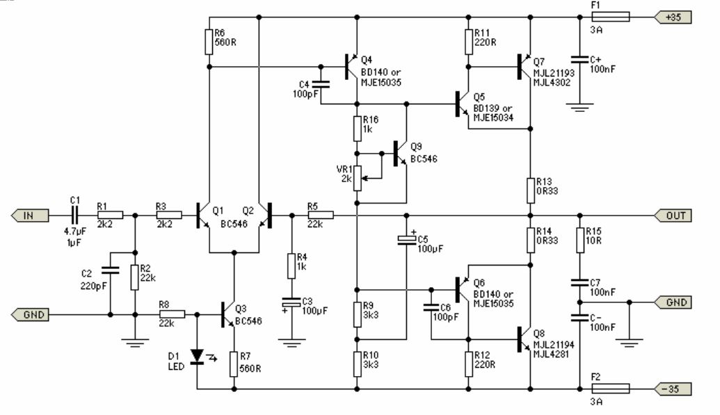

I have just finished building the P3A amplifier, following all the exceptional feedback on the web, and unfortunately the sound is below my expectations. I realize that this is because of some components are used, but I simply cannot identify them.
My main problem is that the sound is very bright, agressive. I am looking for a warm, natural sound. The amplifier at this point has excellent transparency of instruments, good control and is doing an excellent job with all the frequency range from deep, strong bass to crisp highs. HOWEVER, the sound is very "loud", very harsh, bright, agressive. It is very tiresome to listen to it. I think that the middle frequencies are being brought up in front too loud. ( I have noticed this behaviour on the powerful Pioneer A-878, the reason why I changed it for the very warm Onkyo 8670 ).
I have used the exact values for all components in the design. WIMA capacitors for the 100 pF, all resistors are 1% Welwyn, the finals are MJ21193/4, drivers BC139/140 and others BC546 as specified. All A/C capacitors are polypropylene. My main concern is C1. I have used a Vishay polyprop capacitor - 4.7uF at 150V.It is massive in size, and seems of very good quality, but I am worried it is the one giving me this agressive, screamy sound.

A harsh-sounding amplifier might be the result of instability. If you have an oscilloscope and a signal generator, this might help reveal the cause of the problem.
I think you meant to say BD139/140 (not BCxxx) drivers. For C1, why not try a different type of capacitor?

A well-designed amplifier should sound fine without a pre-amplifier, given sufficient line levels to drive the amplifier to its full output capability. The problem is more likely to be caused by instability.
This is a proven good sounding amp, so the issue must be in the implementation - or you have nasty speakers. I have only limited experience, but I would suggest looking for oscillations as mentioned already. After that I would say the most likely issue is feedback compensation capacitor choice and choice of other capacitors. Compensation capacitors - try Silver Mica or ceramic np0. Some metallized foil caps sound a bit harsh to me.
Try using a normal cap for C1 (assuming that is the big green cap floating in the air). By 'normal' I mean small, cheap, possibly lower value. If this solves the problem then you almost certainly had oscillation. The problem is not that the cap is defective, but simply that it is large and hanging over the circuit.
Is this the schematic?

Check for oscillating with a VOM on 20 vac scale with a 390 pf cap in series with the negative probe. Steady voltage with input shorted is ultrasonic oscillation. Or if scope equipped, look for fuzz on the waveforms. Oscillation is random in phase and jitters around so the trace fuzzes up.

Yes, the big cap is C1. I will buy a small one and see what happens. Thanks. I have been told that I do not have power supply decoupling. Can anyone please explain to me a bit how this would affect sound and how to fix ?
Actually you do have local power supply decoupling, that's what the two red electrolytics do. They don't look very big though, so you should still have 2x 2200 - 10000 µF in your power supply... and it looks like you do.
Hint: Twist power cables. The mess you have there right now may invite magnetic coupling to the amplifier and increases power supply source inductance.
