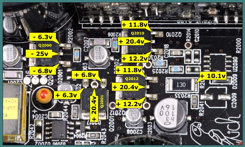

A Rockford T1500-1bd board number 1325-52759-05 (from 2007) doesn't start up. I found two burned resistors R6 and R1022 near the power supply, see pictures.

They are in parallel and both are 20 ohms. I'd suggest increasing the value and using a larger through-hole resistor (properly fixed to the adjacent cap) for power dissipation if there is any sign of overheating of the voltage regulators in the class D section. This resistor drops the voltage from the -20v supply and the two 20 ohm resistors need to drop more voltage to let the SMD regulator transistors run cooler.

With the rectifiers out of the circuit, confirm that all of the class D regulators have the correct voltage.
Output mosfets are still removed. Which class d regulators do you mean?

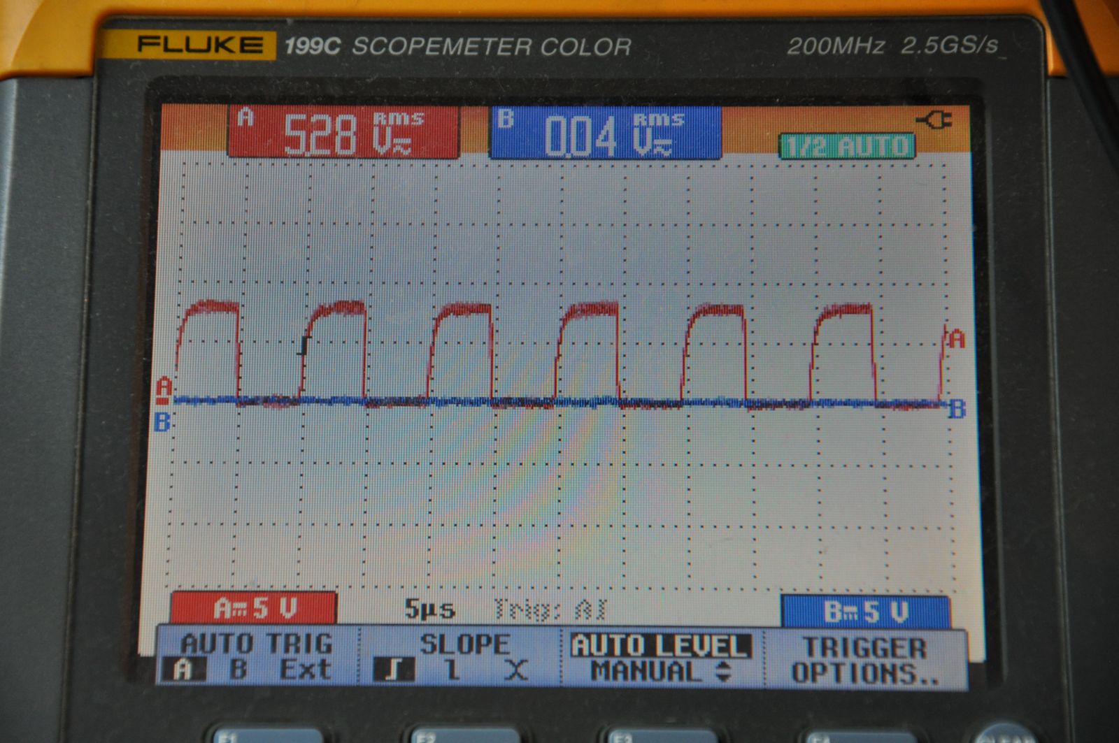

Gate pulses are there on the output mosfets, but on one pair I see pulses with negative polarity and like a very small spike. Gatedriver transistors MPSA56/06 are good, diodes ok...
All measured against ground.
Is this normal, or what should the gatepulses look like?

With output mosfets in, rectifiers out:
Q2006 - Q2008
Q2007 - Q2009
Q2013 - Q2015:
Q2011 -Q2014:
Q2006 - Q2008
Q2007 - Q2009
Q2013 - Q2015:
Q2011 -Q2014:
Connect a jumper across R220 on the class D driver board. That should get you to a 50% duty cycle.
