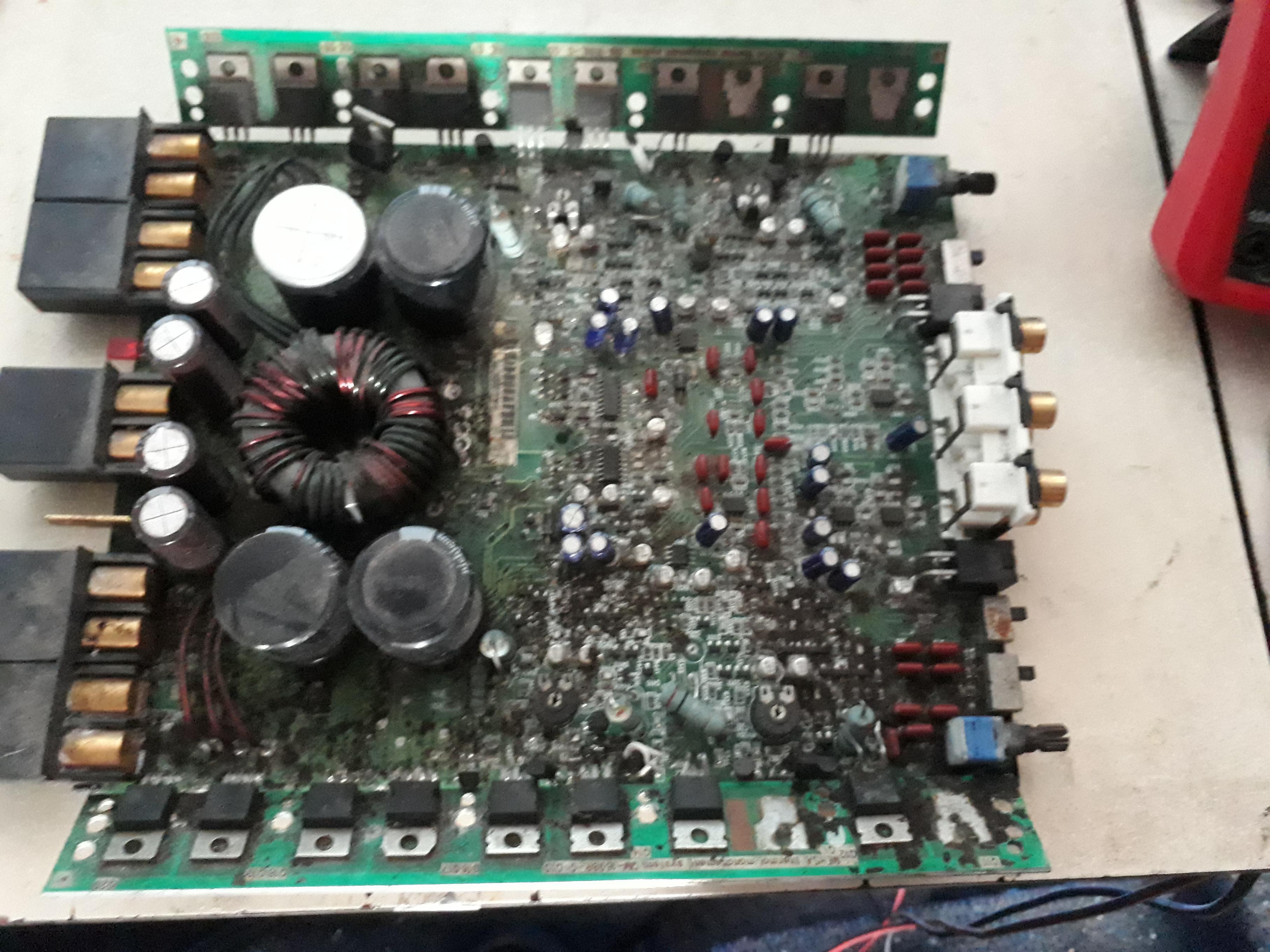

Hi guys i got to actually working on the amp doing one channel at a time but amp pulls excess current with outputs in
I would simply check the various resistors and transistors that drive the outputs. You can't check class AB drive signals with the outputs out of the amp like you can class D drive signals.
