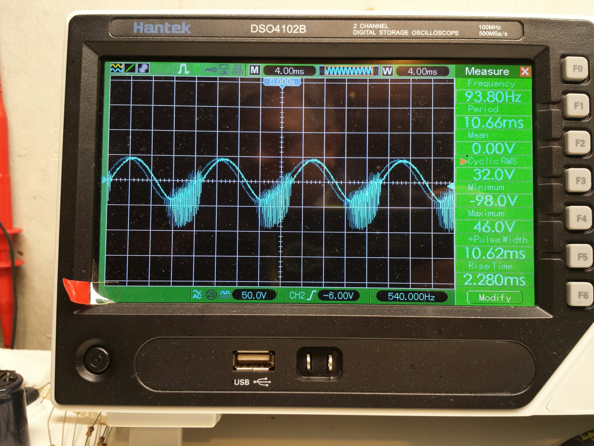

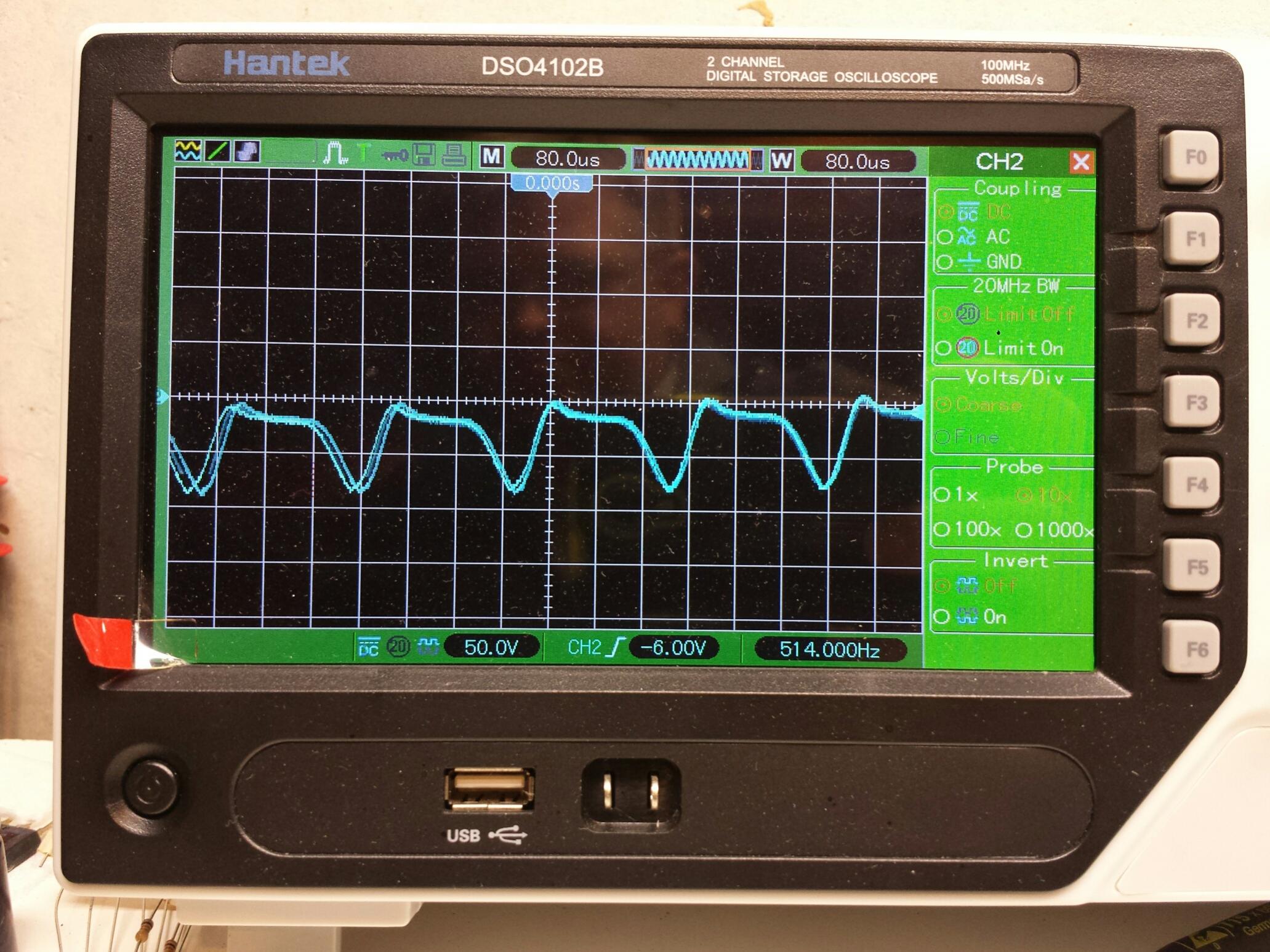

Perry I replaced the gain pot and the definitely fixed the erratic gain control but didn't fix excessive current draw after turn gain to an output of around 30 vac no load. I have included two pics one on the output with a 60hz signal driven to a point where it begins to have an arcing sound on the set of fets closet to the output terminal draw excessive current. The next pic the scope set to dc to try and capture high frequency during the problem. Time constant is not the same as the drive signal though but there is something..
Remove the red and blue wires that connect the two boards. Power up the amp and confirm that the voltage across those terminals on the PS board doesn't exceed the rated voltage of the rail caps. If it does, stop there.
Discharge the rail caps on the audio board with a dummy load or other large limiting resistor.
Look at the gate signal on all of the audio FETs. You should see a relatively good square wave that has an amplitude of about 8-10v. IF you can't see the waveform on the audio switchers, connect a load across the speaker terminals.

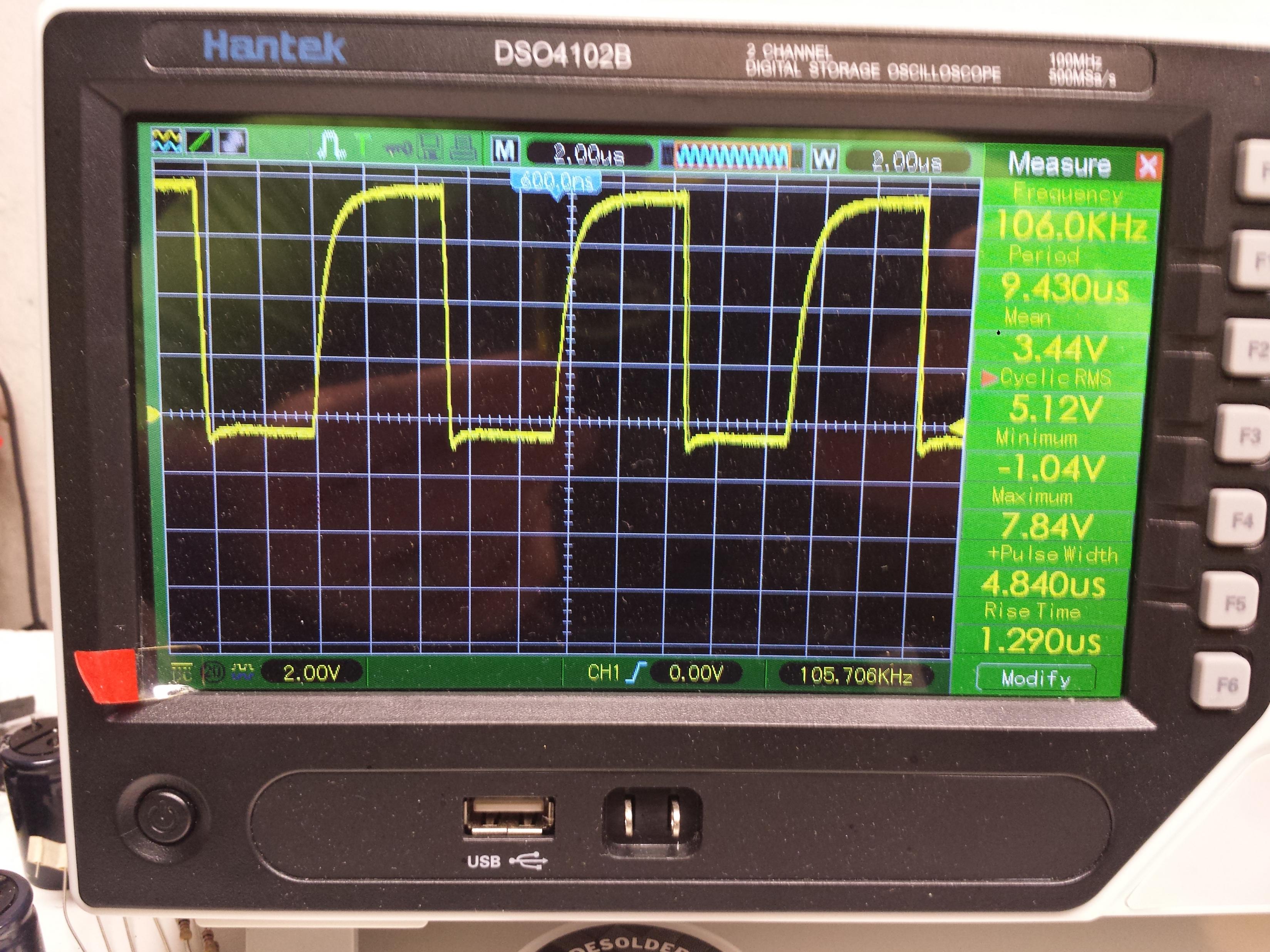

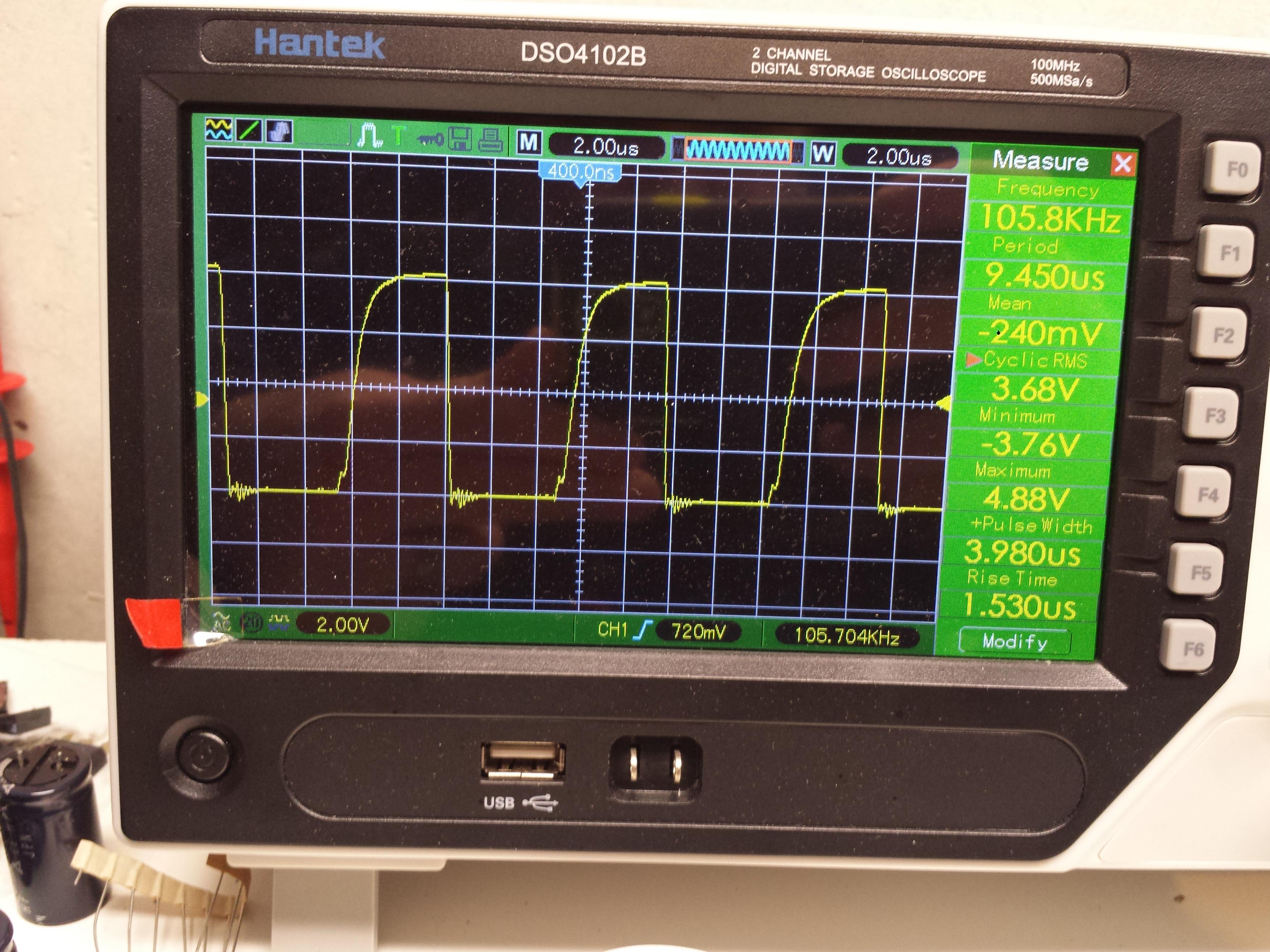

Okay Perry here are 2 pics of the drive signal on the rail switchers. The left pic is from Q413 and the drive signal is smaller in amplitude but cleaner and not square. The other pic is the drive signal for Q418. It has more amplitude but seems to be noisy towards the bottom. Also I noticed adjusting the gain changed the shape of the drive signal until it recovered and went back to normal.

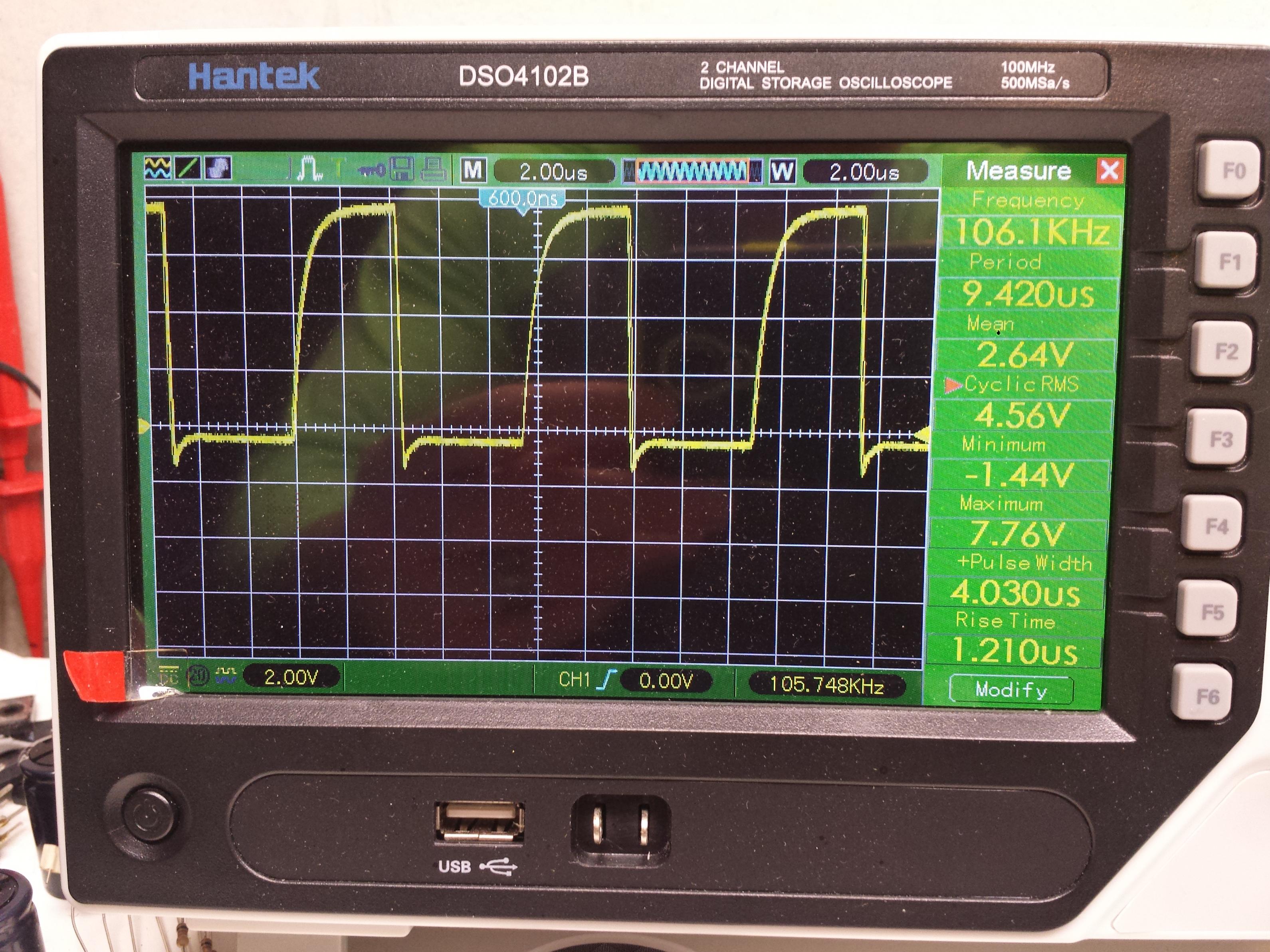

These should be a nice square wave correct? I did replace the UC3526ADW yesterday. Powersupply has a high pitch squeal to it

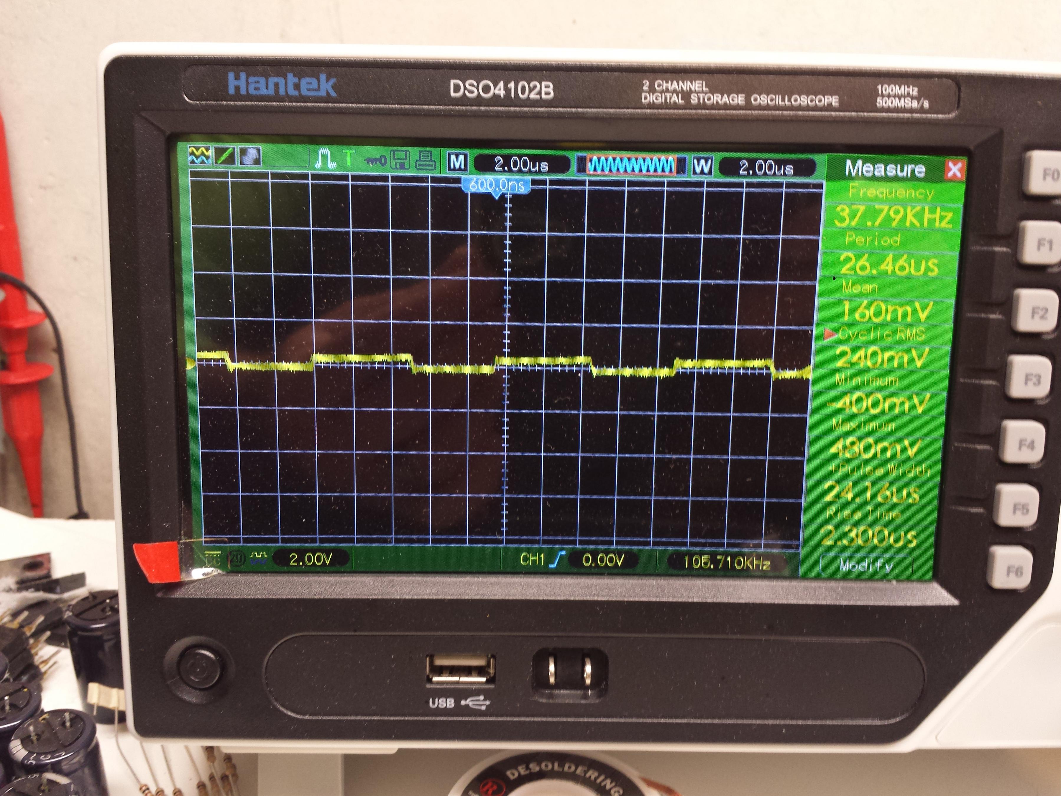

That's from only two of the 4 drive groups.
Without DC coupling and a ground reference, it's difficult to tell much. Leave the scope on DC coupling unless it's absolutely necessary to go to AC coupling.
The falling edge is what's critical. The rising edge is curved but normal with the FETs loading them.
The noise where the falling edge reaches its lowest point may be due to the inductor. If you ground the 3rd leg of the FETs being scoped, it may clear up. Ground it through a current limiting resistor to confirm that there is no problem grounding it. If it has no problem after connecting the limiting resistor, you should be able to ground your scope probe to the 3rd leg of the FET.
Have you found the problem with the drive for Q426?
I'm assuming that you meant that the scope ground was on leg 3.
That is correct I meant the grd on the 3rd leg. I haven't found it yet. Does this symptom seem like the root of my problem?
