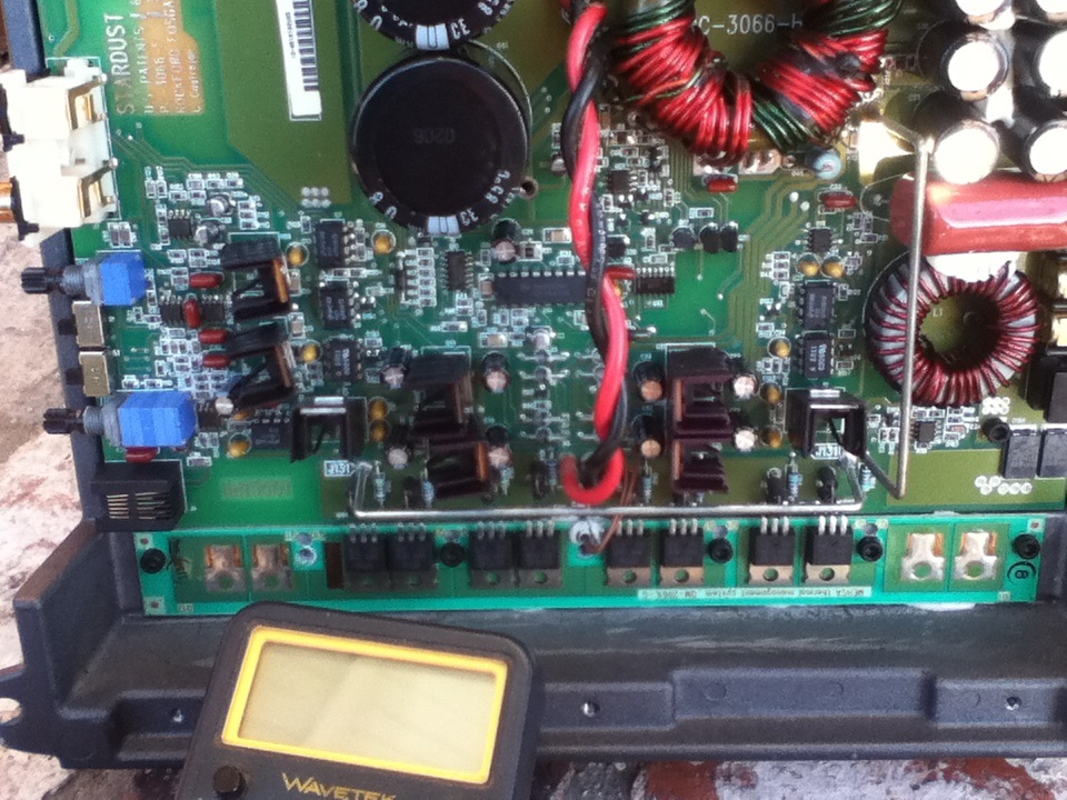

Hello everyone I just in for my own collection a rockford fosgate power 500bd. It's in protect (red light on) I checked the output fets (IRF540 & IRF9540) they all test out fine no shorts. If I can get a lil more detailed help on this one that would be cool. I've never had BD series power amp nor have I ever touched one. This is my first time.
This is PC-3066-F board.
Here's a pic

Dont have schematic in front of me but Q15 and Q16 are regulators and yes they run hot...totally normal.
I always check the solder joints on those as well since they run so hot.
If U21 is defective the amp will remain in protect. Take one out of your parts boards and throw it in since its your own amp. You can always order new ones and put it in later??
Its a TL072C pretty common op-amp.

Alright just thought maybe those where the culprits.
I have a couple parts boards that have those if it works then ill order new ones for extra reliability. I just have to buy some more desolder braid and see what happens.

It was that IC I replaced it from a parts board. Amp will turn on protect will flash for a sec then resume to normal. I played it for 2 hours in the car full tilt didn't skip a beat. I'm going to order a few of these ICs new for mor reliability.
