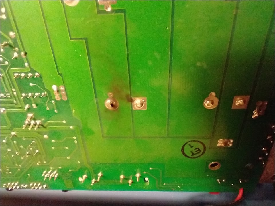

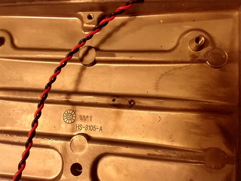

I'm looking at a Rockford Fosgate BD10001 that I took in as "working" but needing the remote turn-on tab repaired (torn off trace & vias, etc). It had typical broken RCA shield leads, so I repaired those. When I pulled the board I also found C39 had shorted to the heatsink at some point as well.
The amp powers up and produces audio, but I only have small bookshelf speakers currently available so I can't test to full potential. That said, I was wondering if these are normal for this amp:

The cap doesn't look like it was trimmed to the correct length. Cut it. If you're still concerned, install a spacer to keep the board away from the heatsink.
