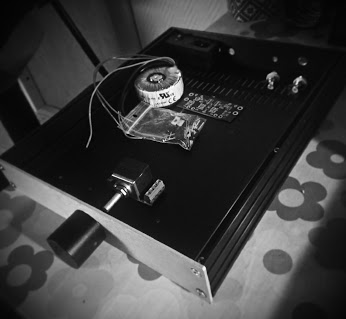

I have ordered the boards. Meanwhile, I have laid out the other components on hand for a dry fit.
GX248 enclosure with Qualtek inlet module. Tiffany style gold plated RCA's. Noratel 20va 2x12 toroid (enough power?) a rectefier board from Peter Daniel. Alps Blue Velvet 50k. 34mm Black aluminium knob. I think the oversized knob's gonna look cool on this case.
Panels are made up in Front Panel Express, but they will be the last on the shopping list.
Hookup most likely Kimber TCSS. No fancy stuff, just plain ol' quality.
I haven't buildt much in the past. I hope I don't screw this up 🙄

i'll be keeping an eye on this thread as i'm a Sapphire user and abuser 🙂
you will not be disappointed with the sound. i'm still playing with mine (rev 14s1 boards) and at the moment i would say it does not get any better. Richards rev 20 boards address all the problems of the 14s1 so your in for a treat. oohhh and don't bother with the by-pass caps as they robbed the sound on the 14s1 boards so i would hazard a guess it will do the same on the 20 boards.
i would also recommend you get some nice caps for C1. the ones Richard sends out are nice but a bit rough sounding in the vocals.
a single 20va is not going to cut the mustard so do yourself a favour and get another one.

Don't be worried. I have not star grounded my amp, and I have also used the toroids ground wire to chassis. Removing this and using starground can fix the humming. Or so I am lead to belive. Yeah the polish are wicked cheap.
Ok, so I need another toroid and rectefier bridge . Very well.

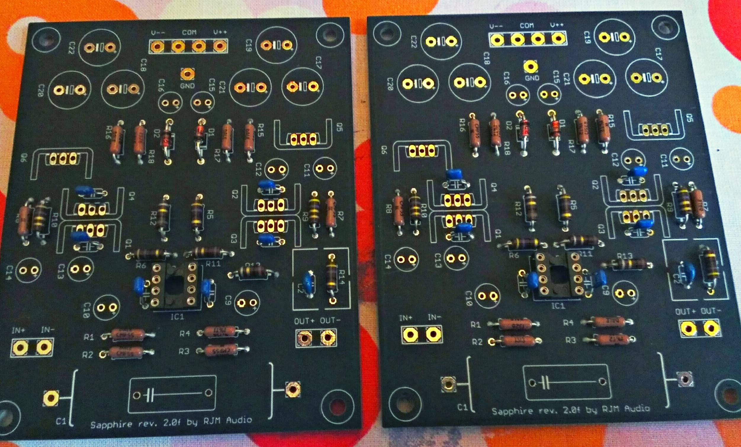

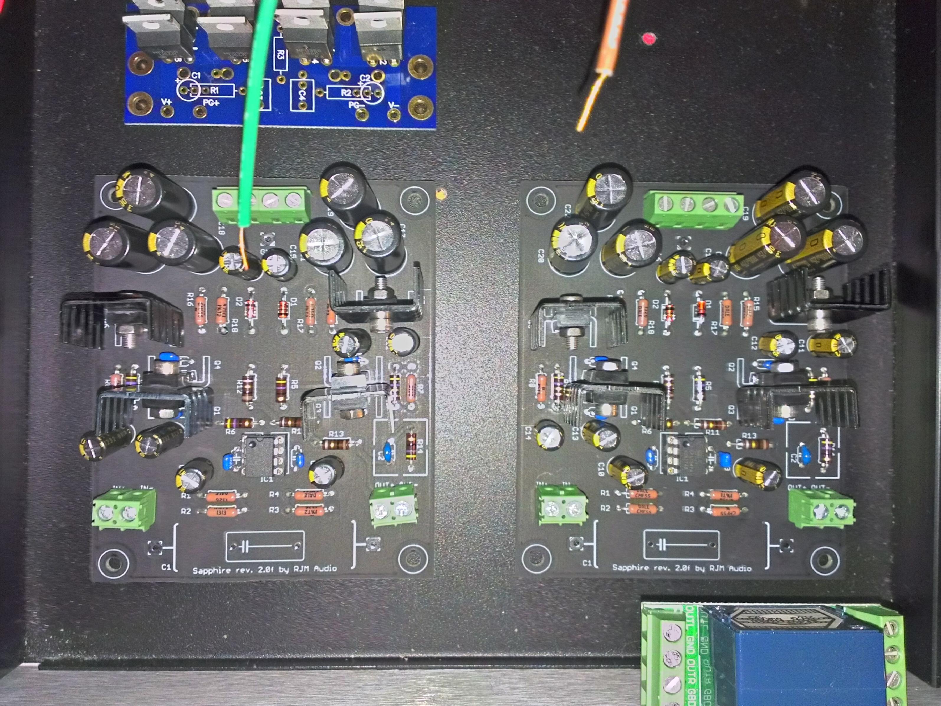

The boards kit arrived today 🙂
I went straight out and bought a cold soldering beer and got to it. I have learned a lesson or two from previous mistakes. I worked systematically this time, not just parts and solder all over the place. They came together after a couple of hrs and a dinner break 🙂
looking good 🙂
i love the soldering part and hate wiring everything up. i can never get wiring to look neat and tidy like other folk :-(
i would have waited to see what Richard's final thoughts were on the by-pass caps though.

Yeah, me to. Wiring inside tight spaces especially. I am thinking I need a toroid with 4x12 instead of trying to fit and wire up two of them. I checked with Toroidy and it's about 50 euros shipped (75 shipped for an "audio supreme" version) that leaves me with an extra transformer for something else. A nice powersupply for my B1, perhaps.
I had some spare Phoenix contacts, so wiring should be simpler. I won't have to solder anything underneath the boards.
