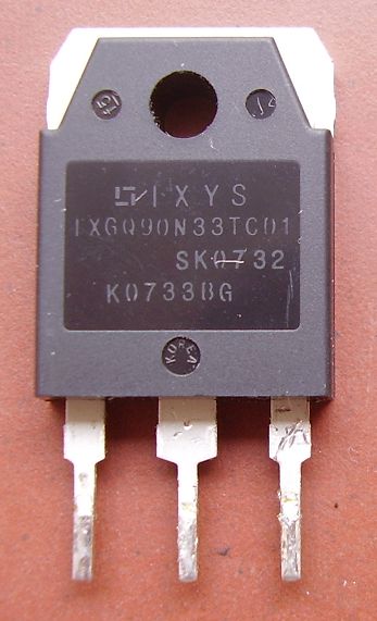

Where did you get these IGBTs? Are they semi-custom parts being used by some amplifier manufacturers in agereement with semiconductor brands before they are released to the general public? 😀
I dismounted them from some rejected PCB from Samsung. It wasn't an amplifier, nor an SMPS, I guess it was a driver of some kind of big display, or vehicle. They seem to be new development indeed, but unfortunately not especially for audio.

I found similar one : IXGQ90N27PB
http://ixdev.ixys.com/DataSheet/DS99609B(IXGQ90N27PB).pdf
IXGP and IXGA parameters is equal. (the difference is the package)
IXYS don't like to notify Qrr in body diode. 🙁

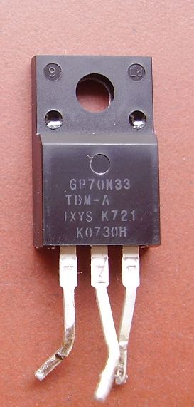

Did you probe IXGP70N33 ? looks more useful the TO220 package IGBT.
Unfortunately the switching freq was not fixed, so I can tell only the idle freq: 200 kHz, but this is somewhat irrelevant.
I didn't try IXGP70N33, mainly because the isolated package can dissipate very little power. I'm planning to remove isolation from the bottom... This has an ultra low saturation voltage (1V @ 16A), so I'm going to use in (resonant) power supply instead of in amp. I don't think it would be fast enough.

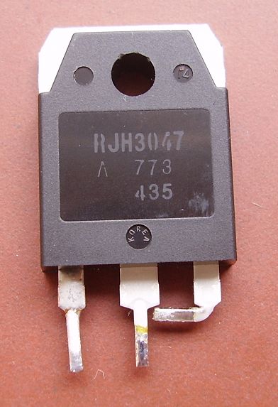

RJH3047 datasheet
Hello,
I'm searching for that device to repair my samsung television.
Can you send me a RJH3047? ( i will pay for is)
I have already discovered the exact part name is
RJH3047DPK
VCES= 330V
IC = 50A
IC peak = 250A
tf= 0.15
trr = 0.06 µs
VCE(sat) = 1.5V
it is from renesas
greetings
