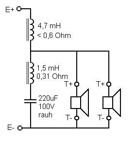

Hi ozziozzi,
As to your amplifier connections: it is my understanding, that the passive filter elements suggested for use with the Ripol are driver specific parts of the design, and should not simply be replaced with an active crossover. Maybe Calvin can shed some more light on that subject.

Tb46, the diagram you attached seems, to my limited knowledge, to be part of a passive Sub XO first-order 6 dB/oct at about 135 Hz (assuming the drivers are 8ohms each) plus some sort of correction network. I am not sure what that is supposed to achieve. Perhaps others can comment on it.
Since I plan to use active Lowpass at about 160-200 Hz I will not need an inductor between the amp and driver(s). Hopefully This will avoid cavity or driver resonances and not require extra passive components on the driver. Only time will tell. The drivers I can use have an Fs about 40Hz. If what I read about ripoles is true, this may result in usable output at 30Hz, good enough for me. I am mainly into Jazz, blues, modern adult contemporary, folk, modern country. What I am really thinking about is a FAST system, Fullrange plus "helper" woofer.

the original Ripoles come with the passive EQ-network, which forms a Notch-Filter that kills the chamber resonance around 250Hz (+-100Hz, depending on the dimensions of the chambers).
This filter may be implemented with active technology .... its just not a original Ripole anymore 😉
