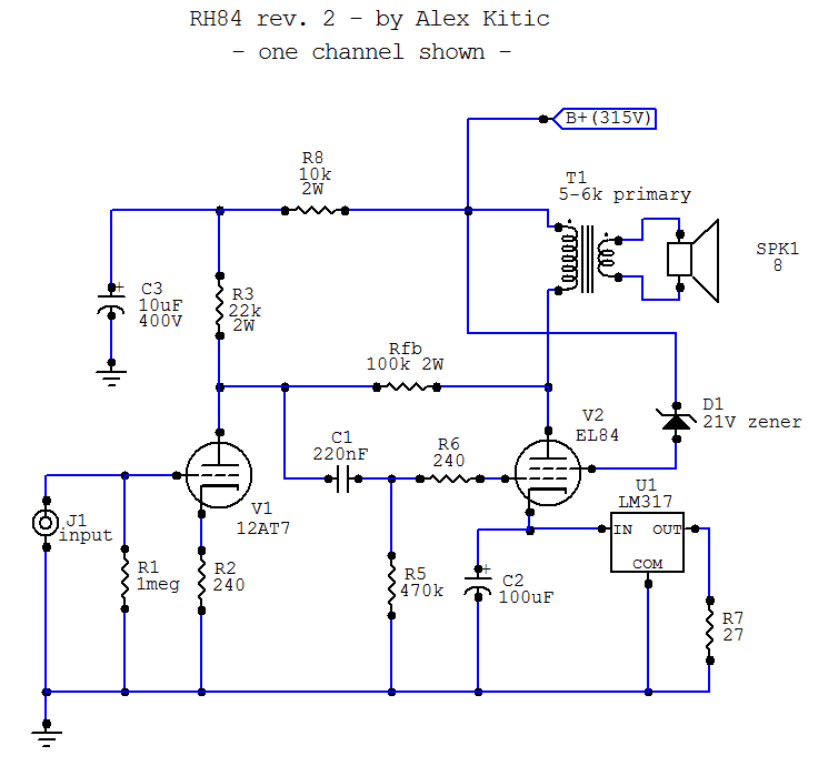

RH84 V2 (C1) 100UF Coupling Capacitor
I have bought some Elna Silmic II for the 100UF cathode bypass caps on the EL84.
I want to buy and try Nichicon FZ and FG as well.
FZ: https://www.mouser.co.uk/datasheet/2/293/e_ukz-3082249.pdf. These are available up to 100v
FG: https://www.mouser.co.uk/datasheet/2/293/e_ufg-3082295.pdf These are available up to 63v
Rubycon UKZ2A101MHM1TN https://www.mouser.co.uk/datasheet/2/977/e_LLE-1600605.pdf
I am looking at using them for the coupling cap on the EL84. Is it worth using 63v, 80v or 100v ratings or is that overkill for this position?
RH84v2 (C3) 10UF 400v Capacitor
I am also thinking of using the Nichicon LLE for the (C3) 10uf 450v capacitor on the RH84 V2, or I could use a 450v Kemet PEG124 Capacitor.

Right, so there's 3 types of caps in your amp: power supply, coupling, and cathode bypass.
PS caps tend to be EL caps, and Nichicon UCY and Panasonic EE seem to be the most used in our branch of the hobby. I can't speak to the suitability of those Rubycons, hard to decipher the datasheet. These caps tend to be rated at 450v. Higher b+ ranges will require higher ratings, possibly using film caps. 450v caps tend to be cheaper than 400v, 420v, etc, probably due to their popularity. Volume, baby.
Coupling caps are typically axial film caps and must be rated to withstand the full b+ voltage. There's a lot of hooey, bunkum, and snake oil associated with coupling caps. Orange Drops are good, so are Vishay MKP and WIMA MKP. Just don't spend too much to start.
Bypass caps, I like Nichicon UFG or MUSE, you want good Audio Grade caps. Sprague Atom and TE are popular in guitar amp world. They only need to be rated for the voltage seen at the cathode, maybe double that. I've read that an over-rated bypass cap can hurt bass response, so not too big.
There's nothing wrong with Rubycons, their factory has produced some of the most desirable products in the history of tube amps, it's just a question of suitability. And with so many choices it's easy to be overwhelmed and buy the wrong thing. I got some Rubycon caps for a heater supply (that were meant for LED) instead of the Elna Silmic II that were recommended and there was audible hum that went away when I put the right caps in there. If you're gonna go to all the trouble of building one of these things, don't re-invent the wheel too much. Use proven components.

Your schematic incorrectly shows the 5R4 as having a cathode (cathodes warm up slowly).
The 5R4 is a directly heated filament, it start up quickly.
The Loaded 315V B+ (might be more than 315V at power-on, because the input and output tubes are cold, no load to the B+).
That means that at power-on, 315V will be applied from R8 to R3, to C1, to R5, to ground.
315V will appear across C4 the coupling cap.
Rfb also applies 315V to C4 (across C4 at power-on).
Use at least a 400V rated coupling cap for C4.

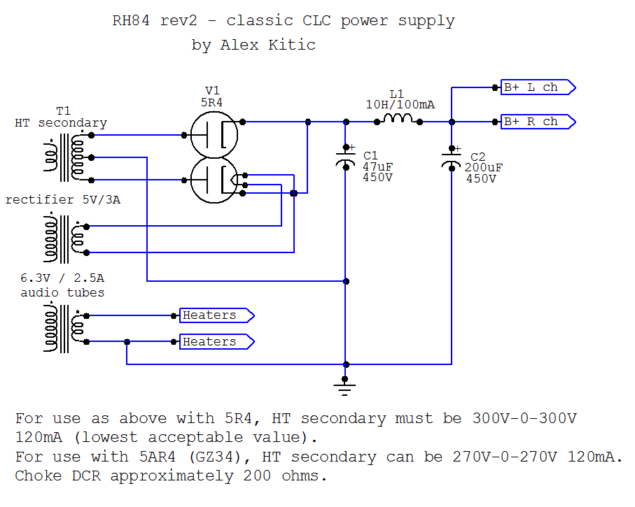

Finally, is the bleed resistor connected between the first PSU capacitor C1: 47uf 450v and the choke on the CLC or is it connected after the second capacitor C2:200uf 450v C2?

The bleeder resistor is supposed to discharge C1, C2, and C3.
The choke has to be good enough so it does Not open if there is a short.
So, you can put the bleeder across Either C1, Or across C2.
You have to make sure that R8 does not open, or C3 will not be discharged by the bleeder resistor.
Two 25k Ohm 5 Watt wirewound in Series makes a good bleeder. 315V and 50k Ohms is just over 6mA; the total bleeder dissipation is 2 Watts (10 Watts of bleeder resistors).
