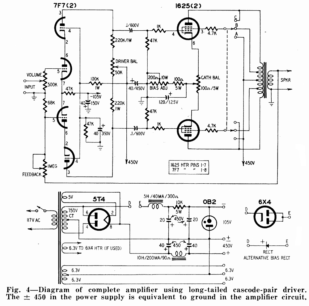

To be honest I was thinking about using this front-end (designed by JC Morrison) for a 807PP amp with local feedback.

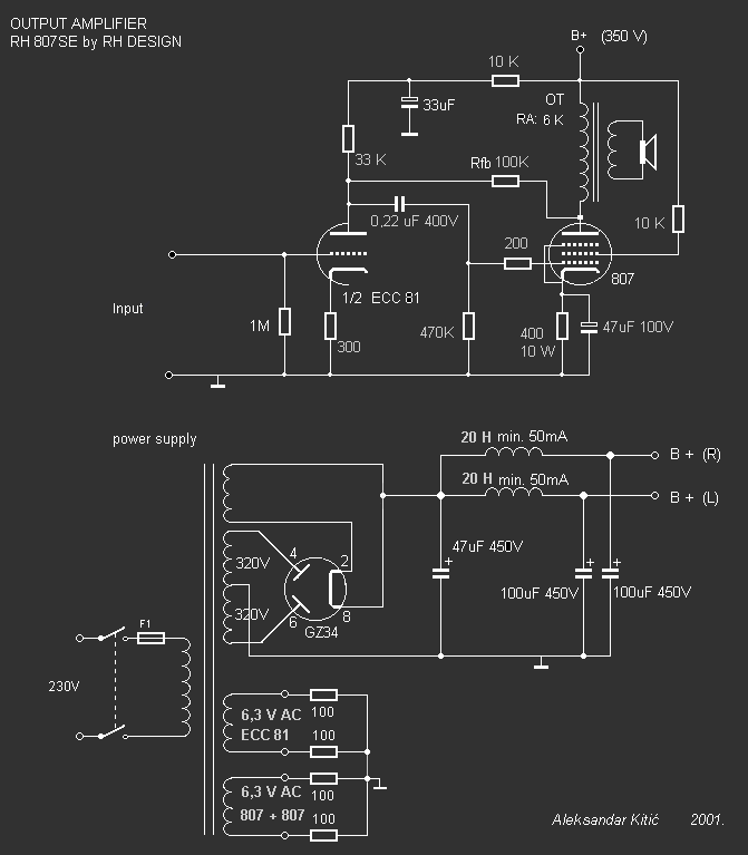

The RH807 design depends on plate feedback current influencing the plate voltage of a relatively high Rp triode. Feedback would need to go to the 1st stage before the cathode follower. With the RH807 a CCS is not used on the driver plate, but certainly could be.
The cathode follower is not needed to drive an 807 unless you want A2 operation.
The cascode is cool but that driver balance pot is weird. It would need a little rework for local feedback.

Here is an amp that intrigued me. Outputs are 807 precursors, Amp itself is a precursor to the Allen Wright PP1c. The cascoded LTP at the front is ideal for RH style feedback.
dave
Cascoded LTP in front of 6L6 derivatives with Schade style LFB is Miles' signature dish isn't it?
