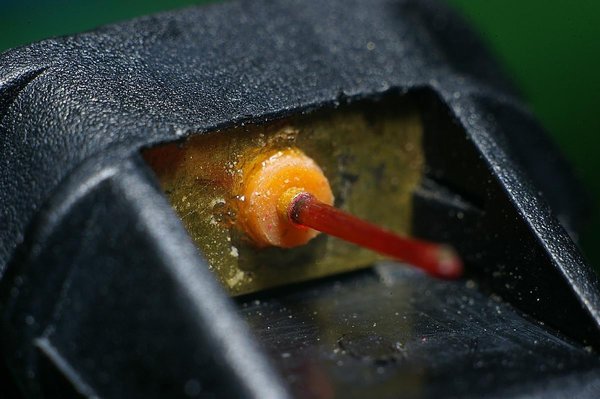

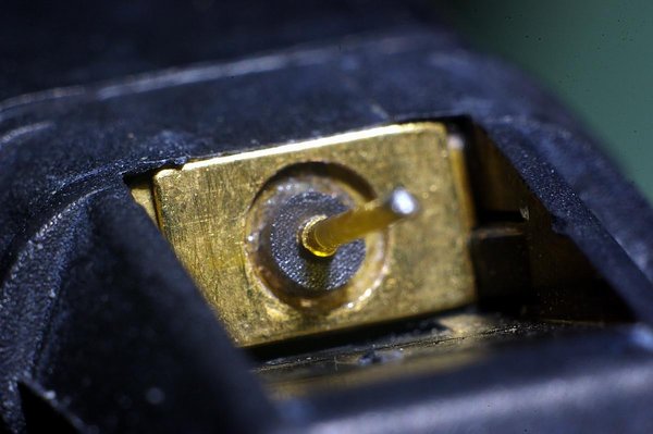

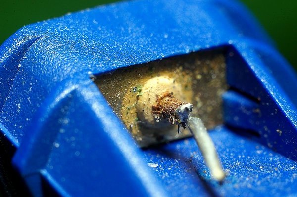

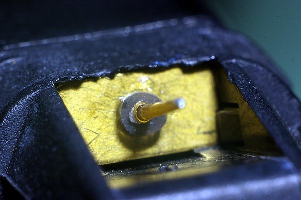

Some pics. The P8 rubber goes hard. Very hard so unlike say an ADC, you can't wiggle it a bit to get it back to life. Attached is one before and a couple of after shots. If you want to get yours in my next parcel to Russia to save postage happy to add it in.
