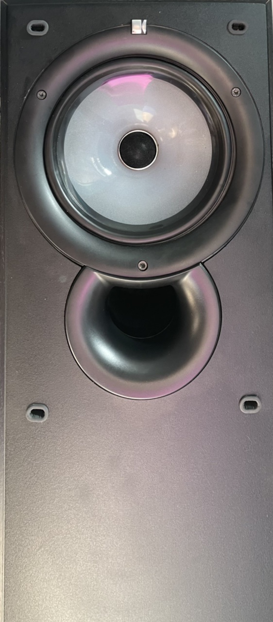

Just got these:
They are KEF Q35’s. My luck must be in, I’ve never seen KEF in my area on freecycle either!
When I got them home I noticed one speaker sounded like it was blown. A very scratchy sort of sound on the thump of any bass. Oh well, can’t win em all.

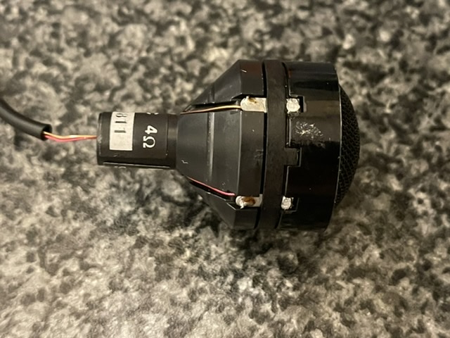

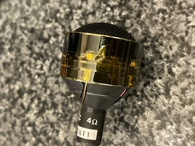

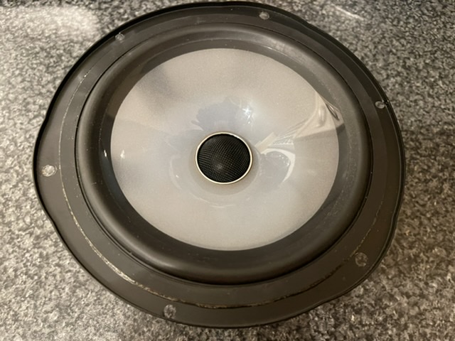

My thoughts on these are: I don’t like the design of the driver, most peculiar. It’s not full range, it’s a tweeter sat in the centre of a mid bass. :-/ the posts on the back of the crossover are separated for high and low frequencies.
Here is the driver:

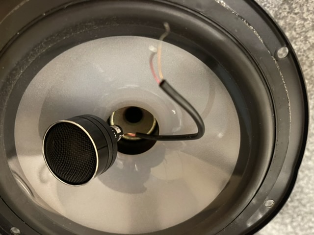

One possibility would be grabbing a cheap full range driver on AliExpress and swapping out, just using the cabinet. Pressing the cone with my hand produces the same noise! What? The cone is plastic, is it cracked? Personally, I think it sucks. But free is free and landfill we don’t like, so let’s disassemble:
So it looks like there are rough edges on that tweeter!!
Could it be as simple as the edges scraping the cone as it flexes?
Let’s tidy up the solder, push the contacts in as much as possible and tape with Kapton. After this some silicone spray to facilitate smooth movement:

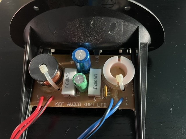

Also here is the crossover:
They’re about 20 years old, so I’ll put the mundorfs I just got got the Goodmans in there. The bass value is 10uF and the tweeter value is 8uF. I have a 10uF, and will use 2 x 4.7uFs in parallel for the tweeter.
While I was in there I replaced the foam gaskets:
Verdict? Scratchy noise is gone! Not sure if the recap has made a difference. The recapped speaker sounds the same as the one that hasn’t been, so will probably put the old ones back. Not bad though.

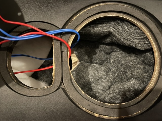

One thing I will say (and I’m going to come across as a real bass junkie here) is that the bass SUCKS. I assumed the entire cabinet would be open to increase the bass, but it’s blocked off 3/4 of the way down. I wonder if opening that up would help. Not sure how I’d get a power tool in there though.

Any attempt at changing the internal volume will upset the tuning of the port and the bass response will change unpredictably.

Interestingly simple crossover on a polycone bass. I don't know if these were Mundorf NP capacitors you fitted, but I think it's likely you had a broken solder joint there. The vibration often cracks them
Possibly, but they sound great now. Very clear and detailed. I have a habit of overdoing solder on things so I doubt it’ll happen again. They are shadowed by the Goodmans though. ;) thinking about it, there was a piece of hot glue rattling around in there that had come loose from one of the ferrites, and there is a slight defect on one corner. My guess is maybe it was dropped or knocked. The lady said “they’re in the way” I like “in the way”. :)

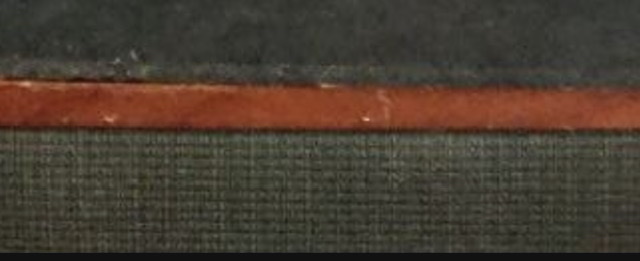

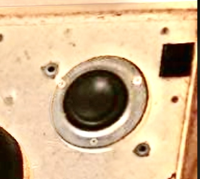

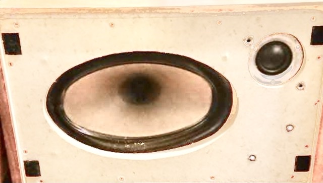

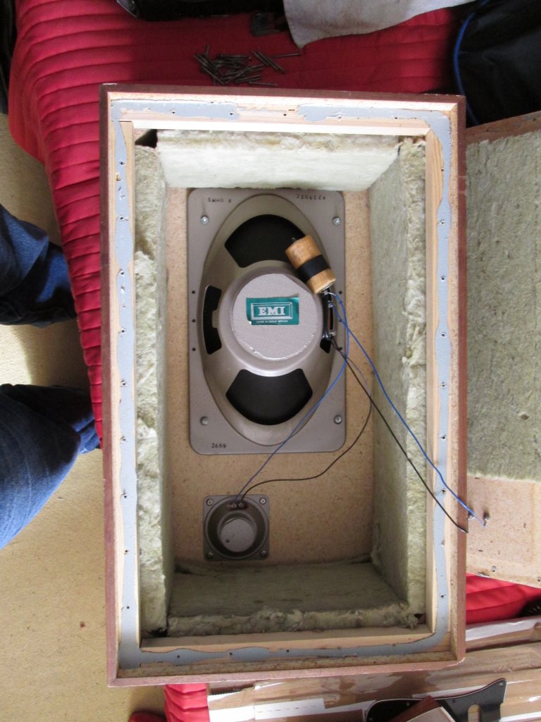

The image is too dark for me to see if the elliptical unit is a twin cone, full range driver or whether that is a tweeter or a port alongside it.
Elliptical drivers make me think of Philips.
You would have to get inside if there are no other external clues.
david83
2020-10-13 2:23 pm

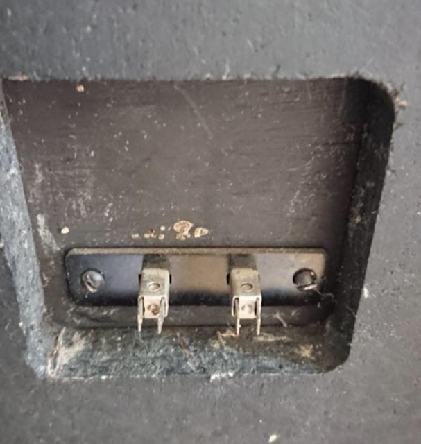

I don’t have them. I’ve just seen them pop up. I’ve messed around with the brightness on my phone:
Looks like a tweeter not a port.

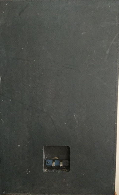

Not much on the back:
Those posts do seem to look the same as the disassembled pic you attached above. You can make out the rounded square they are sat in.
Glimpse of grille fabric:
Would an EMI of that era be worth picking up? Probably an hour round trip.
Galu
2018-04-17 6:50 pm
The speakers you picture could well be home made.
The dome tweeter is a departure from the EMI cone tweeter which usually accompanied the elliptical mid/bass driver.
Even if the elliptical drivers are from EMI, I can't see them as being anything special - such drivers were probably made in their squillions.

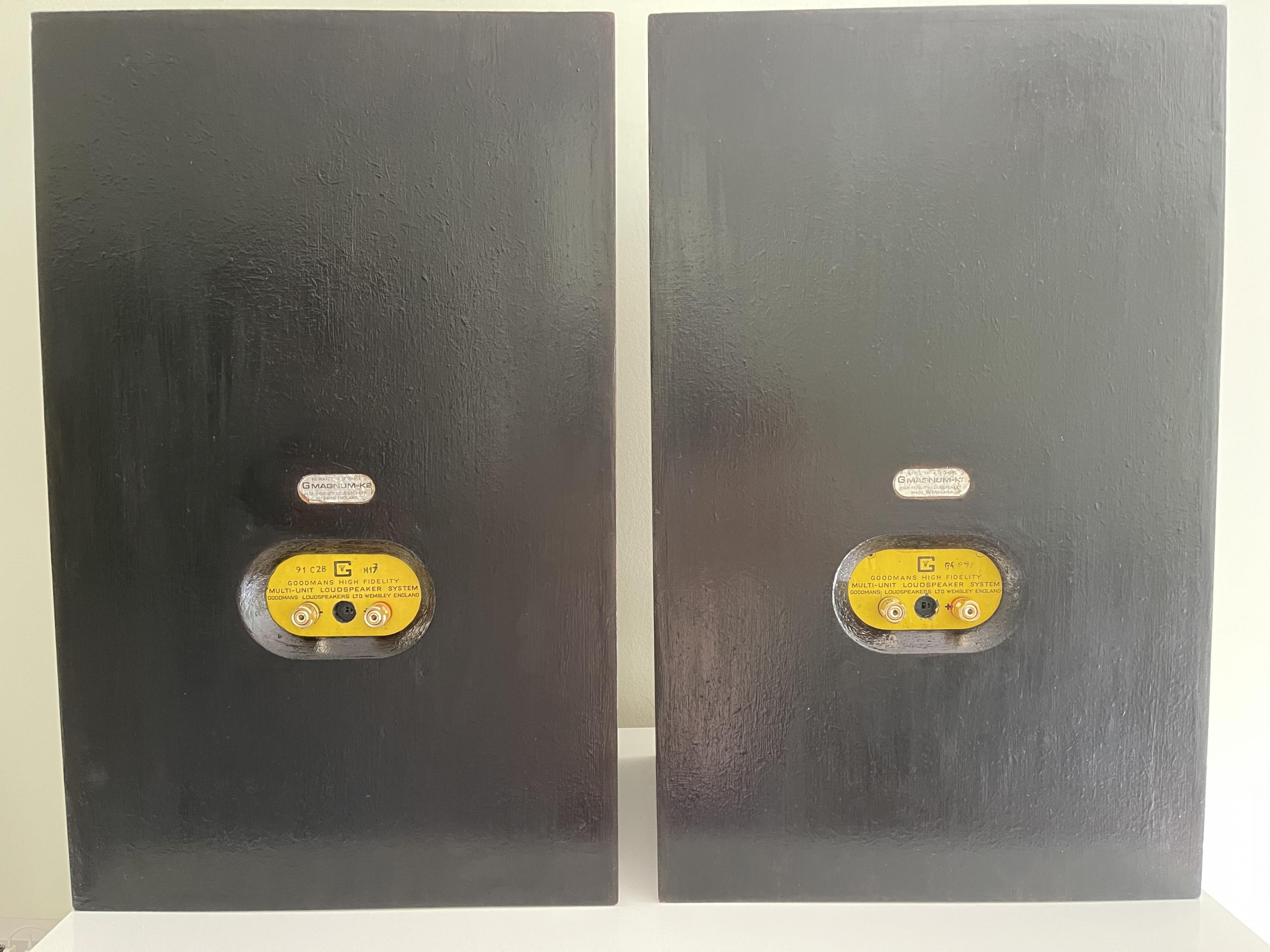

I still haven’t been able to get the wood I need for the stands, so I’m going to go back on what I said. I’ll be writing up the thread over the next few days but here’s a picture of the finished article…. More to follow. I’ll have to add the stands at some point when they are done. Not sure when that might be!
Here’s the badge:
