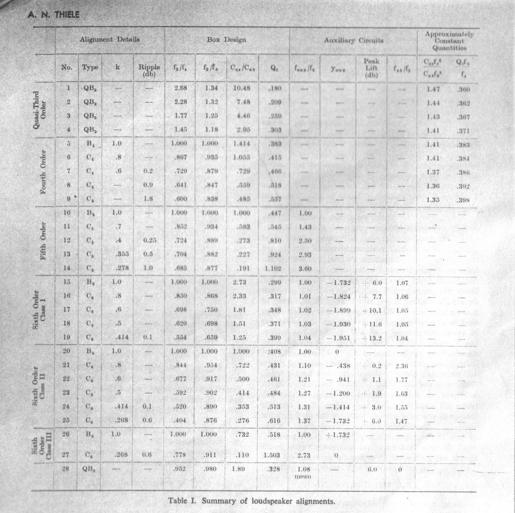

It depends on the programme material and the system in question, but it's technically possible to create a very low-tuned (as in 16Hz or < ) EBS vented box with similar GD over most of its passband to a critically damped sealed, but with a final 'kick' of extra output around Fb in the infrasonic range. Not a bad compromise to have, but it needs the drivers & system to be able to do it. Still, the potential is available, even if it's not viable for many conditions. Assuming you don't regularly play material with content below, say, open E double bass [roughly 42Hz] you can get away with something tuned a bit [a bit 😉 ] higher for similar benefits if you're after a well-damed system & you're particularly suseptible to overhang.
Frankly, I don't think all that many are -or in a good proportion of cases, not as much as they might think, because far too many vented box systems either aren't designed with a particularly good / 'practical' alignment, or haven't been optimised for a given situation and what they're in fact hearing are the consequences of this rather than a fundamental issue with the box type itself. Not to say they don't exist, but it can be exaggerated. This can be where Dave's resistive-vent boxes can come in, or more prosaically, 'just' a well designed vented, be it Helmholtz or QW based, with a decently damped system rolloff and not excessively undersized to prevent excessive overhang. And if you want to critically damp it via the old click test for the situation (not a difficult or time consuming task, especially for something that reaps dividends) -so much the better of course... 😉
