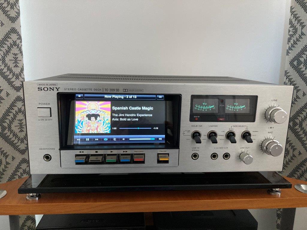

I have just realized that I haven't posted what it looks like now.
Here it is for better or for worse,
There are a few things I am still considering, including altering the screen placement, but at the moment the unit has pride of place on the top of my stereo rack and gets regular use by the family and I, so that is a first, an endorsement of something I made/put together!
After a few months of using the original VU meter driver section I decided to upgrade it to a modern driver circuit and the VU meters now operate with more consistently and it even allows for calibration. I have also chopped out the switching matrix linked to the cassette 'piano keys', which allowed me to define what the switches do in terms of instructing the Picoreplayer running on the RPi. These are now direct hard wired to the salvaged USB keyboard controller PCB with 'REW/Stop/Play/FF/Rec/& Pause' all more or less doing what they would have done when it was a cassette player, except for 'Rec' which initiates, 'skip to the next track'.
It has been good fun putting this together and has kept my mind off the stresses of work from time to time. A kind of Therapy!
