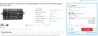

Which type of cap would be best for DC blocking? Also which brand? The tech has got hold of the values. He said either 4.7 or 5 would do? Dunno how far he is correct.
Something like this should be ideal I would have thought.
https://cpc.farnell.com/ampohm-wound-products/fp-ca-4-7-au/capacitor-audio-4-7uf-630vdc/dp/CA05706
Whatever you get needs to be a non electrolytic (not polarised) and what we call a film type construction. There are many that fit that description. Look for a decent voltage rating, you want higher than 63V
https://uk.farnell.com/vishay/mkt1813547255/cap-4-7-f-250v-10-pet/dp/2860213?st=4.7uF film
There are also many many more in rectangular outlines.
Before I could give the tech my advice after reading your comments the guy went and put a 5 uf capacitor 400v (4.7 uf only needed) . Seems to be a generic one.
I happen to listen to the speakers for the past 4 hrs. I returned after a power outage to find the only one channel playing music. After a restart of the poweramp things look normal.
Could 5 uf cap cause this issue. Cause in the gallo explanation they had said the cap was for protection of the amp, dc blocking and also as a voltage divider. The amp had issues with one channel soime time back which was fixed also..
