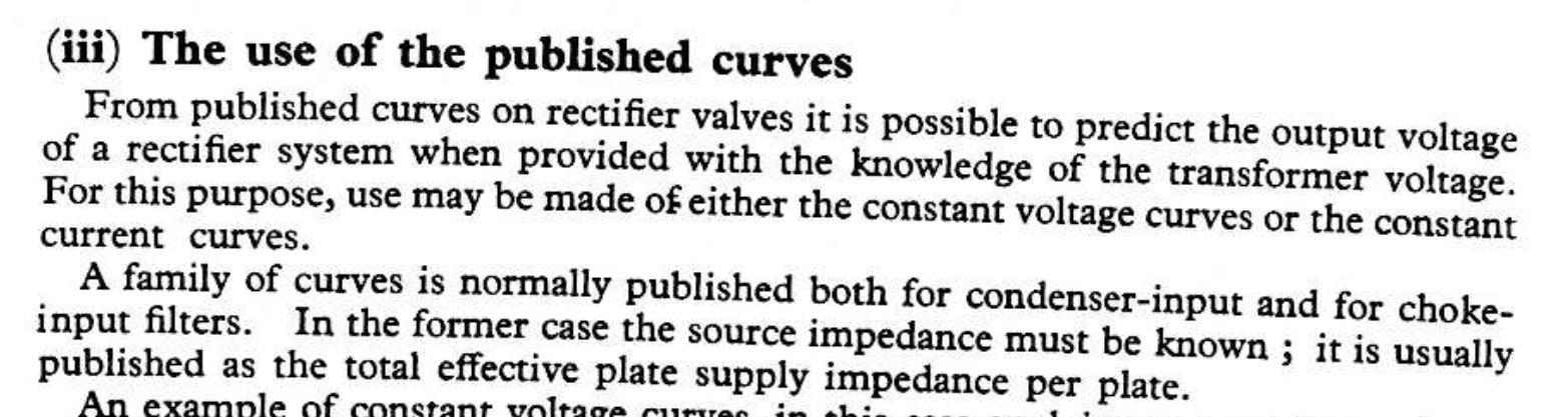

That is because the voltage drop of the rectifier is larger in the 6BY5. If you want more voltage use silicon diodes. Only 0.7v drop with those.
I think i understand the confusion. Rp is not an equivalent resistance of the tube, but rather the source impedance. The voltage drop is current dependent and cannot be approximated by a resistance. Often, there is an appropriate graph in the datasheet.

Indeed, I was equating the voltage drop with Rp. I don't understand why that isn't a correct assumption and what Rp values are good for then.

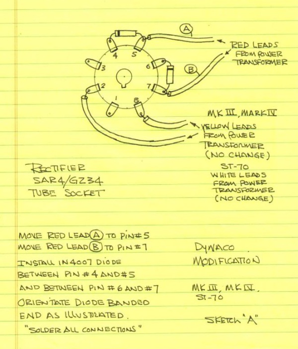

Rectifier diodes going gassy is not too uncommon, so a modern day method of bullet-proofing that is to add silicon diodes in series with the valve diode. Peace of mind for some of us - especially as gassy diode faults have been known to knock out power transformers that aren't adequately fused.

PIV = peak inverse voltage. A graphic for the series SS diode technique is provided. I suggest UF4007s, instead of 1N4007s, on the hypothesis that less switching noise to begin with is better. The vacuum rectifier does block SS diode switching noise, no matter what.
