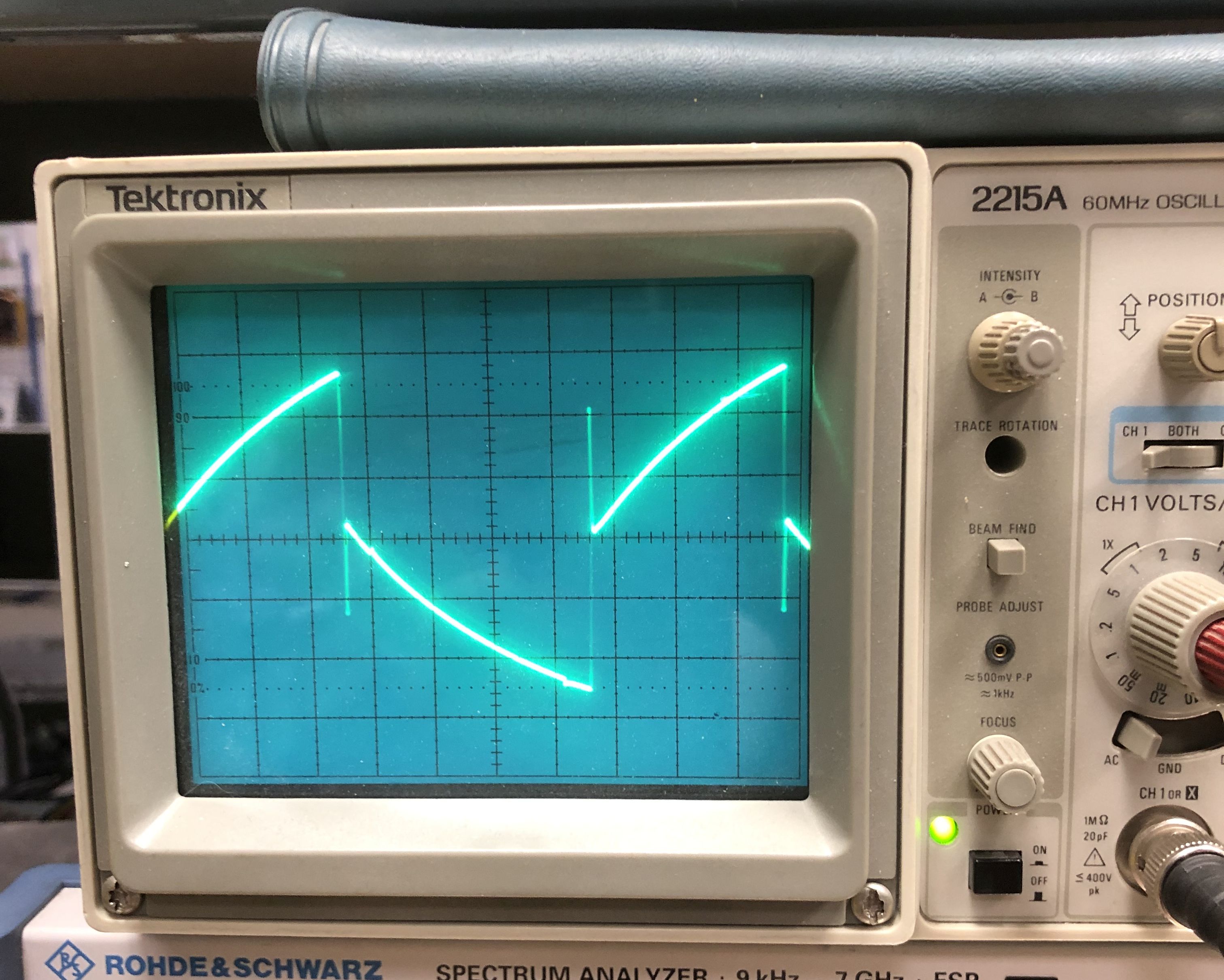

The waveform on the gates with mosfets in the board is only a spike just in the moment then ist clicks in the Coils.
I think you'll have to remove either the NPN driver transistors (lift 2 legs is good enough) or remove the FETs to check the drive signal.
Now i have unsolderd the mosfet in the dc-converter. The amplifier comes up without overcurrent protection. The blue led lid .
the Picture show the gate drive. One side Show a lower drive. One Transistor of the Driver was burned and i Change it to BC807/817.
Whats the next?
Whats the next?

Post the drive signal taken at the gate of the PS FETs (one from each bank if they're not the same).
