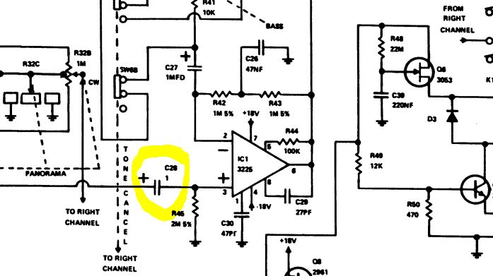

Just happened upon a vintage Crown IC 150A pre in my friends basement. Thing sounds great, but I couldn't stand having a balance pot in the signal flow so I cut the thing out hoping to simply soldier the pot leads to completely bypass the pot. Stupid idea I'm now realizing. I have only managed to get a fraction of the signal to return and only out of one headphone. I did this by fiddling around in the amp until I found a connection that produced some signal. Anyone have any ideas how to make this bypass actually work?
For each channel, connect the volume control's wiper to the + end of C28,
removing all other connections to these two nodes.
The balance control is the usual passive shunt type, with a trim parallel resistor.
Thanks for the help rayma! I have 2 questions about this:
1. The model that I have does not label the PCB. Do you know where I can find a schematic to locate this cap? (I have looked all over the place with little luck)
2. Just to double check: you want me to solder to the wiper of the VOLUME pot, not the BALANCE?
sorry im quite a noob...
That's right, and remove the connection to the balance pot from the volume control.

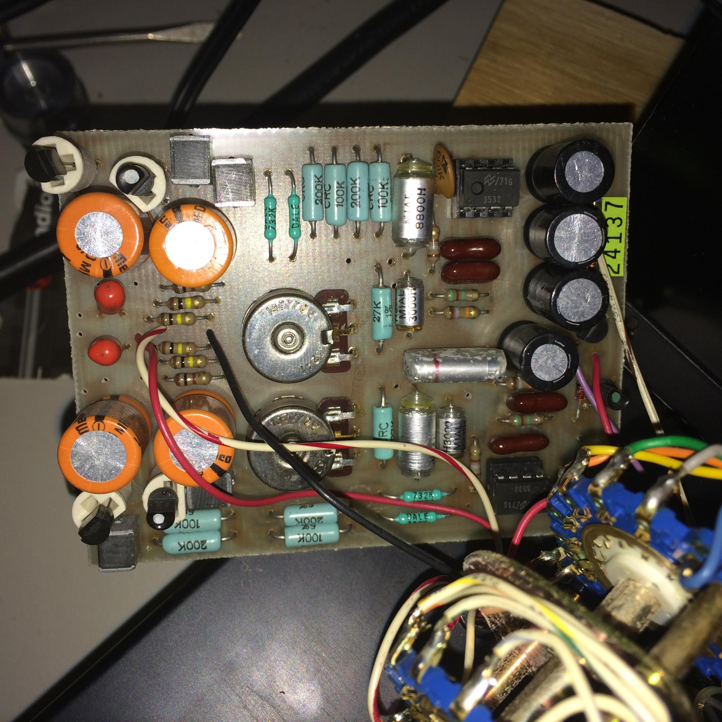

Thank you guys for taking the time to help me out with this! I have managed to find the capacitor c28 on the schematic (its name only appears on one schematic and it has only a "1" as the value...) I have tried to find it by locating the 2M resistor that it connects to on the main board and what I believe to be the opamp section with no luck... Here are some pictures.
if anyone has any hints or ideas, I would love to hear them.

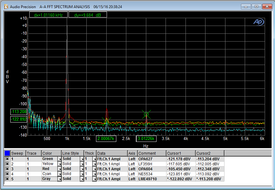

The IC used in the Crown IC150 line amp is totally life-less.
huhuhuhu
The LF356H still acquits itself quite well. I think you may have had an issue with the non-polarized electrolytics.
I've used NE5534, OPA627, AD825AR, LME49710, OPA604. Of these, the NE5534 is a unsung champ.
LM301 in the phono stage could probably use some freshening up...

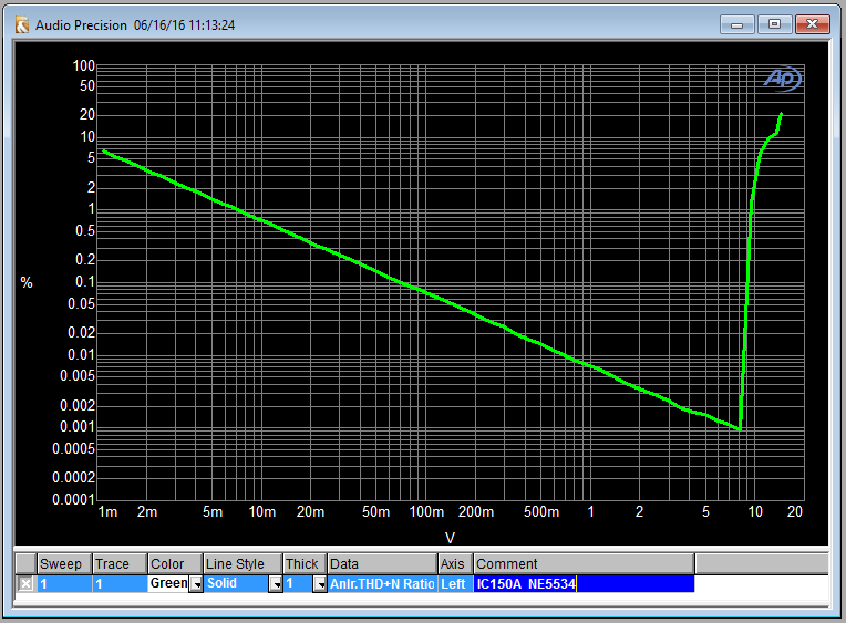

Here are 2 screen shots. This is a Crown IC-150a with the stock power supply.
You can see that it runs out of gas when the output reaches 8Vrms. This is lower than specified in the manual.
Everything seems fine with the NE5534 in place of the LF356H. It tests better than the OPA627.
