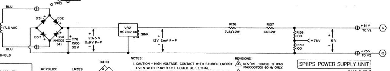

I wondered if I could just when not using phono or inverted out remove the tubes to perform these duties so V1, V2, V3 and V6?
Less stress on the Powersupply, less heat less AC intake.
Also my toroidal gets pretty hot to the touch but I think that is caused by:
"The high-ish transformer secondary voltage, giving raw 400VDC, will give a good tolerance to mains undervoltage, though the MOSFET voltage rating will have to be 500V or more to ensure it isn't damaged by over-voltage. This MOSFET (Q26, MTM2N45) is mounted on a large heatsink and will get quite warm in use, since it drops eighty volts or so at about 150mA."
For reference the Schematics and some pictures of the actual unit. I already removed that odd 10.000uF JCCon radial left from the upper orange Roederstein 4700uF axial cap.

Given the complexity and extensive use of semis in the device and B+ still being there I would not take the risk but I would look for a bridge or the like where the B+2 and B+3 of the phono preamp can be cut off, and also the same for the filament voltage.
Normally pulling unused tubes is possible. It saves energy and useless heat. It is a complex high part count device and I truly wonder how it compares to a 2 JFET monster like DCB1.
Apart from the PSU section that feeds the +81 and +75V to V2 I stiill need all the remaining three PSU sections for HV and filament for the remaining 2 tubes.
Can you explain what would be the risk of such an operation? I'm an amateur in this technical stuff so I'm not debating.
I also reasoned as you did that "pulling unused tubes is possible. It saves energy and useless heat", and saves NOS tubes also!
I also reasoned that an open circuit is the ¨friendliest" load for a powersupply.

You look at the starting point of PSU but better look at end points B+2 and B+3 to the phono preamp. I honestly can not tell what will happen when tubes are pulled and semis are still under voltage, that is why I would not do so. Just suppose something goes kaputt, kinda defeats the intended gains.
If it would be mine I would fit it with sturdy phono on/off switch in the chassis only to be switched when the device is powered off. That would fit user friendliness, versatility and the pitiful "resales value" chit chat. Many will accept the enhancement based on saving and longevity.
I will never of cause pull out tubes when the unit is still under power. My suggestion is to remove the tubes (in my case V1, V2, V3 and V6) before startup.
The only powersupplysection which will not have a tune connected with it is V2.
The three others will all have a tube connected with it only in reduced quantities.
May…..but it would really surprise if it is like that with 4 tubes missing. What weighs more? The power consumption of the tubes or the somewhat higher voltage at the regs (that now see less load) inputs …..
BTW of course I did not mean that tubes are pulled out while the device is switched on. I tried to point out that maybe damage will occur with the tubes missing and semis still under voltage in a now incomplete circuit. Therefor the suggestions to cut power.
