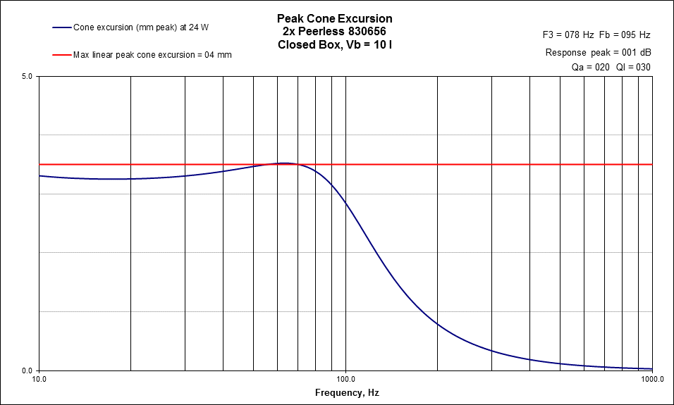

Unibox is showing a "safe" cone excursion limit of only 24watts for a 9.5litre volume with 2 drivers in parallel (QTC of .932):
So even if I use the high pass in my home theatre receiver, I'm still looking at something like a max of 30 watts to this channel. Is that normal?

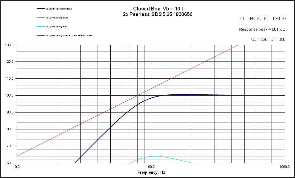

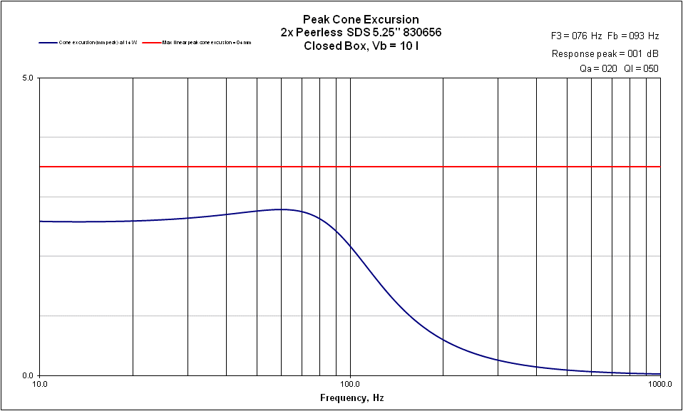

First, yes there is lots of content below 150Hz in the CC and in fact many people don't appreciate that most movie content comes from the CC alone. But that still shouldn't be a problem in your situation because...
Second, I'm not sure that you are fully understanding all of Unibox's graphs yet or perhaps the relationship between xmax, LF extension and SPL. Specifically, you can't really talk about xmax without talking about SPL but LF extension is not dependent on either one of those. Let's look at some more graphs, all with 2 of your Peerless 5.25" in parallel in 10L sealed (walls covered; no leaks).

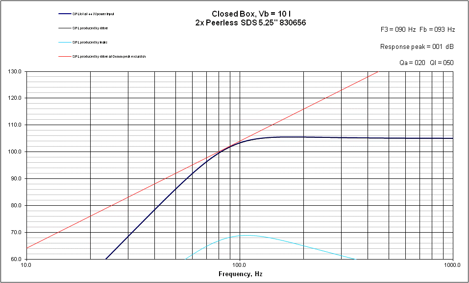

Chart 1 & 2 - SPL above about 100Hz is about 100dB/1m with 7W to each driver. Very loud. F3 is about 76Hz, F6 is about 63Hz and F10 is about 50Hz and won't change as you turn the volume knob up and down. Now I'm not sure that you are getting this so notice that xmax is not exceeded no matter what frequency you send it at these SPL's (and below). Feed it 20Hz and cone excursion is only going to be about 2.6mm albeit at only about 73dB which means that you could actually run them as a 'large' speaker if you wanted and even direct the subwoofer output to the CC as well and you are still not going to exceed the drivers' xmax at about 100dB/1m (not of course that that's actually a good idea without a real sub if you actually want to hear any of the lowest frequencies).
Now to mirror what others have also written, if your receiver has a Butterworth HP filter at 80Hz things only get better. (Unibox can also import external filters btw. I create them with Response Modeler. Give it a try.)

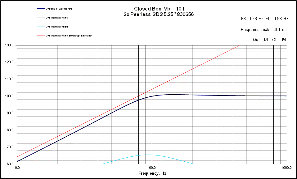

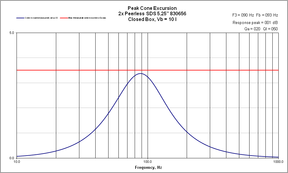

Chart 3 & 4 - So this is with the B2 80Hz filter added in still at 7W per driver and still about 100dB/1m and cone excursion below about 100Hz is very much reduced. So much so that you can now play them even louder if you want....

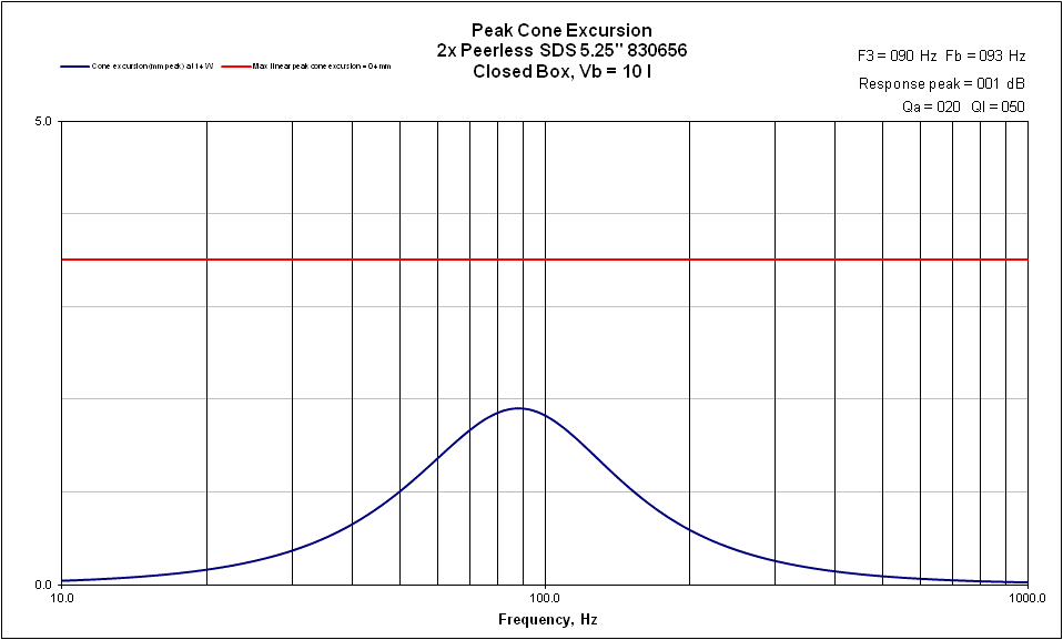

Chart 4 & 5 - Still with the B2 80Hz filter but now with 22W to each driver before excursion of each driver nears xmax. SPL this time is up to 105dB which again is more than you are probably ever going to need.
And don't forget that xmax is not the driver's limit, it's only the limit before sound quality is significantly compromised.
Moral of the story: LF extension of a driver is box and alignment dependent, independent of SPL. Xmax on the other hand is both frequency dependent (so, dependent on a HP filter for eg as well as box alignment) as well as SPL dependent.
Hope that helps.
