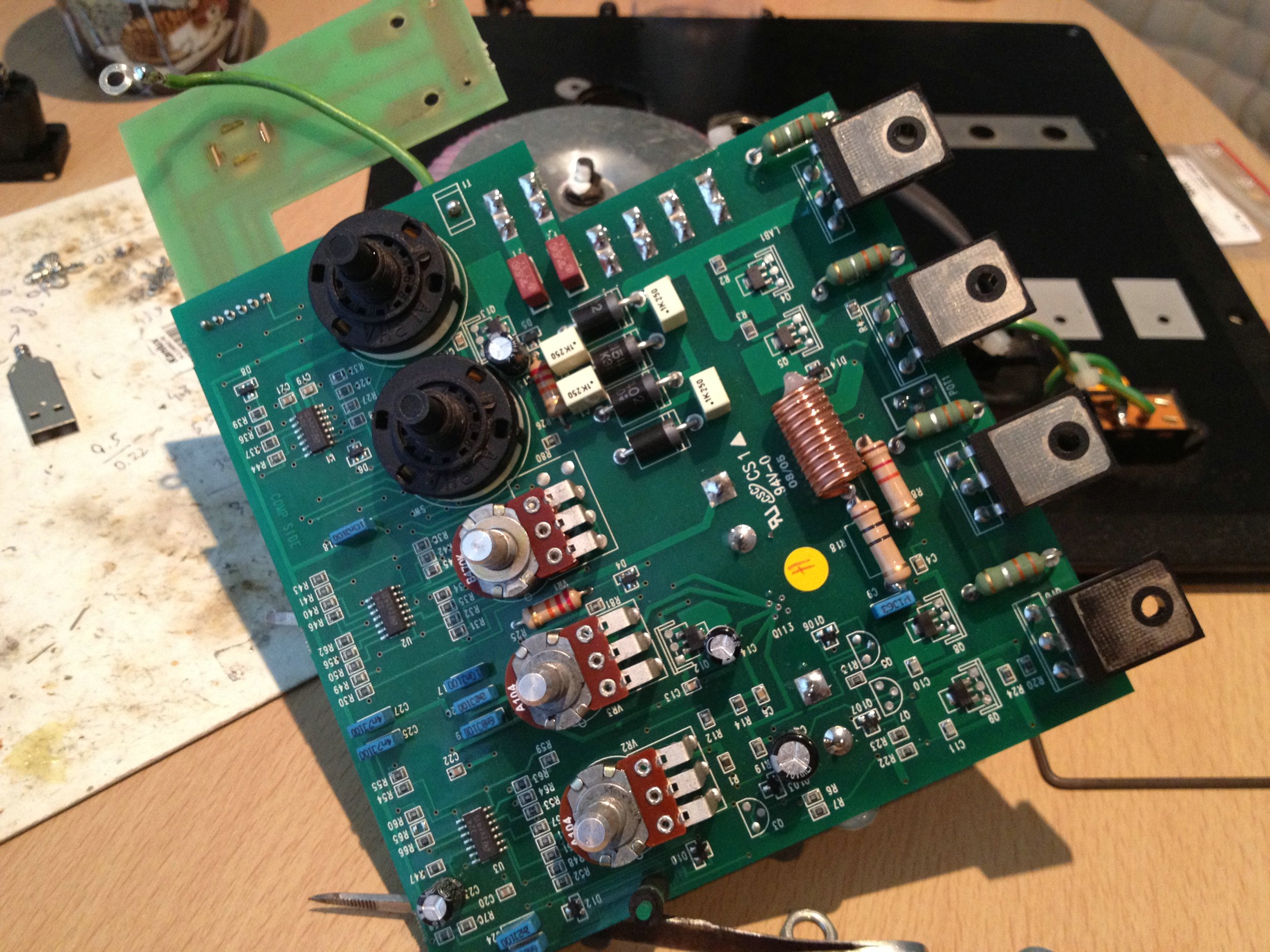

got it faulty and repaired (one of the 4 mosfets was out along with 2 fuses). Now it works fine, though some very light buzzing/ hum is still there. It's not audible, only if in some 10-20cm from the sub and could be felt with hand.
1. It's there with no RCA or Neutrik cable connected.
2. If I short the RCA socket it's still there.
3. Connecting with no Earth or switching it off on the sub does not affect on the hum.
4. Same hum was there when I connect another speaker.
5. It's about 48vdc on the PS caps. Tried to connect the scope and it was 100mv p2p offset, is that fine?
Any ideas what's wrong here? I have a second sub (Quake) and it's dead quite.
Should I try to swap the main ps caps (2x 6800uf)?

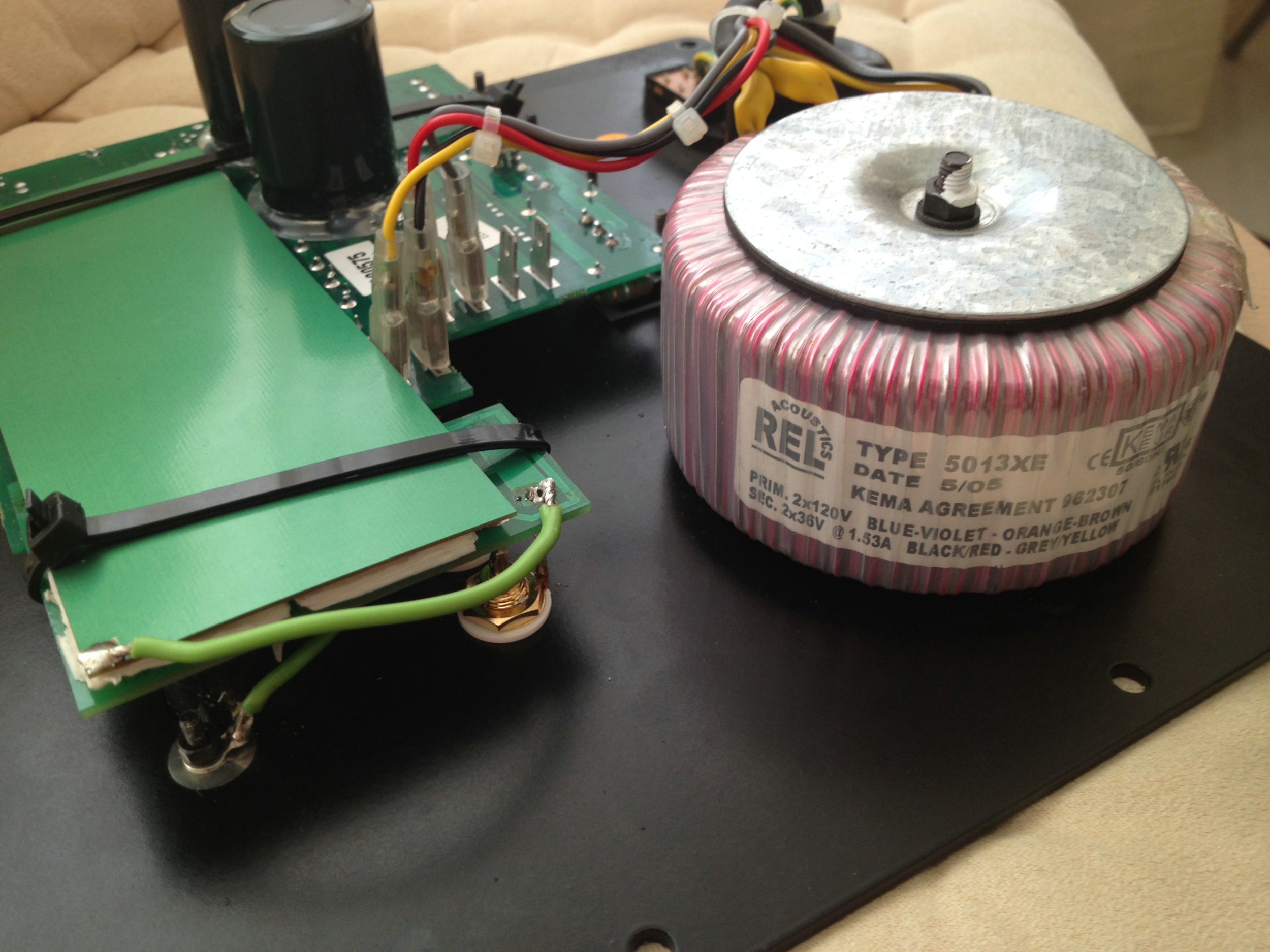

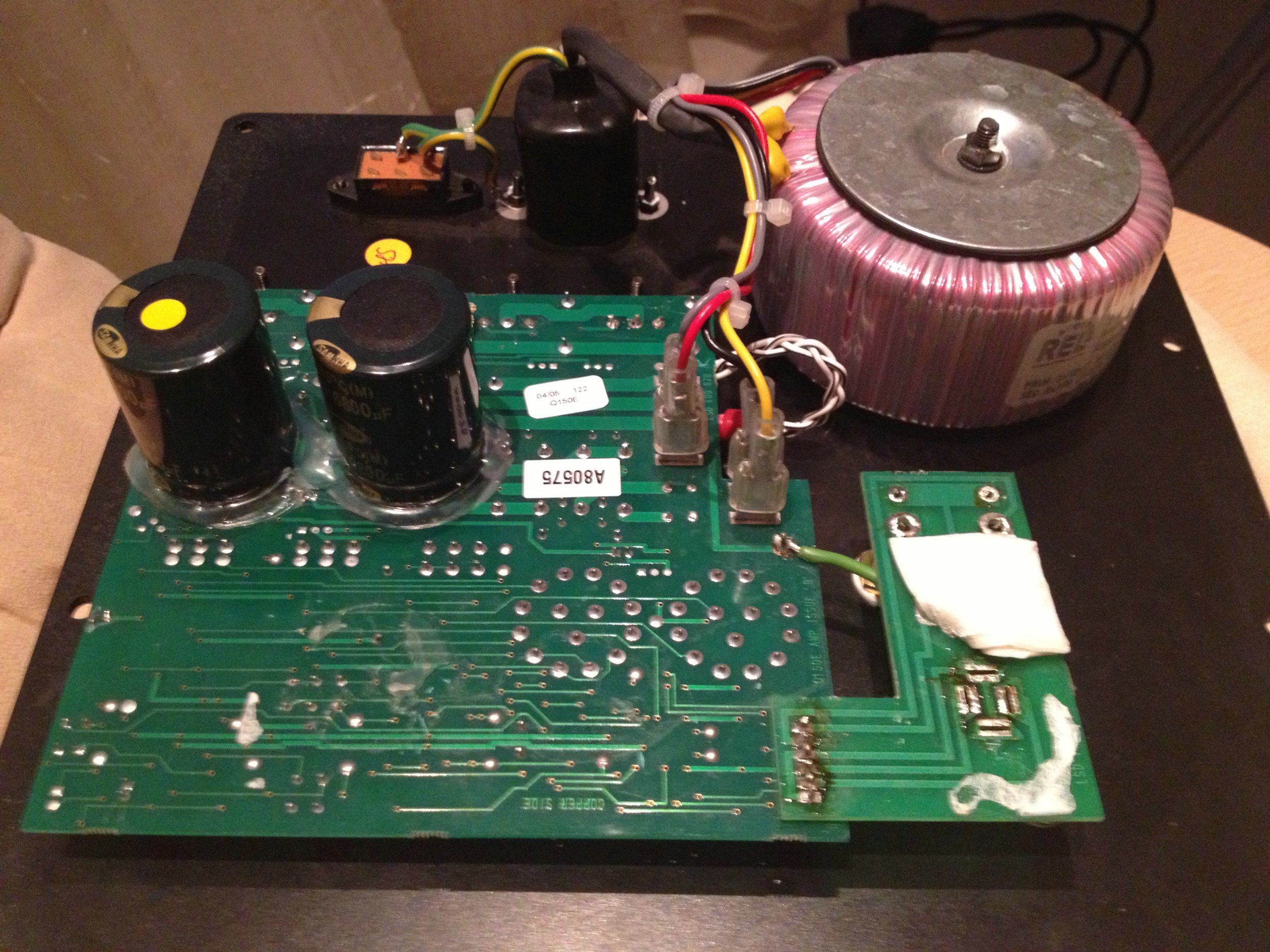

tried the following with no luck:
1. Swapped the toroid to 2x33VAC 1.2A, same hum.
2. Removed 2 x 6800uf caps and put temporary 2 Nichicons KG 470uf (the only 50v I had), same hum there...
3. Removed the amp board from the back panel to clarify if that is related to grounding or add any noise/ hum and still the hum was there. Magic 😀
looks like the problem is somewhere else...
One thing I didn't mention is that IRFP9240 I've replaced is not matched with other 3 mosfets and shows different voltage across the power resistor, however I doubt this could affect on any buzzing noise?!

as it was mentioned, it was some issue with voltage regulator there, so i've tried to find out something relevant in my Q150. It turned out that without any manual or circuit it's nearly impossible to determine smd chips. There are 3x ZVY415 that act like some pre regulation stage I suppose, but I couldn't find anything similar in the web at all. Same thing is with transistors that are most likely used for regulation - DH S48.
One thing I noticed is that if I touch the axle of frequency pot (Rolloff), it starts to hum much louder. Could the problem be here 😕

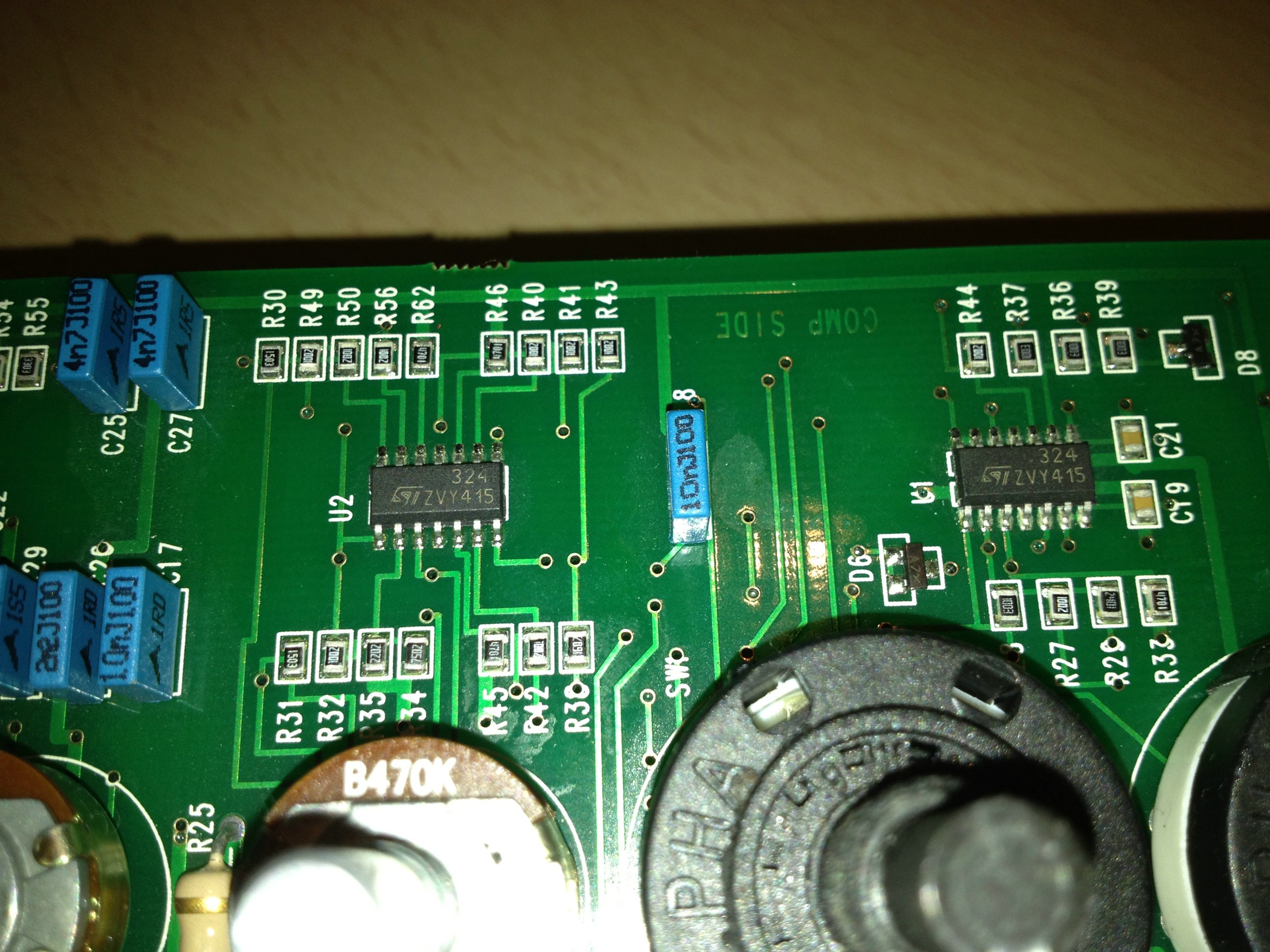

Are you sure those 14-pin chips are not LM324 Opamps?
The others I could not find either.
I was going to separate crossover and poweramp to see which one is actually fried. But without the schematic it was not obvious to me how to do it 🙁
The power FETs might get "hissy" and "poppy" if they have run hot, so I was thinking about replacing them too. But it is a slim chance and I am getting really tired of this cheap crappy amp module 🙂
Anyway my friend is willing to spend up to 200euros on the sub to get it working, so I ordered a D-class board with crossover from ebay.
I know it will mean buying a suitable transformer for more than 50euros too, but I think it will be below specified budget.
This should give about 150W rms, instead of the factory amp which gives max half of that 😀

yes, should be LMs then as you've stated.
It looks like Q12 & Q13 are voltage regs here with no filtering on emitters at all, only on their bases (great approach REL!). So another thing I've tried is I added 470uf elkos here. Unfortunately it hasn't changed much, the hum is still there and is almost the same. Perhaps replacing these voltage regs with something more decent would reduce the hum, but I'm not sure about the substitute...
I doubt that replacing all mosfets will bring any improvements here.

so I replaced Q12 & Q13 with separate LM317 regs for +-15.4VDC as by default. Bad point is that nothing has changed. Same hum, same volume. I think I ran out of ideas...
As a lastlast resort I tried to disconnect a pair at a time of the power fets.
No change.
So I started building it with all new parts.
A 2x18V 200VA transformer from Noratel (made en Sweden!) 47euros
4x6800uF 80V Samwha caps 20euros
A funny D-class amp board from china 34USD + VAT = about 35euros
Pots, rectifier, wire et.c. for about 20euros
= 122euros + some work 🙂

Anyway I have tried to add a bad photo. (I have more)
