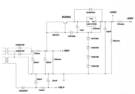

Here's a circuit I use
I use this to regulate the preamplifier section of a modified Fairchild 255a amplifier. Basically the adjust leg of an LM317 is lifted above ground via a zener string. The other zener and transistor prevent the LM317 from having to see a voltage differential in excess of its design limit. The project can be seen at <p> www.tech-diy.com/fairchild_255a.htm although I never finished writing all the html
Yep. The first regs of this type I saw were the Jung ones published in and around the POOGE articles in Audio Amateur in 1980. They were noisy then, and they're noisy now.Higo said:I think that a string of zeners can not be all quiet. Zeners are noise sources...

So, my suggestions for regulator circuits would be
- Allen Wright Superreg
- John 'Buddha' Camilles shunt reg published in Valve
- these Tubecad articles
-- Tube Voltage regs 1: http://tubecad.com/may99
-- part 2: http://tubecad.com/june99
-- part 3: http://www.tubecad.com/july99/
-- Hybrid regs: http://www.tubecad.com/march2000/
-- Inverted Tube Shuntregs: http://www.tubecad.com/january2001
-- 300B as reg: http://www.tubecad.com/articles_2001/the_300b_reg/
- Legacy amplifier and reg by Thorsten Loesch: http://www.thunderstoneaudio.nav.to/ . Scroll down to Legact amp, and beware the popups.
- JC Verdier's article in Sound Practices: http://jcverdiervalvevinyl.online.fr/2300B/tech300B.html
and of course to aid in any PSU design, a copy of the free PSUD from Duncan Amps is worth it's weight in gold.
http://www.duncanamps.com/psud2/index.html
That should keep you busy for a while.
