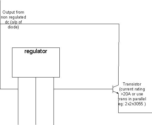

i made a power amp using opa549 chips , bridged stereo
now the chips max voltage is -+ 30V my traffo makes more , so i need to regulate it , now i need 20amp :hot: and i dont know what device(s) to use , any help will be appriciated

How about adding a capacitance multplier? You can adjust the output voltage by varying the dropper resistors feeding the base of the pass transistor. Some contributors don't like this as a solution.
try this ckt it is easy. The emitter of the transistor forms the output. You can use the same for negative supply also. hope this helps

if you want the reg to survive a short you will need to put at least 600watts of (maybe 1000w after temp derating) of output Trs in parallel and enormous heatsinks or use fold back current limiting or a slow blow fuse <= to max output current.
