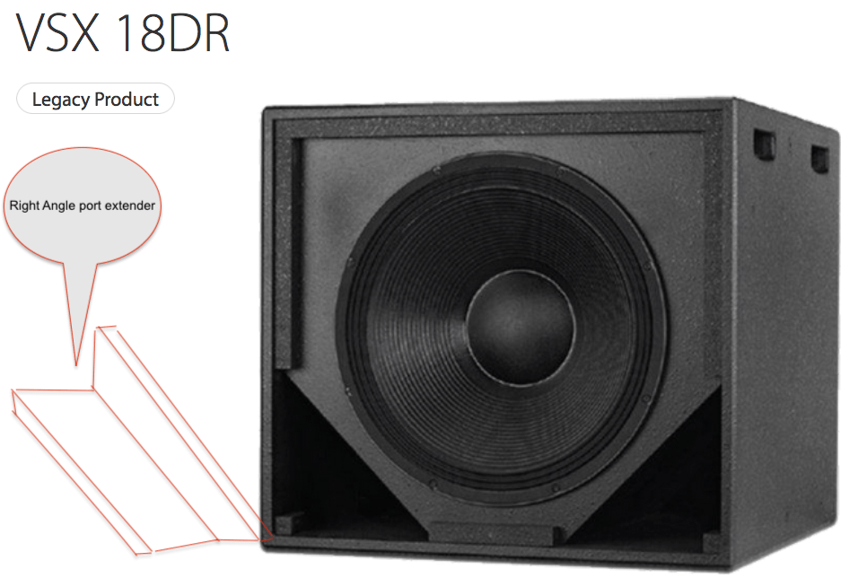

You could extend the ports with an adjustable right angle "L" bracket without reducing the port area. The bracket could be made to with the interior open end equal to the port area when extended towards the back of the cabinet, the slot port's proximity to the cabinet back will decrease tuning more than the equivalent length will indicate with most (all?) predictive software. As depicted, when the "L" bracket extender is about 2" from the back of the cabinet, port area would be about 40 square inches, same as you say the triangular port area is. From previous experiments using a similar approach, my guess is the Fb will drop to near 28Hz at that point.

The "L" bracket could be moved from even with the end of the 16" deep port to very near the back, one screw per unit should be enough to hold in place for determining tuning, then add more screws and caulk the joints when the desired Fb has been achieved.

The chart above is a 210 liter (approx net) cabinet using a 7.25 x7.25 x 9.75 deep port with a 13.25 diameter round flange on the inside, resulting in a 37 Hz Fb, the same port/flange at 12” deep (within a few inches of the cabinet back) dropped it to 28Hz Fb.
The interior port flange proximity to the cabinet back also appears to have eliminated the port resonances near 180Hz & 400Hz, had not noticed that feature before...
