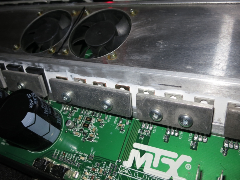

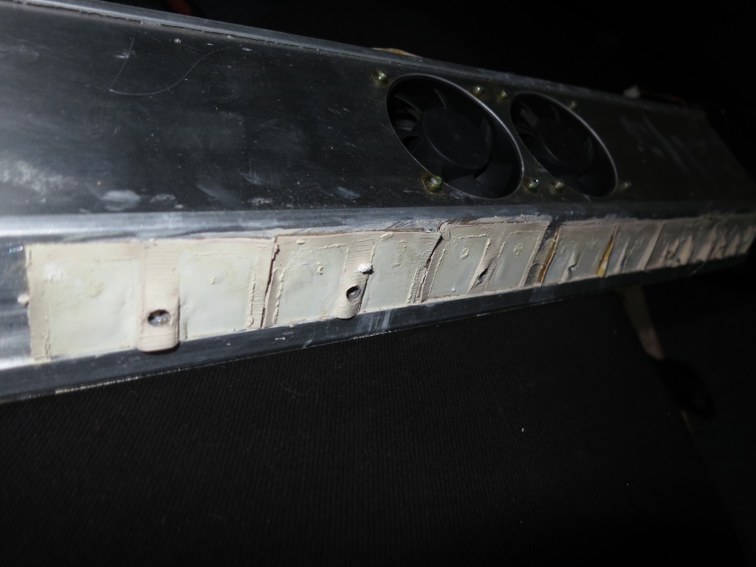

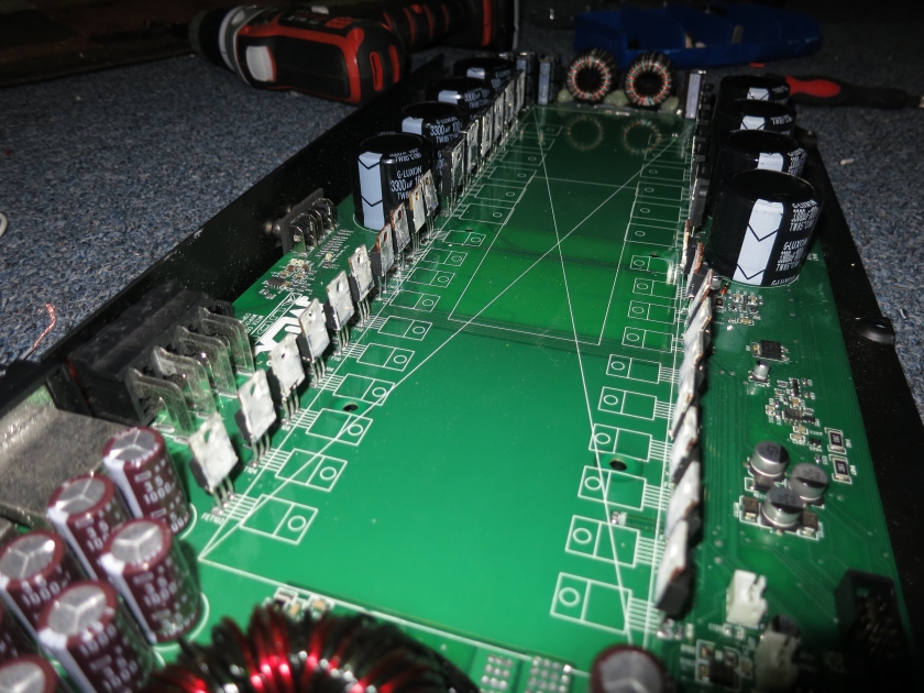

Hello everyone, I have a mtx amp that had some type of silicone pads under the transistors. They we're somewhat dried up. So i used ceramique 2 by arctic silver, Suppose to be non conductive. After getting a layer under every transistor and hooking the amp back up it blew all 4 40amp fuses on the amp. I took it out of car and opened it up and found nothing burnt so im pretty sure its shorting cause of the thin layer of this thermal grease compared to before. My question is what do i use to properly redo the grease? Silicon pads? Thick layer of Silicon grease?

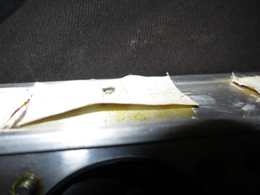

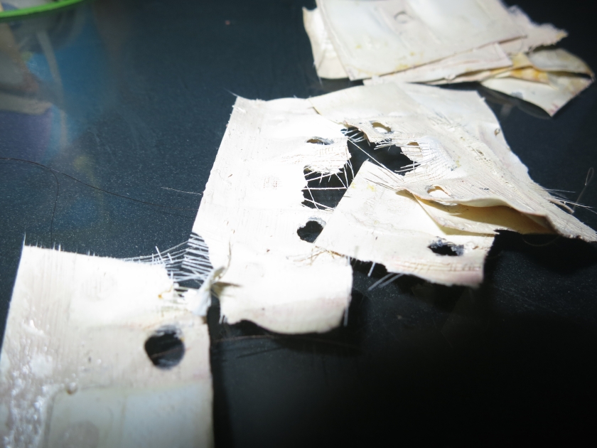

Oh and the old pads removed had like threads in them, The last photo is after i redid the pads.
Silicone pads with fiberglass threads...

stutla22, do you have a schematic of the amp?
The transistors might not be blown. (or maybe only half of them)
Post schematic and I can take a look at it and see what may have problems.

Tabs on mosfets are not like heatspreaders on CPUs. The tabs are NOT electrically isolated at all. The ceramic paste may be non-conductive but all it takes is a tiny sliver of space where all of the paste has been pushed apart and you have a direct short between tab and heatsink. If you put enough paste to prevent this, the paste is actually working as an insulator. The paste works by filling the microscopic airgaps where the metal doesn't touch the heatsink. Not by transferring all of the heat. So in this case you need something that is thermally conductive but electrically insulating. Mica is a very common option.
