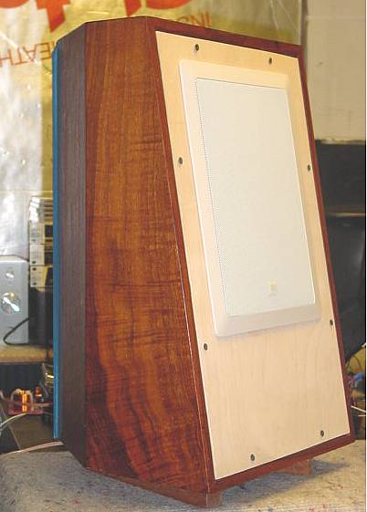

Yes, multi-way DIY.
Your idea of combining multiple woofers and tweeters in a single speaker is not good, unless you have the requisite design chops to pull it off.
The EV Baronet is a diminutive folded horn originally manufactured under license from Klipsch. It can be mounted upside-down at the ceiling or in corners in addition to as shown. I believe plans are available on the Electro-Voice website under "Vintage."
For the JBL in-walls, I blocked off the rear opening to more closely approximate the design condition of a closed stud bay.
I don't do "How's it sound," sorry....
