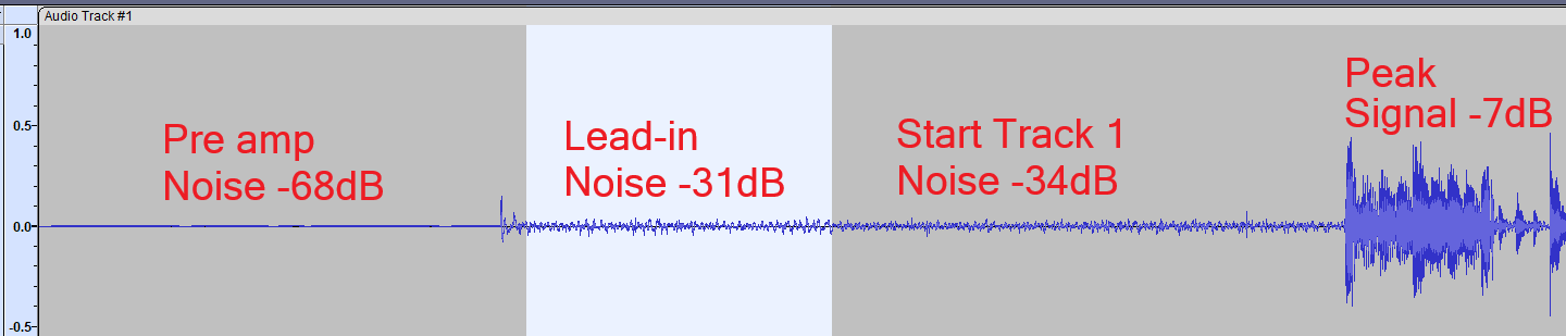

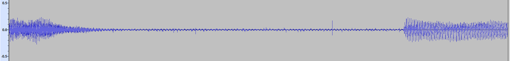

I think that helps... Though I think in my attempt to save some time, its just over complicates it... So I guess I should just re-record it then, and at the correct speed as well. I've checked the platter speed, and it's as correct as I can get it at least...
As for surface noise, this is basically what I'm getting. Is this normal for Vinyl or should it be much better than this?
You can listen to a few snippets from my G drive: https://drive.google.com/drive/folders/1Z3v2QOigsihUV7NnBKESB-o6GM1bsQhr?usp=drive_link
Any ideas on how to address it?
Reactions: 1 user

I agree with pelanj. It is also important to record in 32-bit mode and keep that until all the manipulations you would eventually do with the audio file are done.
Like denoise, declick and so on. Your screenshot looks healty to me.
Hugo
Reactions: 1 user
Thanks for the replies:)
I'm glad to know that my noise levels are within 'normal'.
