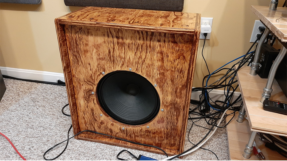

Is there a rule of thumb or some standard for speaker cabinet size? I built one cabinet (see on the pic) made out of 3/4" plywood. Inside is 12" 8ohm Celestion Creamback. The sound is very good for electric guitar playing in acoustical mode, using my hand built Marshall JCM800 clone.
I am more into lead guitar sound using effect pedals and this current speaker-cabinet combination I am using is not ideal for me. The speaker produces some kind of harsh after tones on high notes when using my distortion pedals. Those tones are not as smooth as I would like to have them. I know there are probably million factors involved in the sound I can hear.

and build a new cabinet. I have no idea how big the cabinet should be. Any suggestions?

Are we talking about a closed back or open back cabinet design?
Your present cabinet looks reasonable enough in size to me.
How do its dimensions compare with the Marshall cab shown here?

An old Celestion booklet I have suggests the following cabinet size for one 12" or two 10" speakers: 600mm x 390mm x 290mm (w x h x d).
A full width opening of height 240mm in the back panel is required for an open back design.
My current cabinet dimensions what you see on the picture are: 558x508x254mm. I left some room on top portion of the cabinet because I originally wanted to put the amplifier inside there.
Yes, Celestion Classic Lead 80 12" is the new speaker I want to use. Closed back or open back I really don't care and I don't understand the difference anyway.

Cabinet size has no relation whatsoever to whatever happens on harmonics at high frequencies, period.The speaker produces some kind of harsh after tones on high notes when using my distortion pedals. Those tones are not as smooth as I would like to have them.
Why waste (our) time asking then?Closed back or open back I really don't care and I don't understand the difference anyway.
I have no preference for open or closed cabinet, I can make either one. Guess I have to experiment. If I have to cut another piece of plywood to close the back, I will. No big deal.
