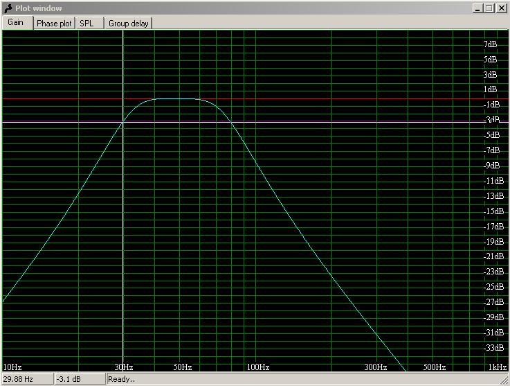

I wondered if any one could suggest a driver to use for making a subwoofer to plug into my sharp mini hifi. It has to be realitivly cheap and i will model it in WinISD. I was thinking of using an 8" driver in a vented enclouser or maybye 2 8" Dayton DVC's in isobarik in 4th order bandpass configuration. Any help apreciated

This is a pair of 8" dayton DVC subwoofers in isobarik configuartion.
What do u think of these graphs? And would this be a good idea to use this with my hifi?
Greg

How 'mini' is this mini-hifi? You're only getting to about 80Hz on the high side of the bandpass, so you're system will need solid extension down to 80Hz.
Bandpass boxes are notoriously tough to tune as well. Its highly unlikely that you will get good results if you build exactly what the modeling program tells you.

I'd avoid bandpass designs for this application,
unless you really know what you are doing.
