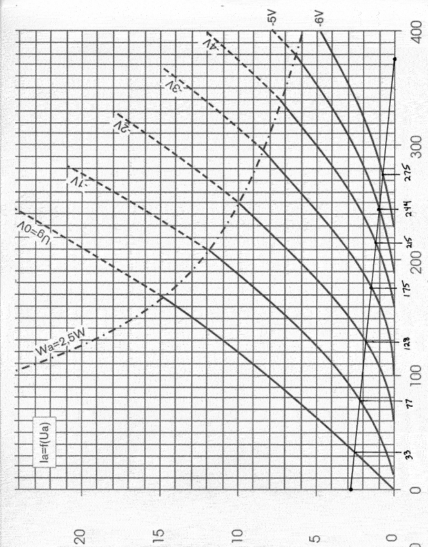

Attached schematic. Basic ST-70 iron, variant of El Cheapo, but I wanted a little additional gain, hence the input stage. Don't want gobs of feedback, just enough to give a decent damping factor. Amp will be 6dB HP filtered at about 60Hz.
So which tube is recommended for the gain stage? Tubes I have on hand are few: 6SN7, 12AT7, 6N6P, 7119. This amp is not worth the 7119, IMO, and the SN7 might be considered a waste of a good tube given the ST-70 iron, but they are easy to get. 6N6P is a nice little tube, but likes a lot of current/lower voltages. Tough to get from my 420V B+.
Any dual octal or 9 pin triodes are welcome. No AX7 or AU7 please. THX.

That's a Mullard style circuit in your drawing. It's "classic" and certainly is a reasonable option.
You can use "El Cheapo" topology, with the NFB connected to the non-inverting triode of the 'T7 splitter by "fronting" it with a common cathode 6SN7 section whose cathode resistor is unbypassed. Such a 6SN7 section is highly linear and is just fine, without loop NFB being applied. As the cap. coupling the voltage gain triode to the splitter is outside the NFB loop, a Soviet surplus PIO part could work out well.

Yes, "El Cheapo" topology requires a negative rail. You can get that without any additional "iron" by SS rectifying the B+ and voltage multiplying the 5 VAC winding of the ST70 power trafo.
The "textbook" way to obtain phase compensation uses a cap. in parallel with the NFB resistor. An o'scope is used to tweak the value of the compensating cap., for good square wave performance.
My technique for phase compensation is brute force, but it works reasonably well. Use inductive WW resistors to load the phase splitter anodes. That peaks HF gain. Short the NFB loop out above 80 KHz. by connecting a mica cap. of approx. 150 pF. between the "hot" wire of the O/P trafo and ground. This method relies on the natural HF roll off of the O/P trafo to bring things into alignment.
High gm small signal types are indicated in an amp with loop NFB. High gm provides resistance to HF error correction signal induced slew limiting. Both the 6SN7 and the 12AT7 are reasonably high gm.

The design is actually for my brother; his first foray into glow-in-the-dark bliss. I was going to run the 6n6p as the LTP, as it has lots of oomph at low voltages; the high current demands, as Kevin mentioned, steered me away from it. Although, he did buy the new Triode Electronics 'upgraded' power tranny, and I run the EL34's at around 45 mA instead of the stock 50, so there is a little leeway here.
The 5842 really is a nice performer by the datasheet; but one triode per glass, errr.... not for my brother. Me, sure. Him? nah.
Really don't think I need tons of gain at the input stage, though. I'd have to run through the numbers (again). With direct coupling, I would agree, Gordon, the input stage wants a tube capable of operating with low plate voltages. This has frustrated me, trying to pick operating points that still work with the direct coupling.
The AT7 thus far looks to be in the lead I guess. SY, that operating point has me a little confused. Read your RLD article at Bas' site, where you mentioned great linearity at 100V, 2mA. I just don't see linearity on the curves with your 133K resistor. What am I missing? Lots of 2nd harmonic, gets filtered by the PP stage, sure. Was it measurements alone that confirmed this operating point?
Honestly, if I'll be using the AT7 LTP at 3mA per triode, I have plenty of current to work with. Maybe the 6n6p would be a good option here ? 150V B+, 16mA ? Lot of current just to feed a LTP....

zigzagflux said:I would agree, Gordon, the input stage wants a tube capable of operating with low plate voltages. This has frustrated me, trying to pick operating points that still work with the direct coupling.
The 6DJ8/6922 can probably do what you want, at low plate voltages. It, in fact, can't go over 135V, period, for DC plate voltage. Pretty low plate impedance, too. Gain is a bit low (33 for the tube, lower than that for a stage with cathode feedback), but if that isn't a problem, it should work. It likes decently high plate currents... but not as much as the 6n6, IIRC...

Originally posted by SY
But at the full swing of the input stage (11V peak or 22V p-p), the 12AT7 with a 133k load run at 2mA showed less than 0.1% second.
Me little brain confused. Attached is my loadline for the AT7 near your operating points, O/P about 2V. This doesn't look linear to me ??

Morgan is referring to the even harmonic distortion generated by the output stage, not distortion from earlier stages. After all, once a harmonic is added in, it's an inextricable part of the signal. Here's a way to think about it: let's say the input signal consists of a 1kHz sine wave mixed with a 2kHz sine wave at some arbitrary ratio. I pass this through a perfect input stage. What will the output of that stage be? The mixed wave, of course. And that's what the output stage will be fed and will be expected to reproduce.
Now suppose the input stage is not perfect, it has 2nd HD, and I feed it a 1kHz sine wave. The output stage is again fed a mix of 1 and 2 kHz, and it will reproduce that, since it doesn't "know" that the 2kHz component is distortion.
Actually, for a 10 or 11 volt swing on either side of the idle point, it looks pretty good. And on the bench, the actual results with actual tubes confirms that.
