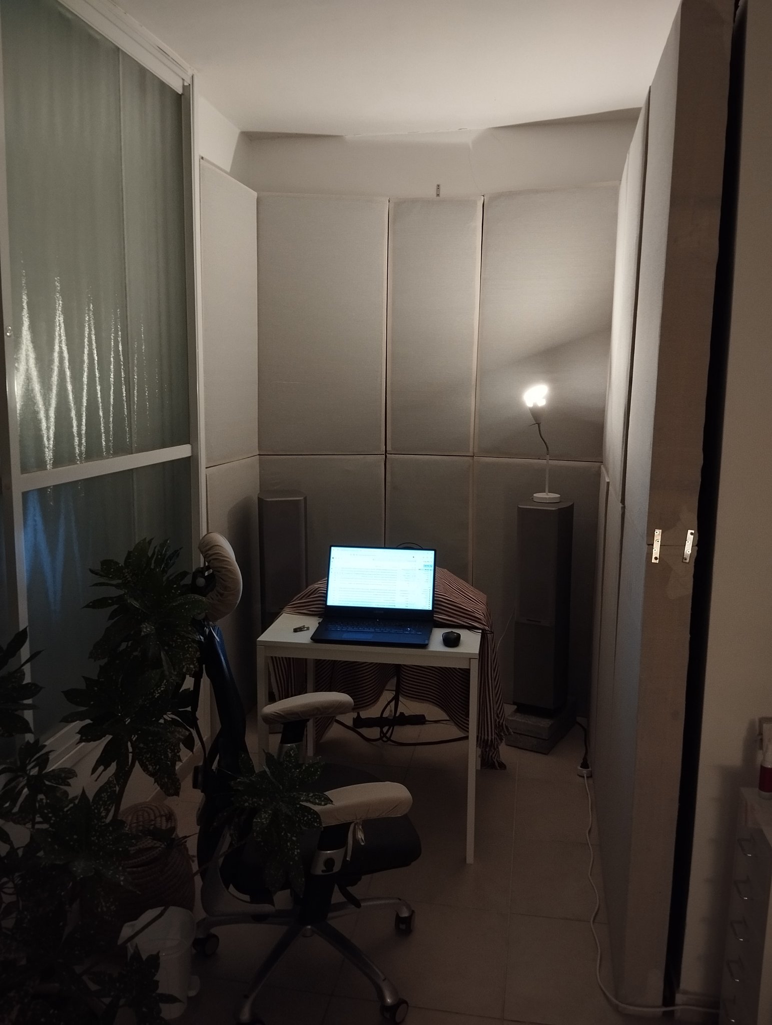

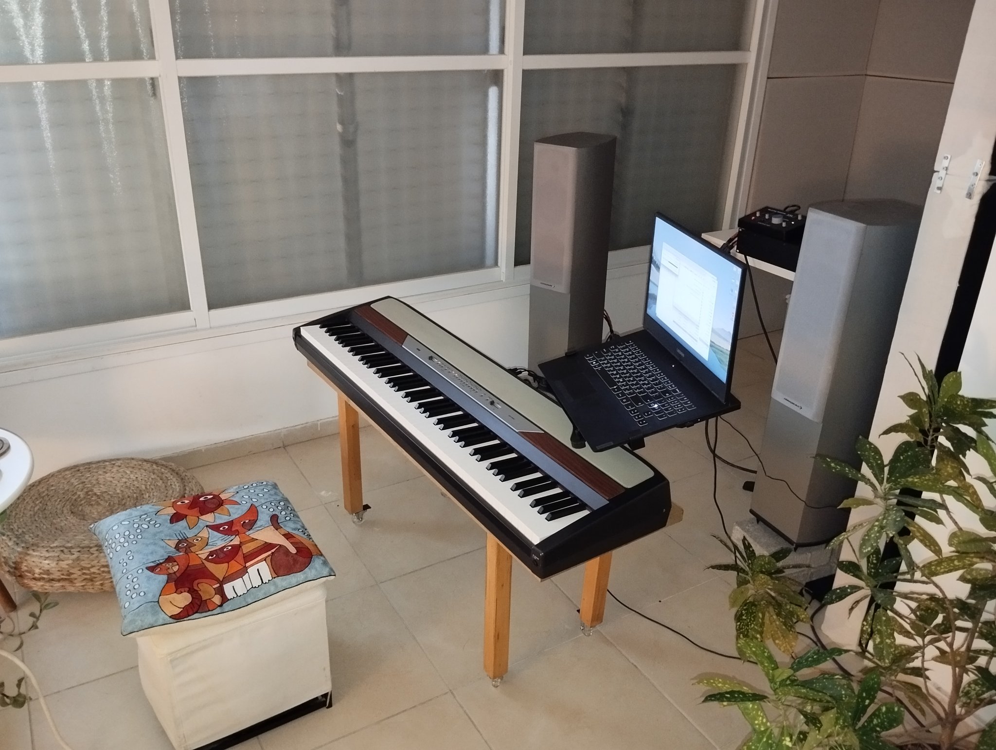

I say "professional home studio" because I have 4,200$ worth acoustic (from rockwool, see pic) which I built for 700$!
I have good mics and good audio interface and great midi keyboard (see the table on the pic, another few hundred dollars saved).
People can save a lot of money by doing stuff their own, if they're qualified, if they studied some math, physics or science. And thank god we're pretty much all qualified, espacially who graduated.
We need to cheer-up eachother to do stuff our own, and help eachother, instead of giving up and spend 5 to 10 times more, thousand of dollars, the music industy are thieves, look how much the drivers cost!

Although your listening space doesn't look like any professional studio, I do agree with you when it comes to saving money by DIY. I would not spend 2400$ for filling up (with sound) a space like that.
However, the cost ratio may be far from 10x or even 5x.
2,400$ ?!?!?!? I can build something pretty much the same for 1/5 of that price in the worst scenerio.
I build a LOT of speakers and no - you can't.
A good DSP plate amp (Hypex FA122 as minimum) costs about $400,- But you still don't have the MA-1 measurement possibility with it.
Let's go HighEnd - Purify 5.25 and Bliesma T25B. Look it up. And you need a good waveguide. And you won't be able to do a reflex port as undisturbed as in the KH120ii.
Even when you take cheaper chassis (which won't get you the low end but probably close enough) .... just calculate $10 per working hour ...
And yes - you can save a lot of money with building acoustic panels yourself.
But you will save even more when consutling a pro first and decide on an acoustic concept for the room ...
