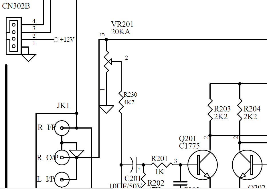

You could put the attenuation at the input of the amp rather than its output. This uses the amp as a buffer. It's what I'm doing at the moment. It's not the only way to do it. In my case this reduces the noise with the level.
Would this be as simple as putting an audio grade pot inbetween pre and power amp? Dual gang for stereo?
It could be, yes. There are other possibilities. It would help to know the nature of the two interfaces rather than using a random pot.

I have a MiniDSP 8x8 (unknown output impedance and not even sure if it is relevant?) going to two Parasound Zamps (33k ohm input). One of which needs to be attenuated for compression driver/horns but I am not quite sure how much, yet. How would a pot be implemented?
Correct me if I'm missing the point, but in this case gain can be controlled through software. In order to reduce hiss, the attenuation amount doesn't need to be variable, or even precise.an audio grade pot
I'm OK with discussing alternatives. The issue I sometimes find with pots is channel balance.
