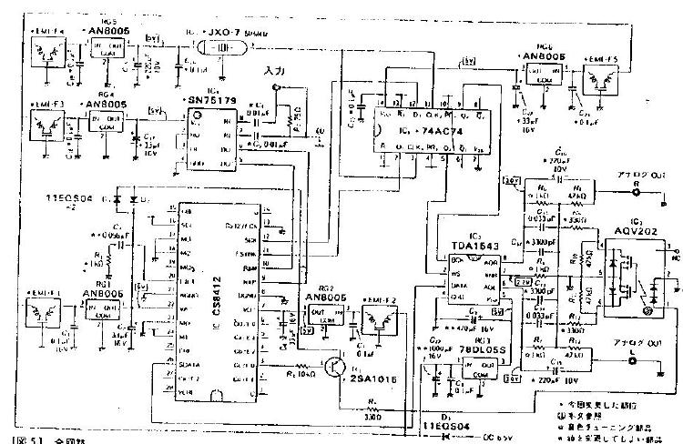

Does anyone have a suggestion for a good way to reclock an I2S signal coming into a DAC? I am thinking about using the circuit Yeo uses for the Monica DAC (http://www.diyparadise.com/asynchreclocker.html) but am open for alternatives.

Hi Asynchronous reclocking seems to work for the TDA1541 and the AD1865 but not for the TDA1543 which Kusunoki used ironically.
I have no experience with the TDA1545 though. It all depends on the clock you use.....😎

I used Elso's ASR with TDA1543, 1545A and 1541A and must say I will use it again ;-)
Yeo's schematic is almost the same, it only uses a more compact chip with more F/F.

& tried reclcoking using SN74ABT574.In Onkyo cd player with YM3433 and AD1860 result was beautiful,with TDA1543 doesn't work (synchronous mode).Instead & tried ADUM1401 for TDA1543 -result excellent maybe better than reclocking.& use quite good PIO decoupling capacitor and isolation with ADUM did a result like to change cheap decoupling capacitor with PIO.
dariusku said:& tried reclcoking using SN74ABT574.In Onkyo cd player with YM3433 and AD1860 result was beautiful,with TDA1543 doesn't work (synchronous mode).Instead & tried ADUM1401 for TDA1543 -result excellent maybe better than reclocking.& use quite good PIO decoupling capacitor and isolation with ADUM did a result like to change cheap decoupling capacitor with PIO.
What is the clock frequency of that CD player?

Is this better than Kusunoki http://www.diyaudio.com/forums/atta...oversampling-dac-complementing-cd-pro-ks2.jpg which does not reclock data signal
what Is XO frequency - I can not see It
