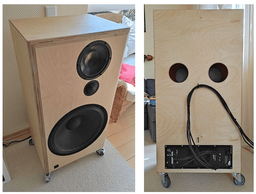

Also T34A with a ~2khz LR24 highpass and no waveguide, paired with 18Sound 8NMB420 and Faital 18FH500 driven by Hypex FA503.
Got louder than you can stand in my living room without ear protection, the tweeter still playing crystal clear and unstressed. Assume it is capable to reproduce transient peaks of >= 115dB without significant compression...

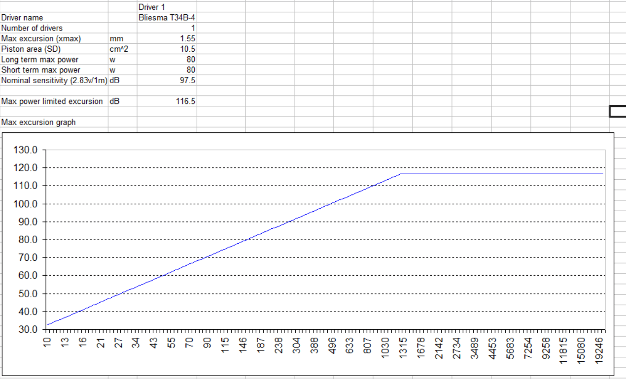

Dave's dodgy spreadsheet....
This is for the raw driver (no WG) radiating into full space. Your excursion knee is at 1,252Hz (i.e. below that the tweeter is excursion limited and above is thermally limited assuming a maximum sustained 80w input level)
This ignores distortion and other factors. This is purely a max mechanical or thermal output graph.
